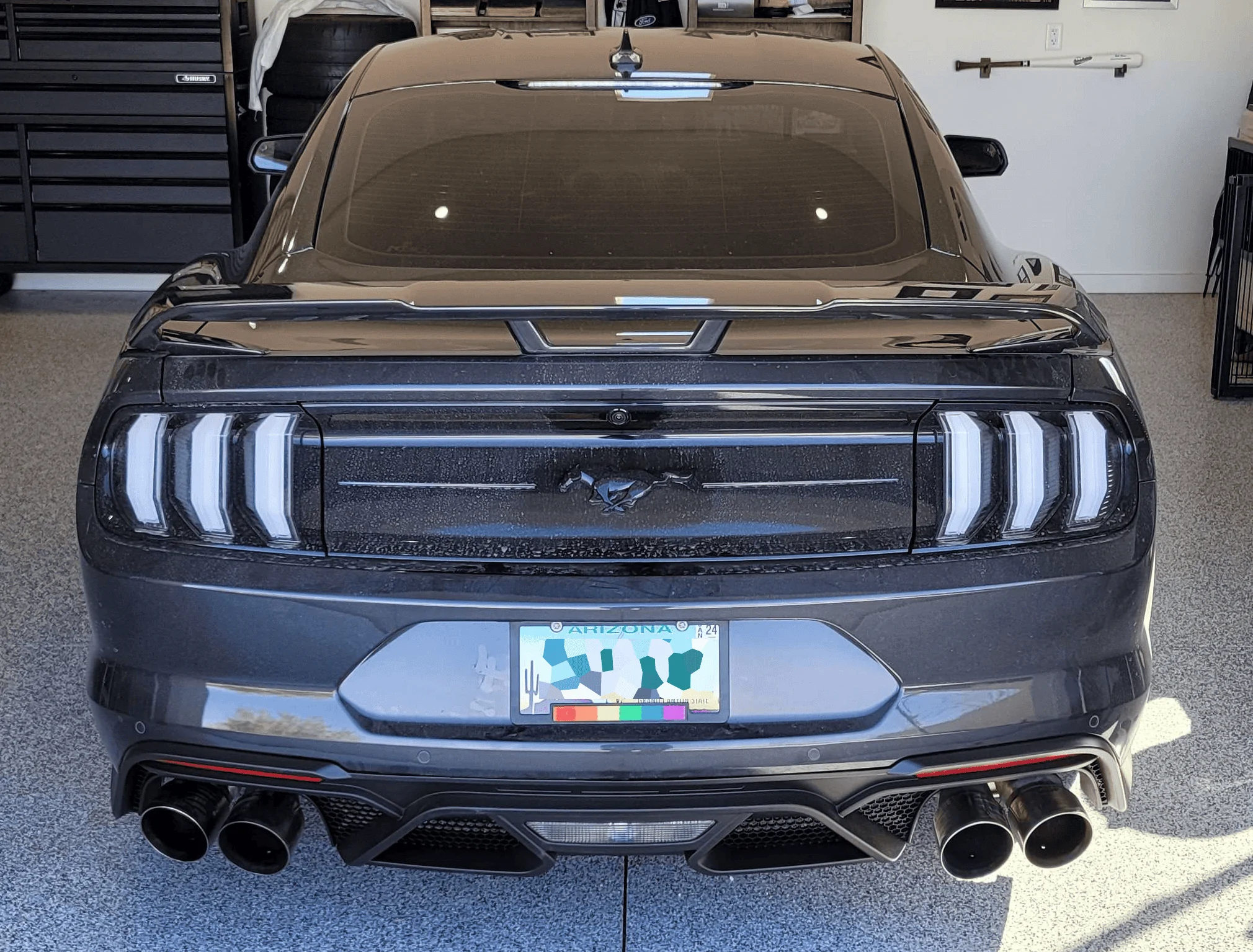

as the title says, i took the catback system of a GT500, cut off the mufflers, and put them on my EcoBoost.
it's a lot more difficult than you would think, but it works fairly well
(yes, i know i need to clean it)
i bought the diffuser, and the mufflers are warranty parts from work that Ford deemed scrap
about how it sounds, it's not louder, but it has a deeper tone to it, and now there's pops on every exhaust mode except quiet
my dad helped me a lot installing everything, i used 2 2.5" to 2.75" inner adapters with 2 2.25" clamps and 2 2.75" clamps

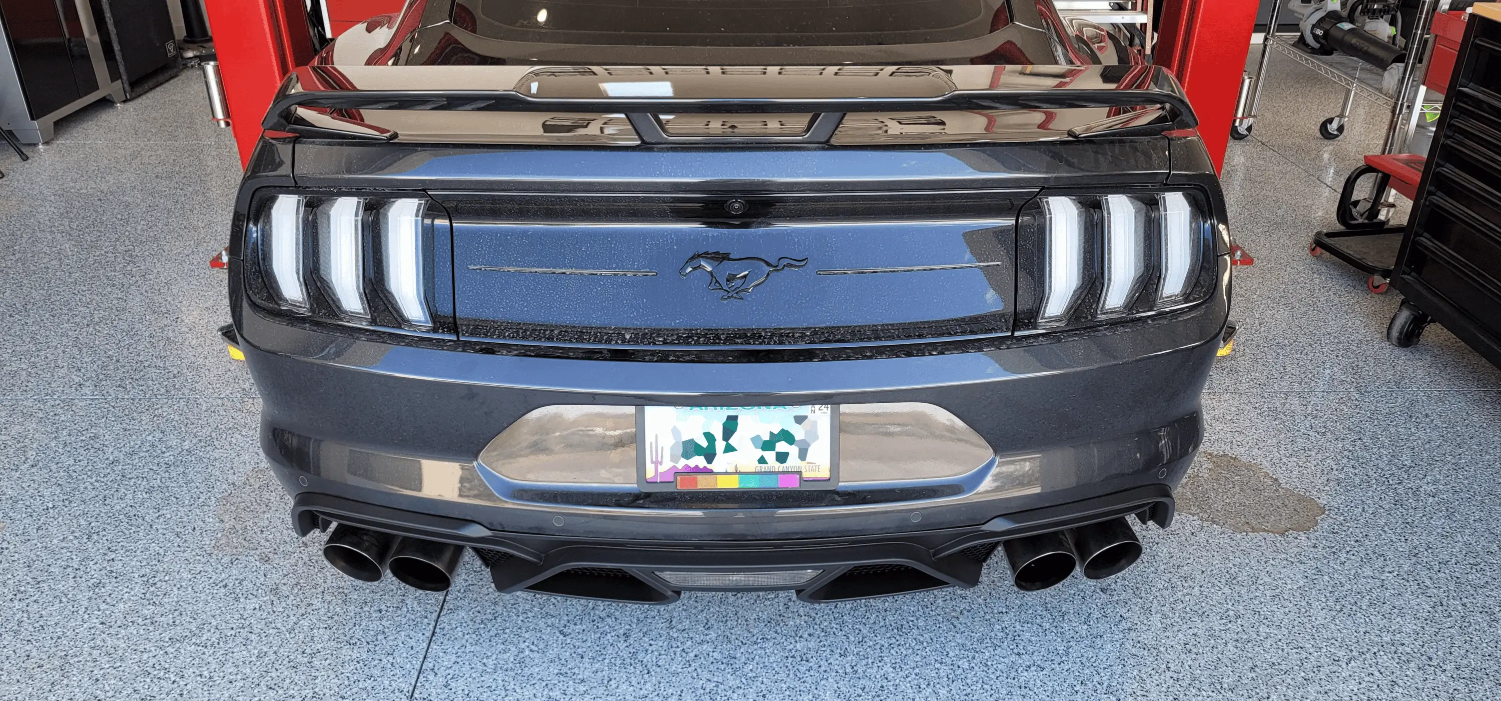

yeah, the fitment still needs work, and a lot of it
it was such a hassle to get the system in place that my dad and i called it good enough for now, though
it's almost as if the vehicle wasn't designed to have this system

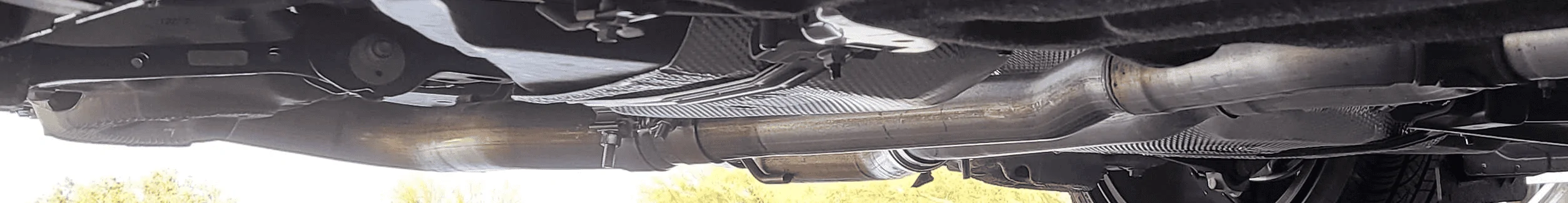

If it helps, I shortened my active exhaust with H pipe by about 16mm total when I fitted the H after my standard system had started to rub.
I made the ‘perfect’ cut, then shortened the cut and the front of the H pipe by about 8mm each.
Right side loom off the standard system had just started to rub :
Before (standard system / standard fitment on the right) v after (modified with H) :
Loom clearance after the mod :

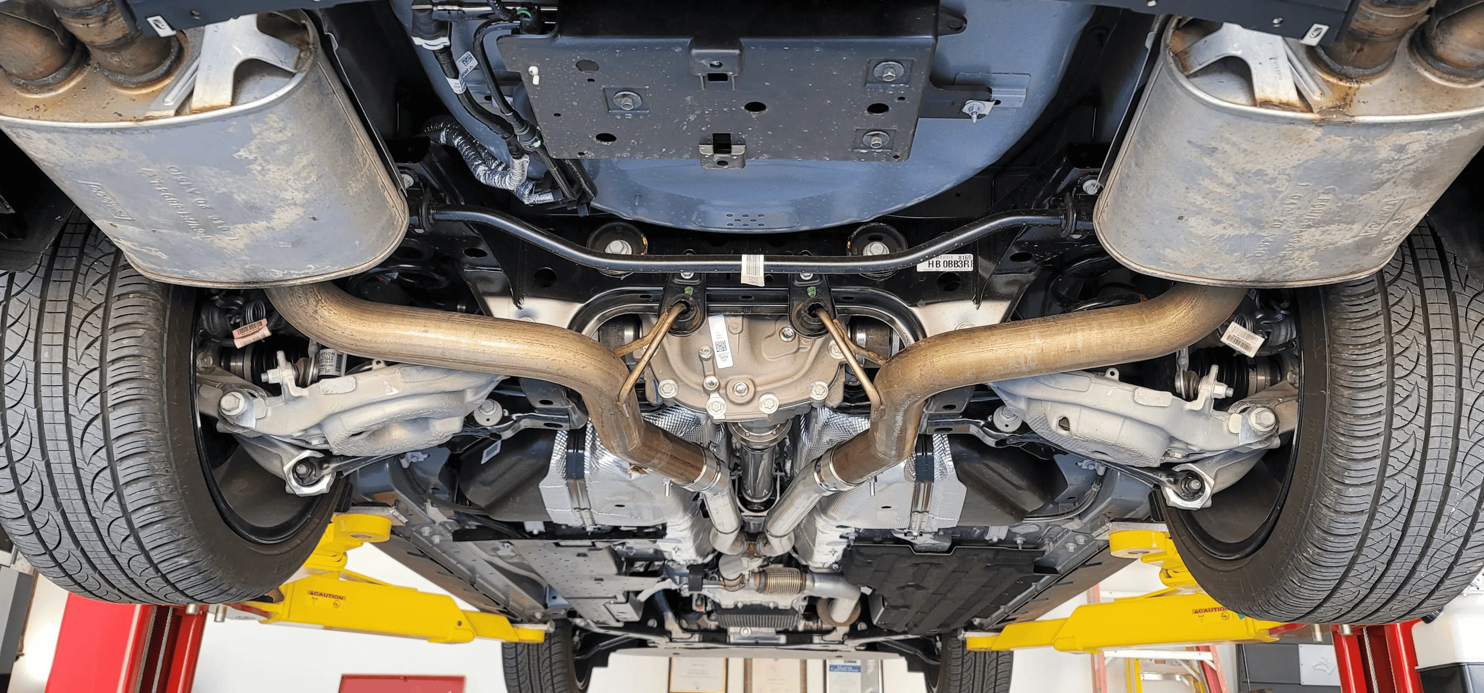

i got the car in the air again this morning and improved the fitment a lot, also another look at underneath

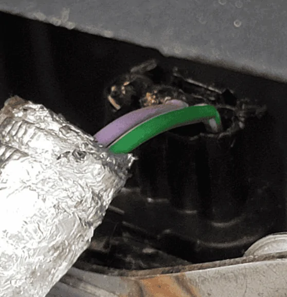

As you have active exhaust just be careful - your tailpipe’s look to protrude a bit more than the stock fitment which will increase the risk of damaging the loom
too late 😢

Cool idea, looks good. If you have some clear silicone and gorilla tape you can fix up that harness. The silicone will stop the body from rubbing through the wires. The gorilla tape is another layer of protection
TeeLew
Apr 27, 2020
3,396
2,613
So Cal
Tim
Honda Odyssey, Toyota Tacoma, 89 GT project, 2020 Magnetic EB HPP w/ 6M
JFC, could we work some bailing wire in the mix somewhere just to make it as Hill-Billie as possible? To fix it properly would mean cutting and reterminating the connector, but it's nearly impossible to find those connectors. They aren't DTM's or Weatherpak's.
There's a short jumper harness from the car main harness to the mufflers. You need to go buy a replacement. I think they're about $50.
