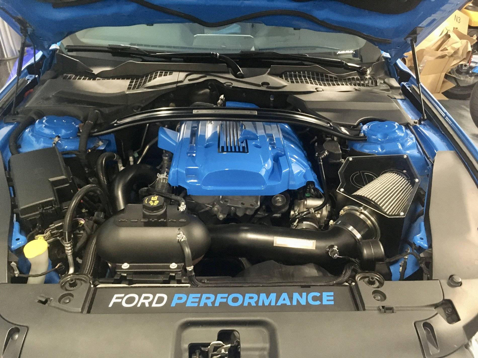

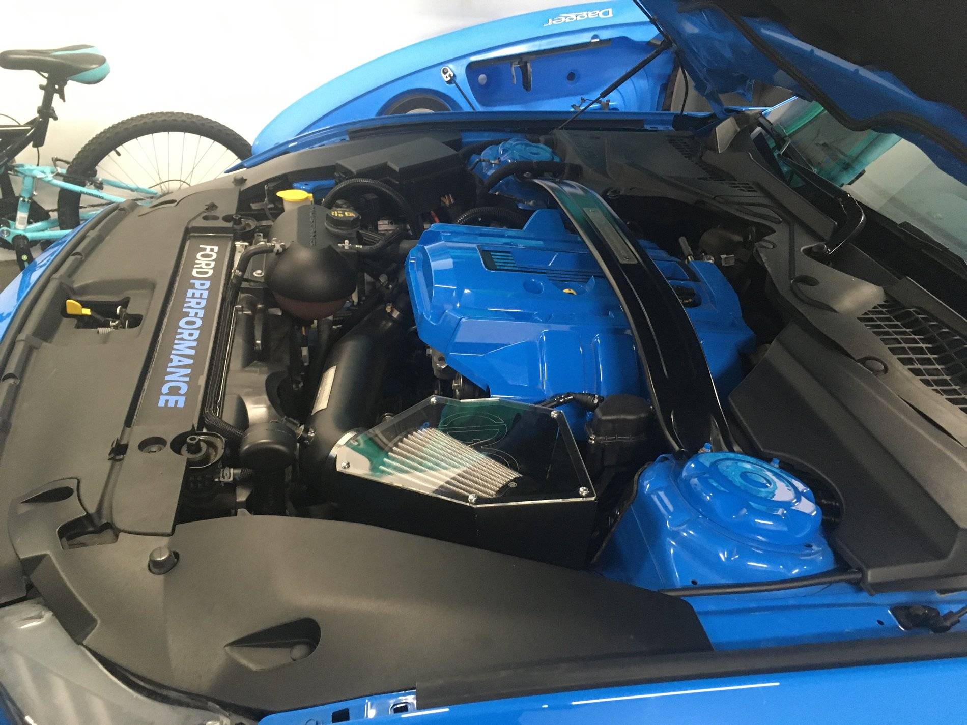

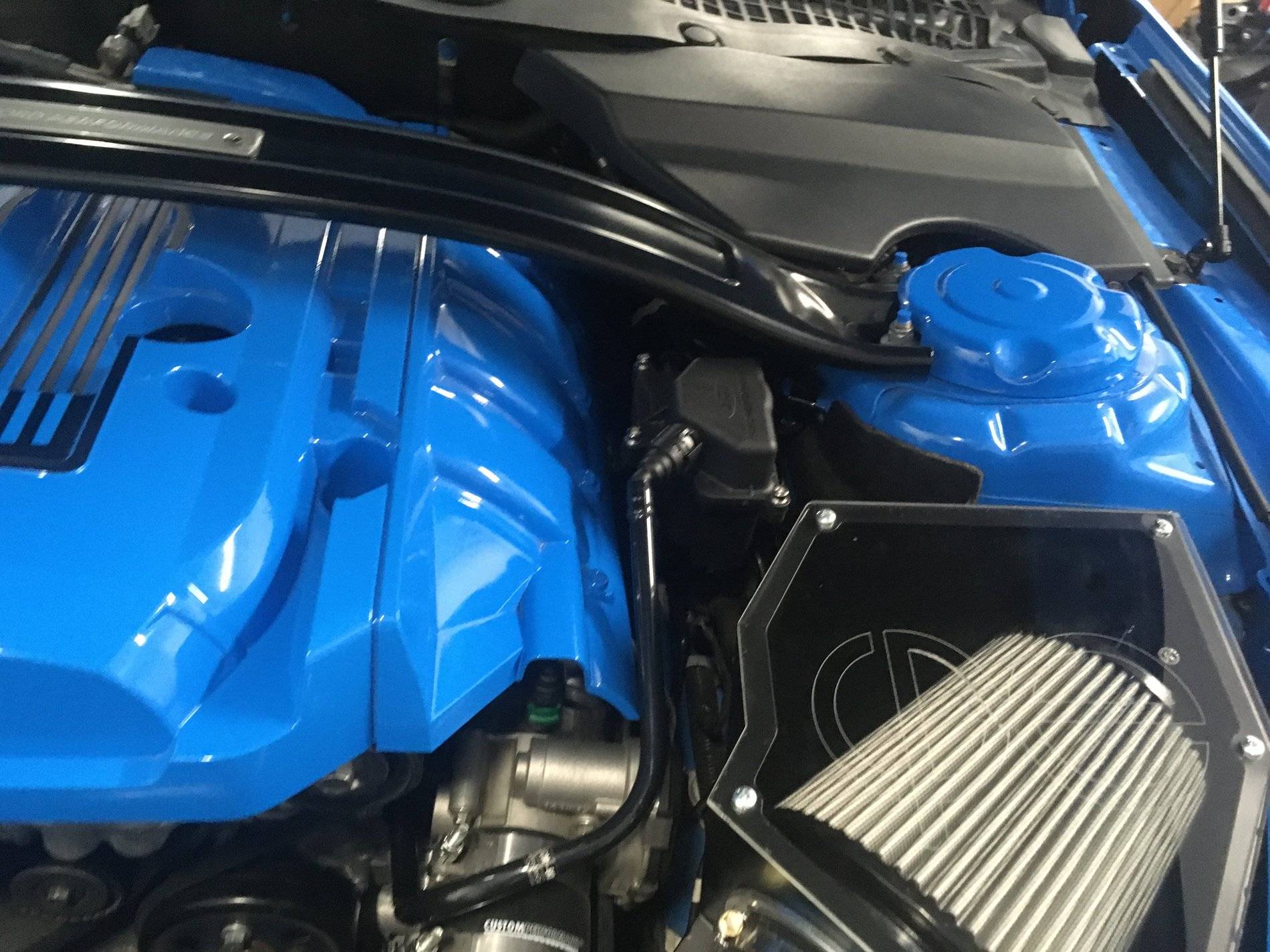

Thanks. Its expensive, but it was fun. I will list the main parts up.
1. ford painted my engine cover, $100 bucks local ford shop. Paid 15 bucks for matte black vinyls from place online, floats me right now.
2. CPE hot + cold charge pipes, + HKS bov. (don't remember, got a deal though)
3. CPE intake 300
4. Ford performance catch can. 200
5. Strut tower covers, 15 dollars.
6. Strut bar + the firewall brace, CJPP got that for 140 bucks shipped.
7. Got the fender extension things for 90sh bucks from American muscle, it was listed like 129, but I called said I wanted it, but didn't want the price. (downfall, in like 3-4 places it does make contact w hood and chips paint some) I got adhesive backed felt, and just put little squares on the hood so when it closes, doesn't rub paint to plastic.
8. Brake cylinder cover, like 45 bucks either CJPP or American muscle, cant remember.
9. Coolant cover, also like 45 bucks from CJPP or American muscle. cant remember.
I am big into my local car scene, and they have a lot of little shows/hangouts groups etc, so I just went all out and prettied up the bay. Was fun for winter.
