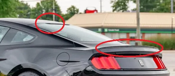

Answers:
1) The 2016 base has the same small lip spoiler as the Tech Pack, but has no antenna, like the Track Pack. That's how tell from the exterior.

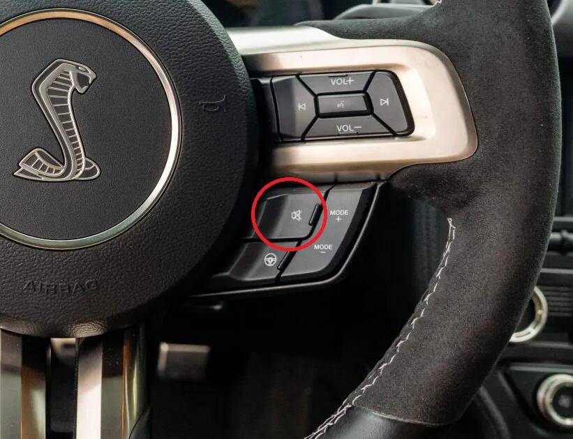

2) The 2016 base is identical to the Track Pack from the inside, except, because it does not have Magneride, the shock adjustment button on the steering wheel is replaced with a mute button.

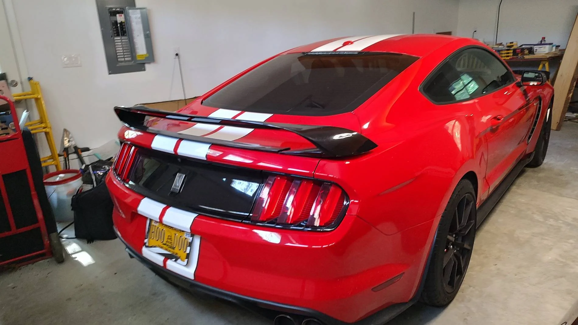

I took a pic of my spoiler, just because...
I assume I can get the trans and diff coolers and add them?
Thanks,
David

If you haven't hit limp mode and aren't going to track it, don't bother with the coolers. If you are going to track it there are several ways to add coolers. The trans is most important. It overheats and triggers limp mode. There are no temp sensors on the diff, so change the fluid often and you're good to go. Your rear spoiler is an aftermarket R Model copy.
