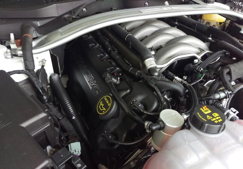

I would like to see one installed in that engine bay. I like the bare bones not plastic cover look on the car, but I do think all that rubber hose would look much better with some braided hose and Air Force Navy (AN) fittings!
I don't need an engine cover on the GT350, but it would be nice to get some cleaner cable management. Many of these photos look a bit like a rat's nest under there. Not a big deal of course.

BC RACECAR !!! [emoji12]
Jk but I prefer the tougher look of the GT350 engine bay. I had the cover off my 13 and took it off my 15 too. I have the black coil covers on order and a black billet boomba oil cap on the way.
This was my previous setup but sold the Ford Racing coil covers and Hawks raw billet oil cap. (Not picture)

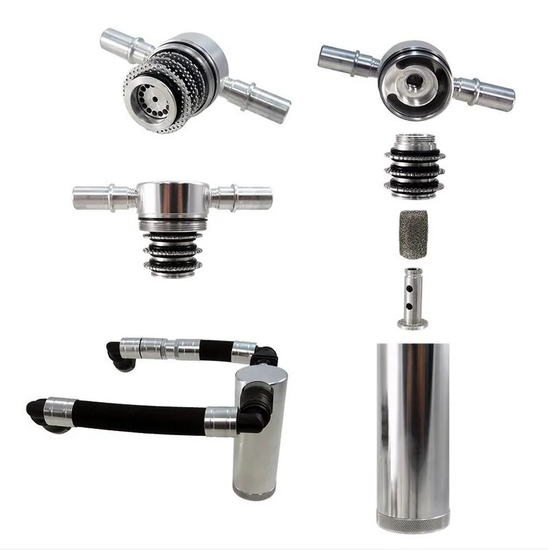

What are inside of these things (I mean the Bob's versions specifically)? I haven't seen an internal picture. Is there some sort of internal baffling, some convoluted path for the air??
Here is the UPR (image from Lethal's website) - couldn't find something similar for the Bob's version:

Wow! that looks pretty elaborate looking.
We have a "Oil Catch Can" on our Jeep SRT8 that really works great! Doesn't seem that elaborate. Though the amount of oil it catches, before entering the intake, is amazing... or disturbing depending on how you look at it. I empty a few ounces every few weeks and in between oil changes. This mod is recommended on the 6.1 & 6.4 Hemi's. Though it should be noted... it does NOT pass California SMOG inspection. I would assume the same for others?
