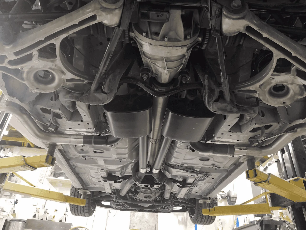

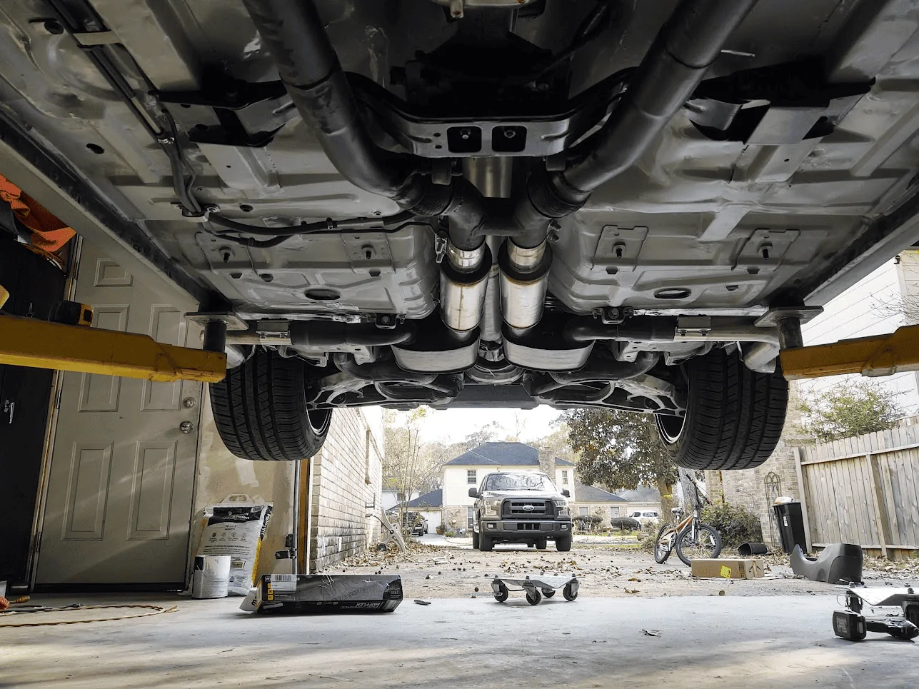

while you are definitely on to something I think this has more to do with exhaust layout/tuning than anything. when i put sidepipes on my cobra it sounded a lot like a coyote. very raspy, tinny, and aggressive. why? because the mufflers were very close to the exits.
i added a couple magnaflows before my superturbos and got ALL my deep mellow back. that thing sounds like a proper 4.6 now. I also made more power afterwards.
before:
AFter:
I suspect this is the primary purpose of ford's suitcase resonator and their large mufflers which is why a lot of aftermarket units sound very tinny. i, too, hate most aftermarket coyote exhausts and i think it has a lot to do with big straight pipes leading to mufflers right at the end.
there's tons of great sounding coyotes these days but most of them have factory exhausts :D
