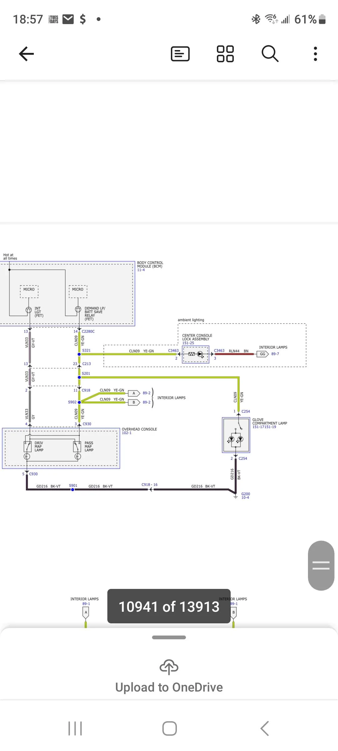

To maybe help put your mind at rest you can see in the above wiring diagram the console light is on the same circuit as the glove box and interior lights. If your glove box and interior lights are going off you can be assured the console light is as well.
You can probably prove it by leaving the phone recording in the console, shut the doors and wait until all the lights time out. It might take as long as 30 minutes.
Still, you're right, even if it stays on the current draw is pretty low.

Here's the wiring diagram for the circuit.
In lo
In looking g at the circuit looks like it feeds the interior lights.so if I disconnect it may affect interior lights which looks like it gets power thru the console connection
Si I won't cut or disconnect anything and just live with it.i mean how much power can a tiny led use.ill eventually have Ford fix it.in the meantime I'll just charge battery when it gets down to 13.5v and bring it back up to 14.thanks for all the info..bob
