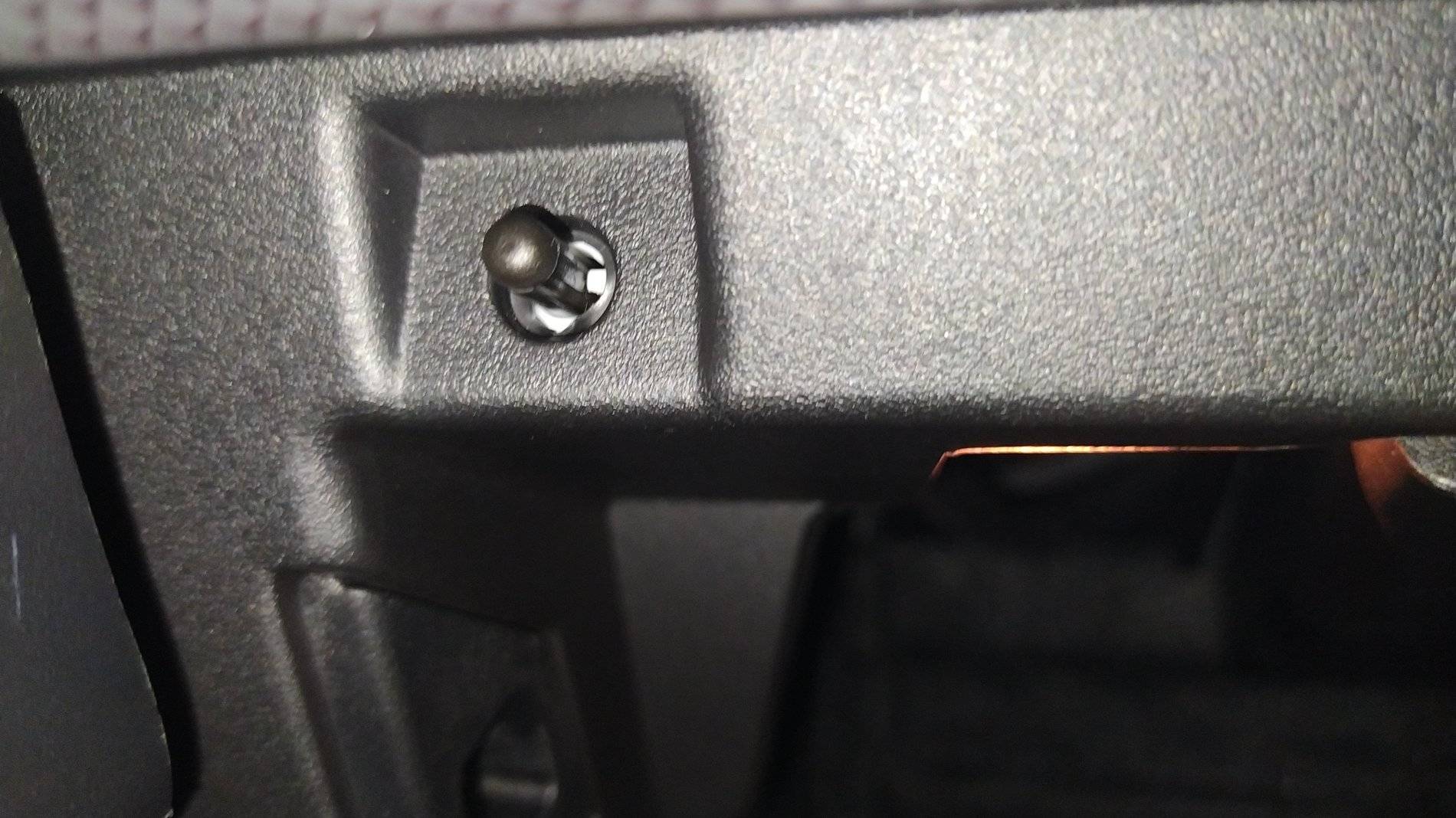

If the glovebox lid closes fine, and doesn't look obviously out of alignment, it's probably correctly installed, and correctly operating. It's that damn switch. So did you open the glovebox, and reached behind the light housing, and it feels well mounted? If yes, try this: Can you unscrew the black part that touches the glovebox lid??? I'm thinking maybe they have adjustment, like the clutch switch has. If not, what I'd do is just find something you can install over the black 'stud', to create a millimeter or two more distance, and your issue would be solved. Let me see if I can think of something that would look factory, but no way I'd take it to a dealer just for that, since there's really nothing wrong with it. It's just that the switch is crap; it barely engages, so any little difference from assembly, like yours, was enough to throw it out of reach. Let me know if you thought of something. A dealer would end up doing exactly what we're thinking of doing, after replacing everything... and probably scratching/scuffing/etc your car in the process. Just not worth it, brother. Good luck.
EDIT: Do you have a carburetor/vacuum cap? That might work. In fact, I'm going to look for something too, since I don't like mine is barely engaging the switch. I want the switch pushed a lot more than now. One of those caps would be perfect. I have some at home, but will be back until Friday.

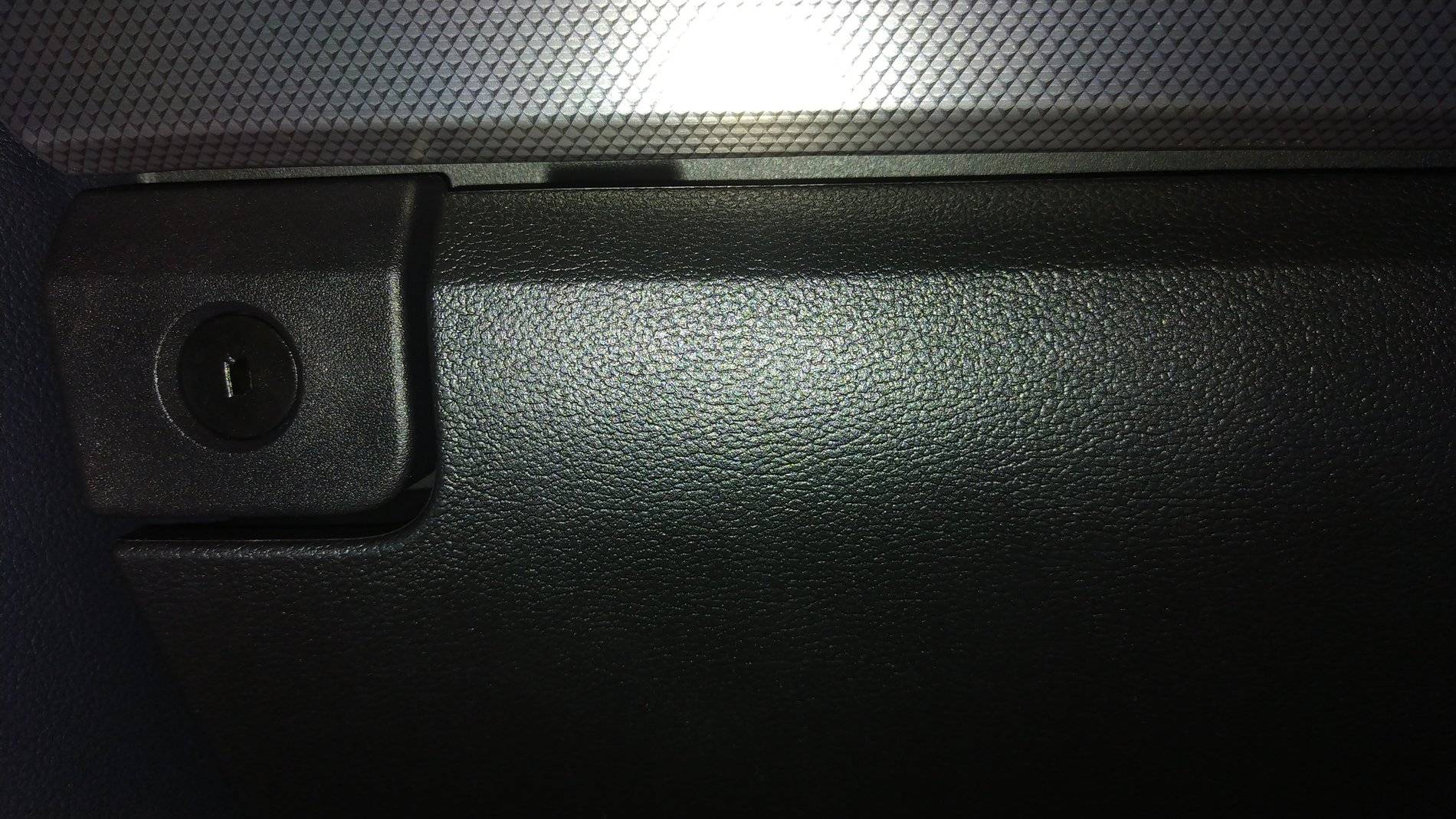

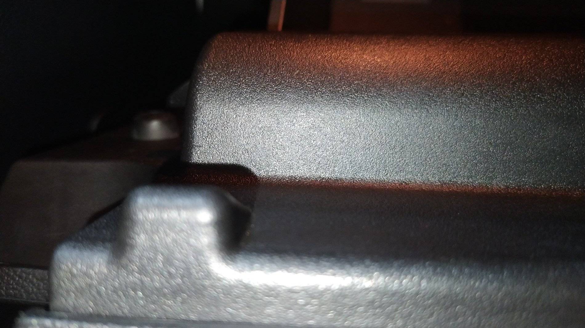

I was thinking the same. Look at the pictures I attached, do you think it looks okay when closed. I think there is some misalignment for sure but nothing that looks odd. What black part did you want me to see if I can unscrew? Is it where the stud is?

Try one of those self adessive rubber pads, the type that sticks under a laptop to stop it sliding about .Stick it on the inside of the glovebox so it pushes the switch in a little further when closed !

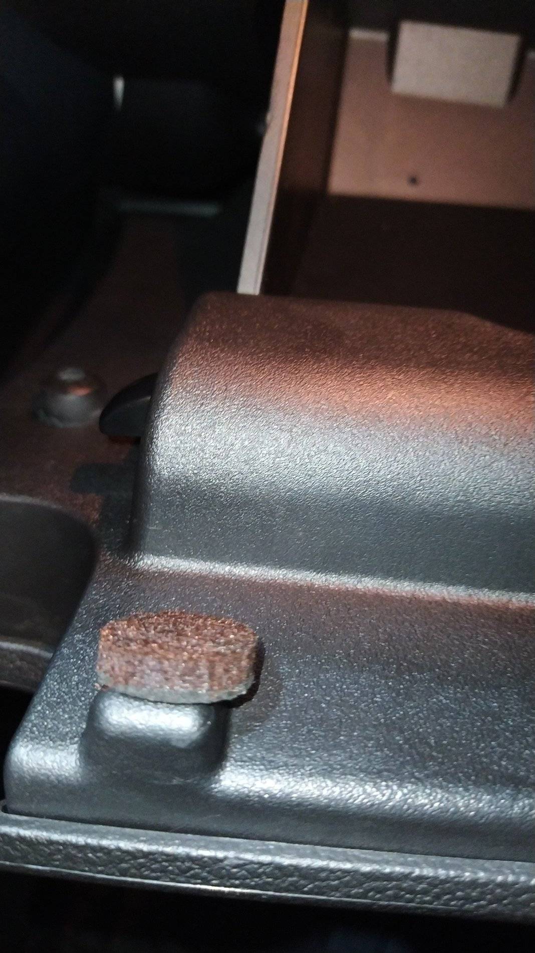

I had a felt pad that I placed on the black stud and now the light is turning off. When covid is over I will take it to a dealer to see if they have a better solution.
The black stud on the switch that you have to depress to turn the light off. Sometimes it can be adjusted. Maybe not, but worth a try :). If not, what you did achieves the same purpose, although in a less elegant manner. Ha ha.

Yeah definitely not eligant. Its a brand new car should need felt pads. I will have to take it to the dealer eventually. I don't want them to scratch things up though.

If a felt pad would do it, so would something else. I'd have been tempted to work on the switch's plunger. Add a little epoxy or... Drill a tiny hole in it and twist in a tiny brass screw. Adjustable and shiny, and like many useful mods, very satisfying even though ordinarily invisible.

100% agree. My first thought was one of those clear rubber dots that are on the inside of cabinet doors stuck on the end of the switch plunger. It would solve the light and you'd never see it.
