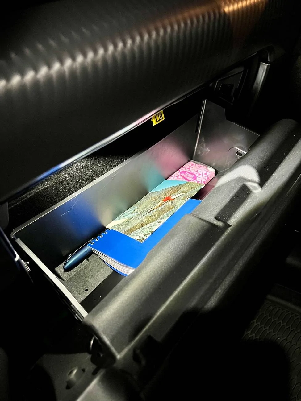

The wiring is not there, you will have to add it. I just wired it to the power outlet in the center console. The power is on constant and will shut down with the BCM just like the original. The factory light just mounts right to where they should have put it in the first place and it works just like my '17 did.

I can't find my purchase order but I want to say this looks about right: https://www.tascaparts.com/oem-parts/ford-glove-box-lamp-1s4z14413a
You can track down the plug pigtail if you want to get really fancy but since I just wanted to get the thing in after finding no plug I trimmed the plastic and soldered right to the pins. Power and ground, no polarity concerns, it's just a bulb and a switch.

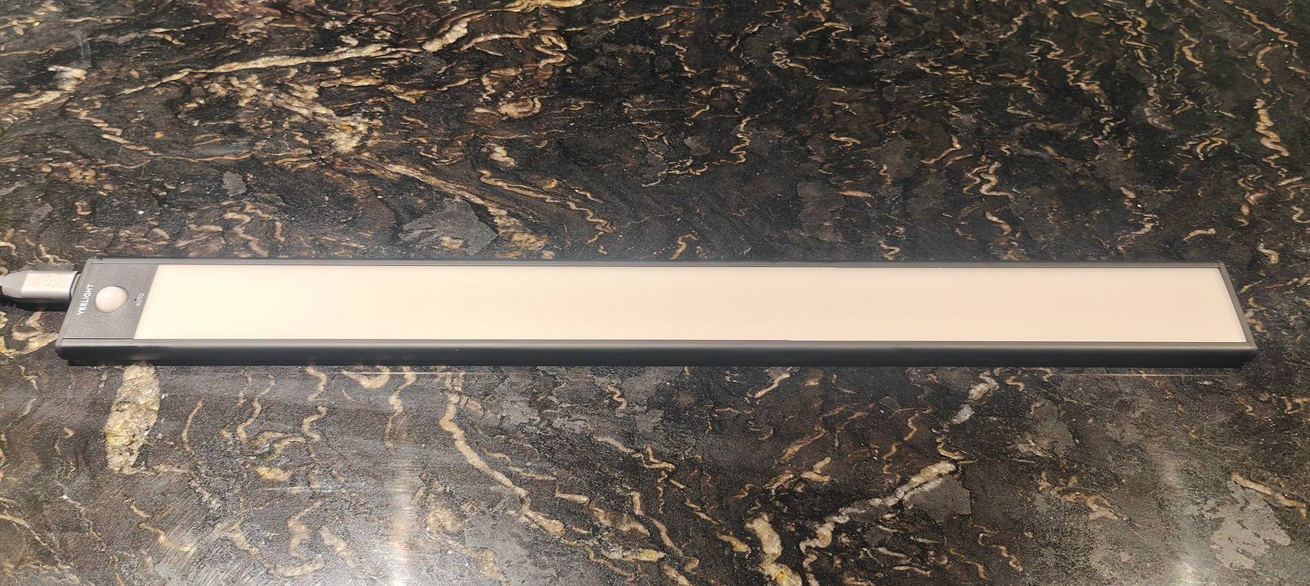

Would a motion detection rechargable closet light be the easy option ? Not sure if you can get one small enough . Something about half the length of this closet light that I use would be ok
