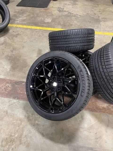

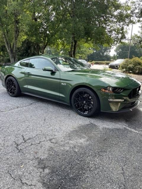

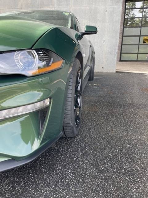

Just had my SVE M1 Reps installed! 19x10 +35 square set up and they looks amazing! 44 lbs lighter total weight savings than the OEM wheels and tires. I haven't ripped on them yet but I can already tell how much more nimble the steering and braking feels :)

Looks good! Hope you ceramic coated them before installation so they’re easier to clean 😉

They had a ceramic coat on them before they had tires on them lol!

Little update!
After stepping up to a 285/35 size tire up front my car now tram lines like a B****! The next mod I get will be a steeda G-Trac brace which should hopefully fix that issue! Just an fyi to those stepping up in size:like:

Which tires are you running? Some of it is the tire too. My Conti Extreme Contact Sport’s aren’t too bad except for grooved roads . The Steeda G Trac 2 point brace does help a bit

Actually, try an alignment.
The car shoildn’t tramline badly with 285s unless you’re slightly toe out. Zero toe or slight toe in and it should drive fine.
