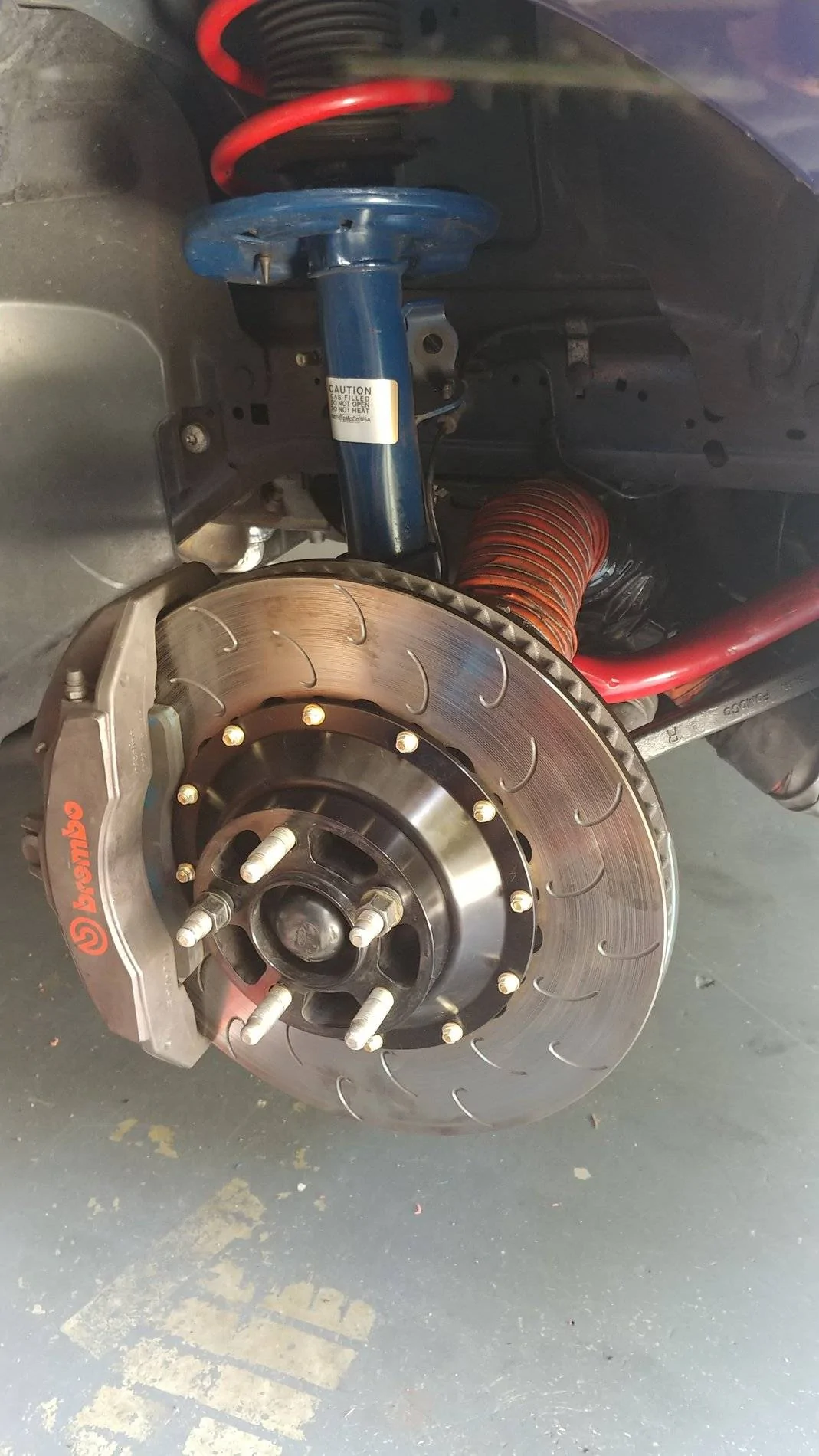

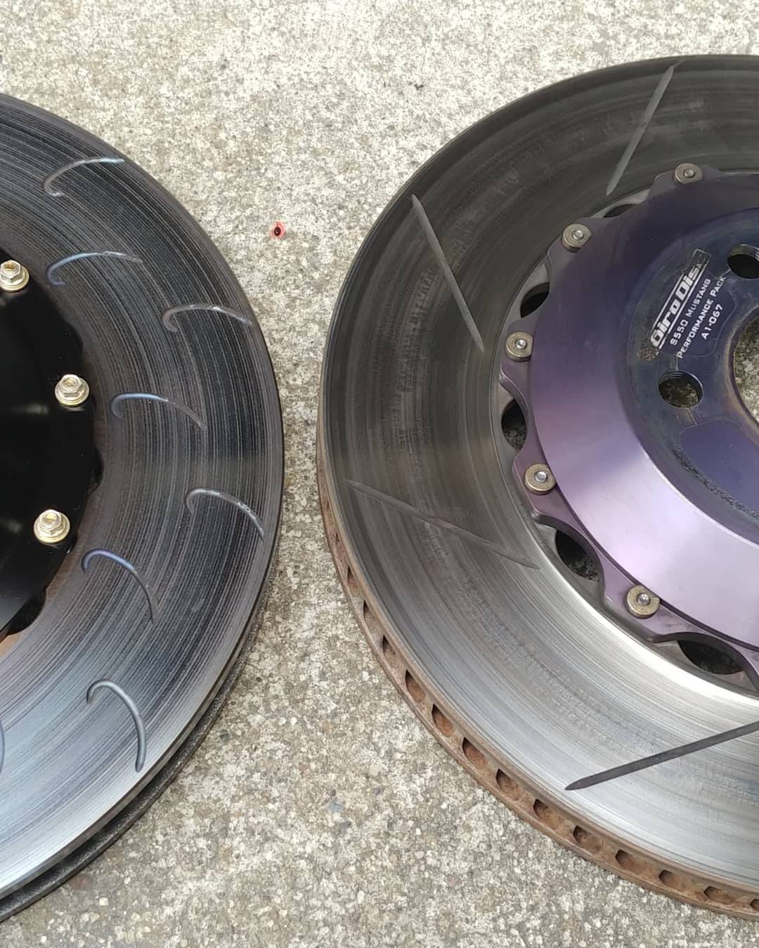

keep in mind that in most cases unless you are spending BIG money, saving weight with brake rotors is just removing material and compromising the structural integrity of the rotor. not worth the small weight savings
I respectully disagree
Usually a GOOD after market 2 poece rotor will increase the life of your brakes because the extra cooling you are providing.
Also will permit to the disc to expand better and freely due to the heat.
Most of the after market 2 piece rotors are slotted (DON'T BUY DRILLED ROTORS. THOSE ARE POSSIBLE TO CRACK AROUND THE HOLES)
the slots willmhelp to clean the excess pad deposit. Mantaining the rotor cleaner.
Main 2 companies I would recommend are
Girodisc or APR RACING ESSEX
girodisc around 1000$ for the 2
essex for 1500
