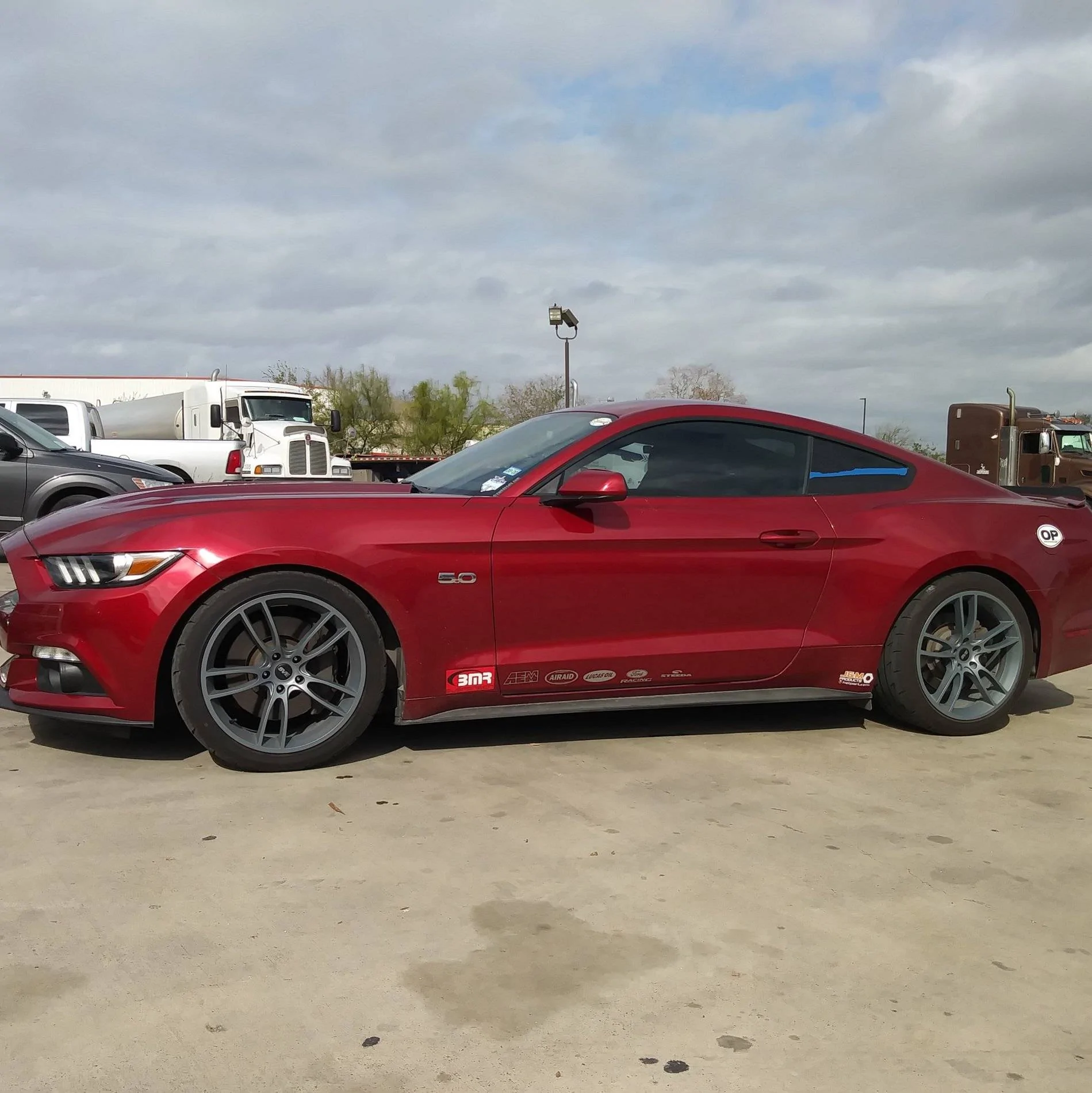

Coyote Red
Oct 9, 2016
1,249
371
Port Lavaca,Tx.
Alan
2016 5.0 Coyote Red
Dave has a good idea, I did go from base 18x9" split 5 spoke to a split five spoke SVE GT 7 wheel at 19x10" and could feel the difference, my butt-dyno told the difference. I f your truly in "Touch" with your pony you will feel it too. Us O.G. guy's like doing "weight loss" to our cars.
