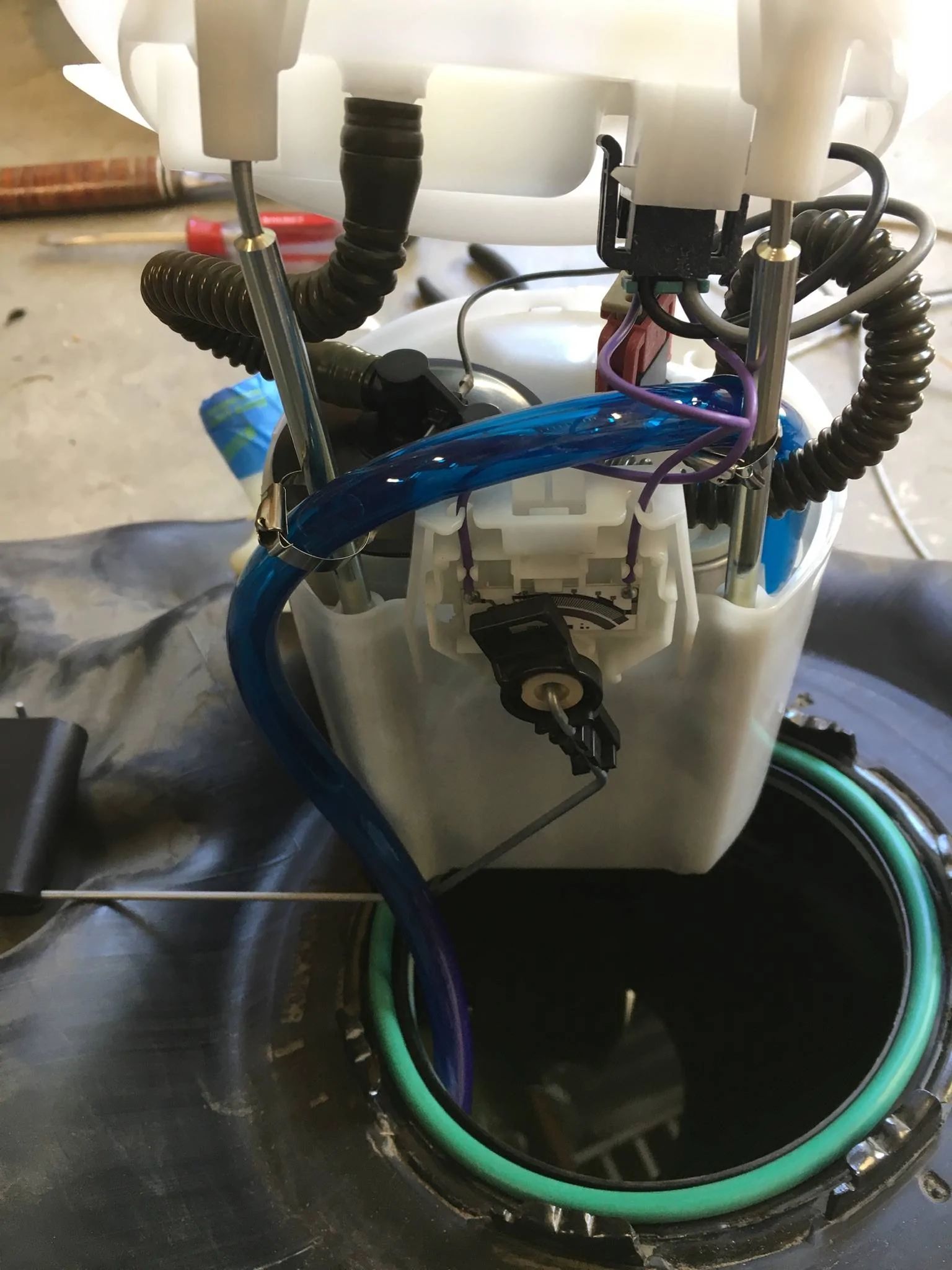

I installed a transfer pump in the passenger hanger, with a hose that crosses over the saddle and dumps into the bucket the main fuel pump sits in. I used to starve on long lefts below 3/4 tank. Have run this setup to 1/4 tank no problems but not going to go below that.
If you’re handy it’s a good solution that’s cheap, all inside the tank, and effective.

Angrey - thanks for the useful information despite the sigh :). Searching for "starvation" on this forum simply turned up oil starvation issues and I was unsuccessful finding related threads, though perhaps my search-fu was weak. I hadn't yet checked TMO though. Good detailed description, thanks.
Hey Scoots - that looks like my kinda solution. Would you mind sharing, whether here or DM, more info about parts and install? I am indeed pretty handy if I know what parts I'm hooking up where, and this might be just what I'm looking for.

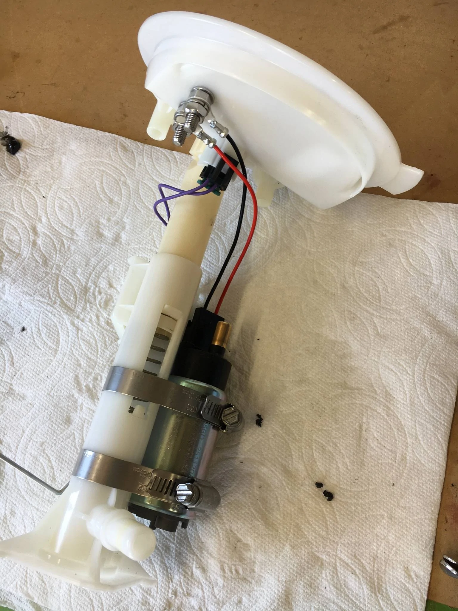

I was very close to solving this problem completely using low pressure lift pumps from the passenger side. And it does solve the issue by actively pumping passenger side fuel INTO my Radium bucket. I have yet to achieve a solution where it's automated. I wired in a switch to turn the pumps on and off, which is better, but not perfect. I bought the Autometer fuel guage (which allegedly has trigger capability based on custom fuel level targets) however, after multiple calls with Autometer, I can't get it to function as advertised. So now I simply have it as a second fuel guage so I can see how much fuel is in the passenger side. With the OE signal disconnected, I can also view how much is in the driver's side and when the driver's side is getting low(er) I can turn the pumps on and fill it back up.
Deatschwerks claims they've ran their micro lift pumps for an hour naked without burning them up, but I'm reluctant to try that (and simply wire the pumps to run constantly) in fear of them running dry when total fuel levels are 1/2 tank and lower (they'd push all the fuel to the driver's side). THat would automate everything, but then I'd stress about whether the pumps are unnecessarily creating heat or risking failure.
In the end, it's not THAT big of an inconvenience to simply fire them when I want more fuel over to the primary bucket and for a track application it's probably even more tolerable, but ultimately I haven't been able to get it to where I want it, which is no starvation issues (ever under any conditions) and no manual or unautomated features.
