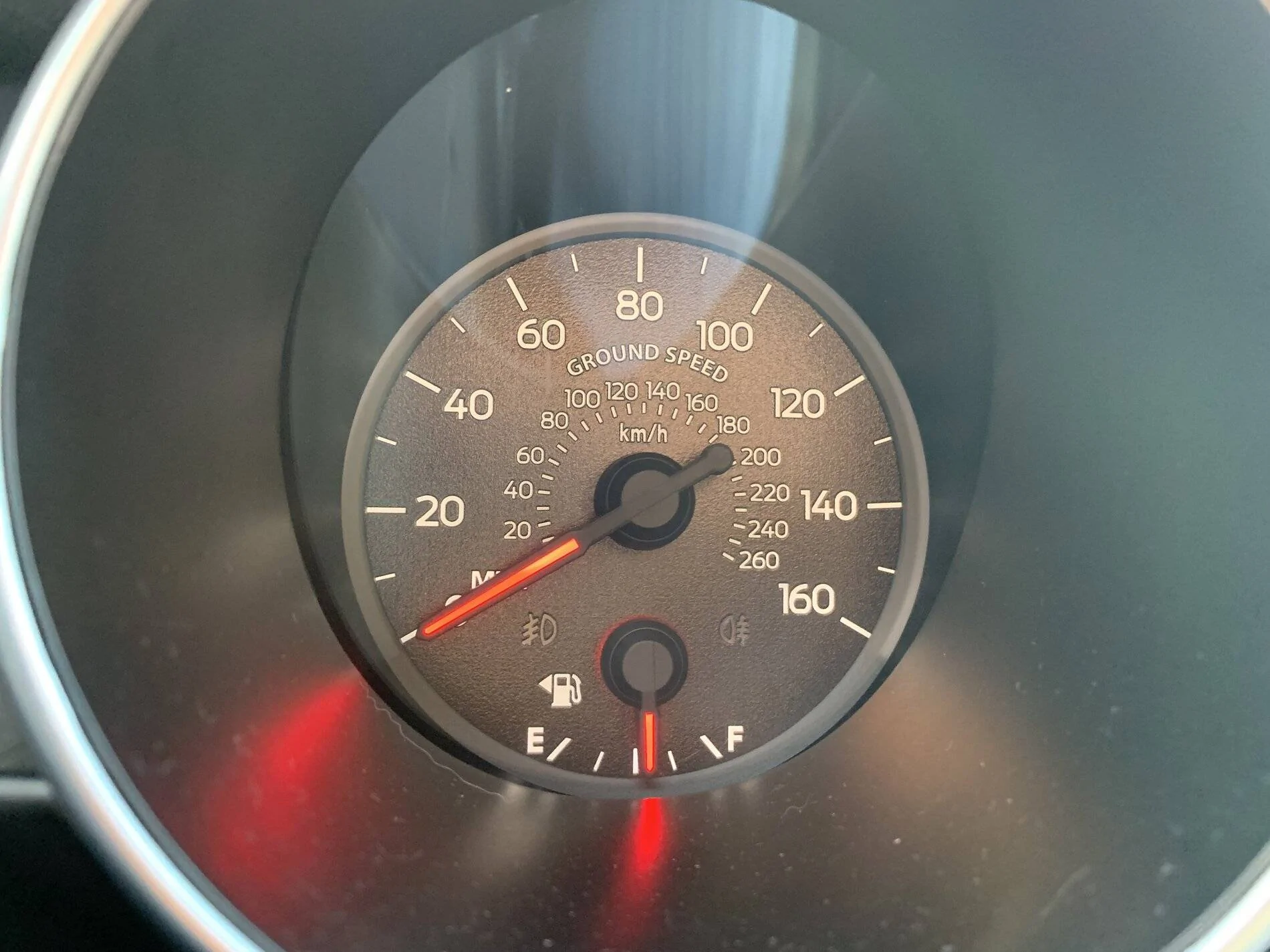

It’s interesting to see this posted here as I was just getting ready to ask about it. I have had my Mustang for about a month now and have been looking at that fuel gauge with suspicion. It seems to me like the needle is off center and was wondering if others were the same way. This is a pic with the fuel gauge at 1/2 and it clearly doesn’t line up with the marking. For it to point at the marking, the needle actually needs to be closer to 3/8.

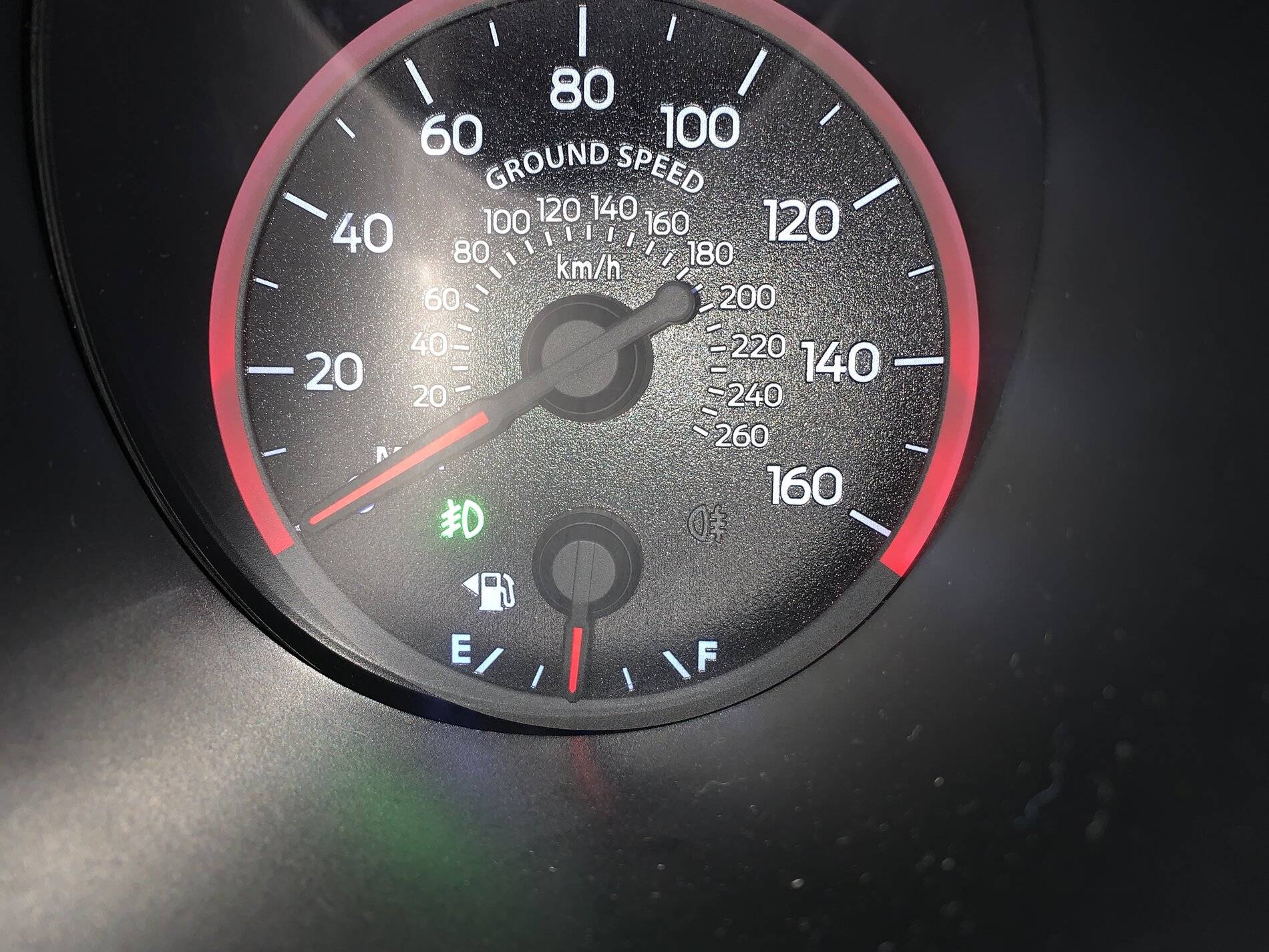

This is what my gauge looks like straight on; the needle is clearly at the 1/4 tank position and DTE is now showing 48 miles. But I won't take it in to the dealer as it seems that others have similar DTE and fuel level readings.
