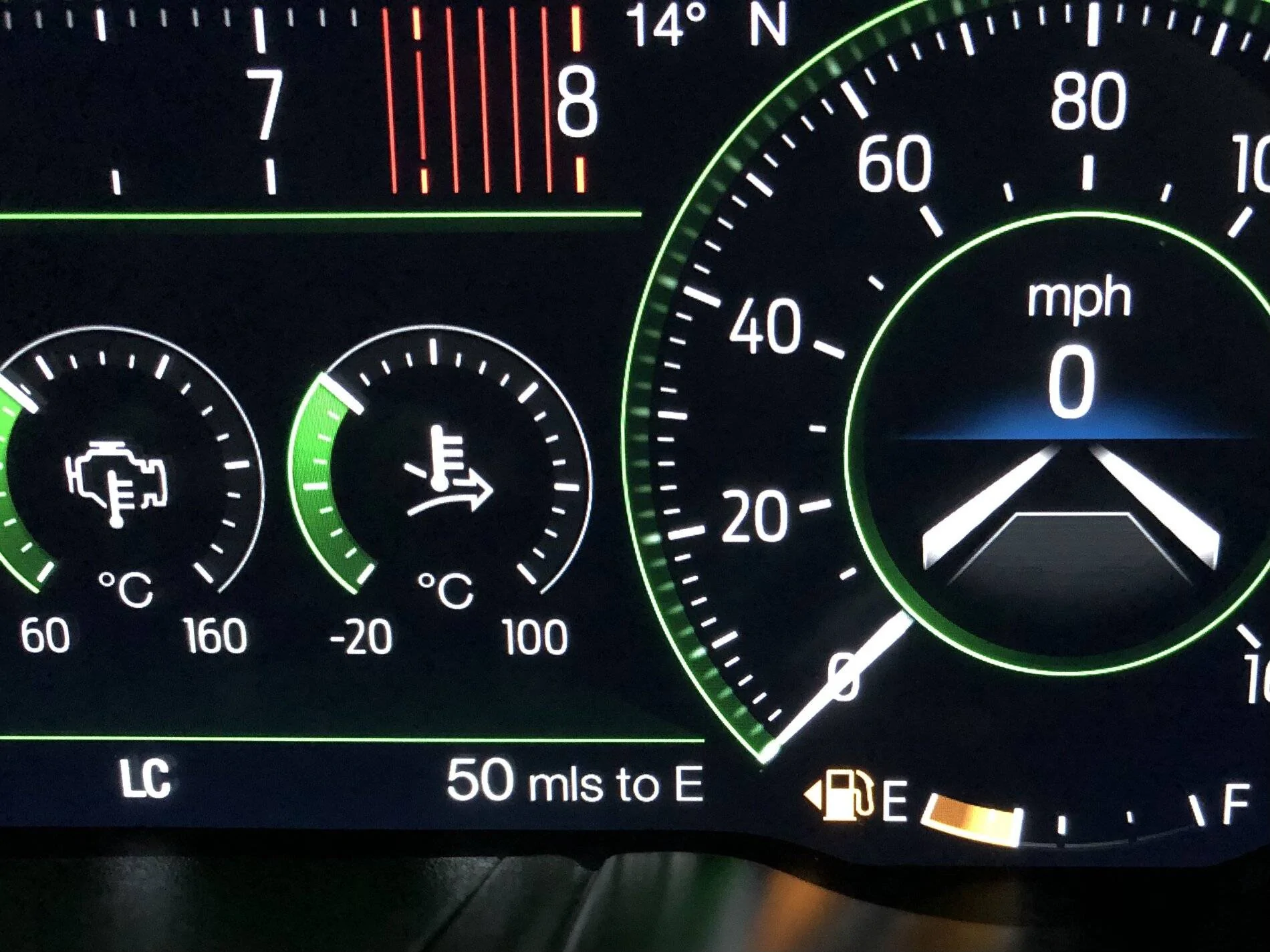

This went off tonight and I thought of you guys :
Difficult to see with the contrast, but it’s well over the quarter tank marker.

That’s MyKey, which I have one programmed as my ‘dealer key’ but that’s not what I was using here (no MyMode on a MyKey so I would know instantly + I physically identified the MyKey fob).
MyKey does increase the distance to empty warning, but I do not know to what value.
You can see my light has still triggered at 50 miles, but the gauge is higher than a quarter tank as I am not getting the same mpg as some of you guys i.e. my 50 miles requires more fuel when compared to a car that’s returning a higher mpg value :like:

I suspect it just goes on at 1/4 tank and the only thing that's affected is your DTE range.
Did you see the picture on post #34 ? :like:
