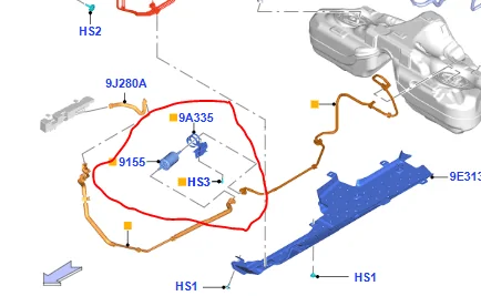

This is Ford's solution. The entire line with filter and bracket is $230. I bought one but I'm procrastinating on pulling the tank.
And the Filter is common to many other vehicles so it's readily available when its time for a new one.
Dude, I’ve been looking for that fuel line and bracket parts! Havent had any luck tracking those down. Can you help me with a link and/part numbers? Im switching a GT to a GT350 drivetrain. I have the tank parts but I dont think I have the line/filter bracket.

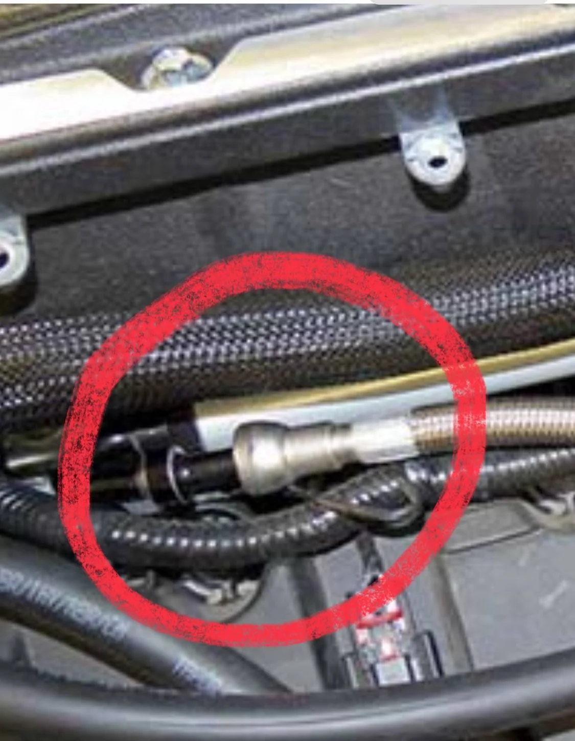

This is the union where I was thinking.

Has anyone put in a fuel filter in the engine bay? Bad idea?
I have the Edelbrock SC and there’s the braided line going to the fuel rails. Thought about putting one between the junction of the braided line and the rails. Would need a female end male end filter to basically put it in plug and play. Anything like that out there?
Thanks!
Take picture. What - ORB goes into your fuel rail?
What - an line size?

The pic I just posted is where I’d like to fit it if possible. Not sure of the size. It has the typical ford “push in” type clip.
Is this a 3/8” line?

I believe it is a 5/16 line on the 15-17 and a 3/8 line on the 18+ cars.
The disconnects should be fit for that
Crap. Well, I ordered a bunch of 3/8” fittings so ill see what fits when they come.
