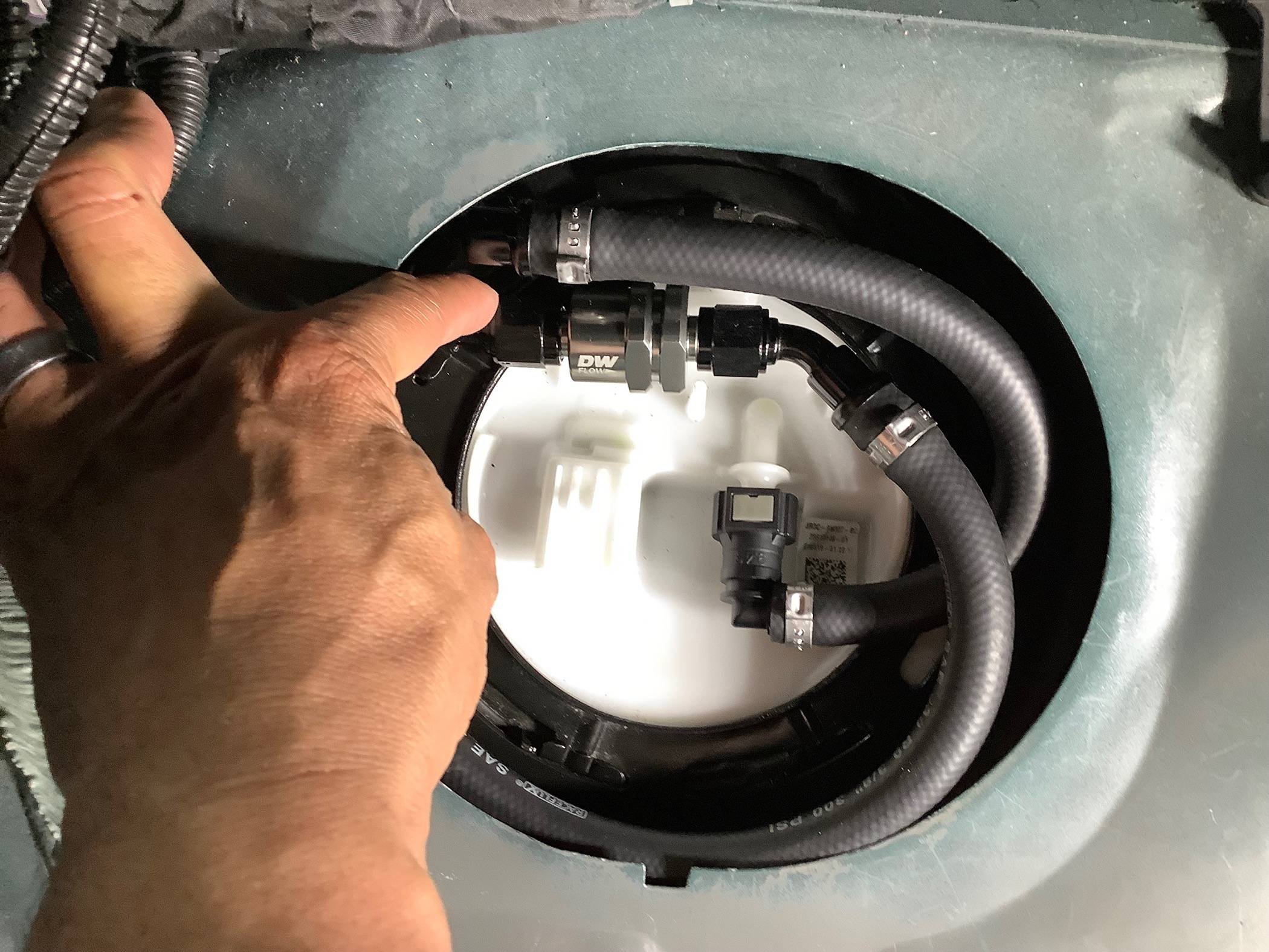

Install it here near the pump and there’s no worry about fuel dropping on a hot engine. This is a check valve that I installed, but a fuel filter should also fit.

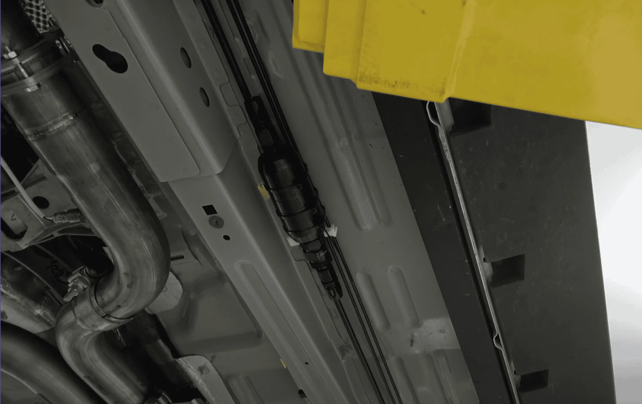

Framerail is pretty easy to get to.
