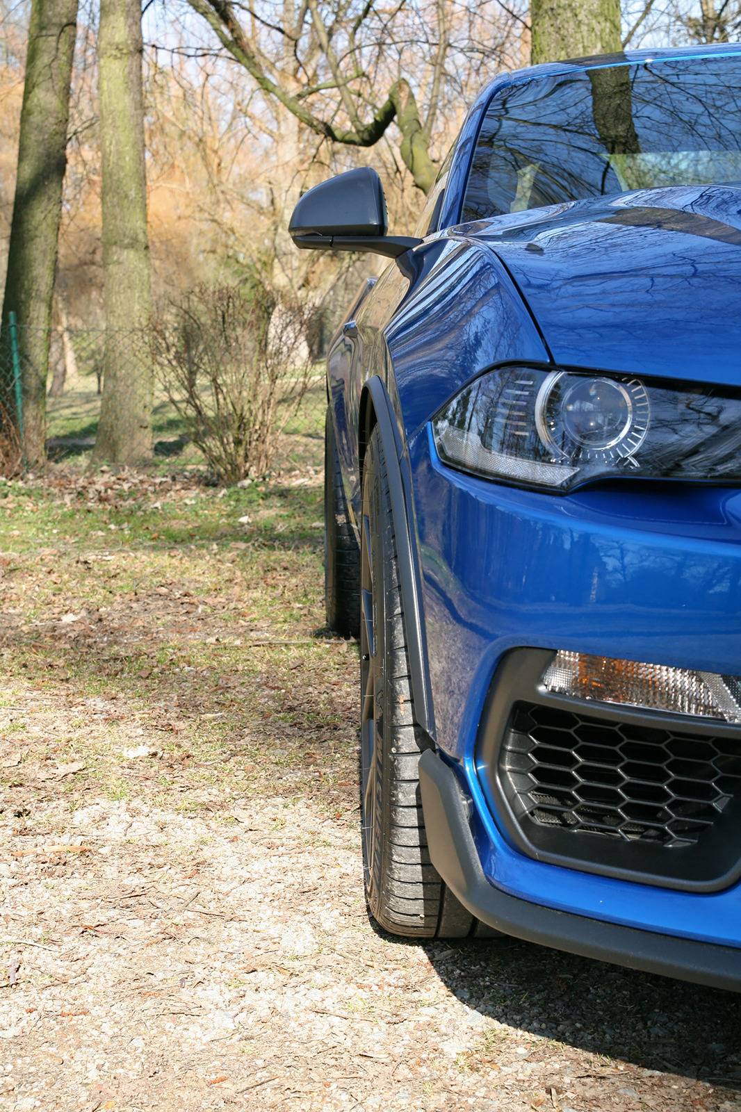

OEM's are 10.5" in the front, the rest is correct. Yup, it looks great and works great too, on the street and on the track too (just casual fun for me). I'm very happy with these wheels and tyres.

The bit narrower tyre in the front (285) doesn't really different from the regular one (305), rubber is flexible and it stretches and adapts on the rim, in direct comparison the difference will be only few milimeters of tread more and the poke is definitely very similar for both. More camber helps to align the top but the meat still pokes out, lip moldings are inevitable imo. Pricey, but the do look great and help with rocks no doubt. The 10" replica would work great in this regard, not requiring the lip moldings, allowing 285-305. What I don't like about the replicas is the glossy colour, the OEM HP wheels have amazing matte anthracite colour, it complements the other matte parts of the cars well.
Mine is standard export car for EU market, Handling Pack wasn't an option here. I'm freak for wheels so I immediately fell in love with them and just had to import them once FP released the pack for spectacular $1000 from Levittown. I dreamt of 300+ balloons since PP2 came out in 2018 😁 And as it happens, I got the car with PP2-style 9.5/10" wheels, I kept those as a winter set for October-March, not exactly needed as I go out only on nice dry days but the car needs to be ready for anything.
You have many options regarding wheels, and with those wheels, you have many options for tyres and tyre widths. I only mentioned what worked for me, I spent days thinking this through and going for something not entirely common. One thing, stay away from PS4S 295/35 R19 tyres, they're for Mercedes 10" rims and look stretched on those 10.5/11" wheels. 305/35 has 0.3" taller sidewall over 285/35 diameter difference is 1.5% to 255/40 so acceptable too, it should work fine without rubbing issues, but I don't have this confirmed. I wanted inch wider than normal but not that much poke (even if the difference is small). Though same tyre size could be rotated.
PSS 305/35 R19 should be easily obtainable as it's OEM size for earlier GT350 and some Camaros etc. They're fully compatible with PS4S, pretty comparable too, on dry perhaps even wee bit better (who could tell though), PS4S are a bit better on wet but that's not that important for me.
There's Continentals ContiSportContact 295/35 R19 with tread width even bit more than PS4S 305/30, really great tire overall as well and good fit on those wheels.
Many options to choose from. I went back to first post and see you already got the Cup2's, I'd stick to them until you wear them out, which will be fast. They throw rocks like crazy so lip moldings are necessity.

Go economically about it when you already have it. Add the lip moldings, run tyres down, then change them. Cup 2's won't last that long, 6-10k miles apparently.

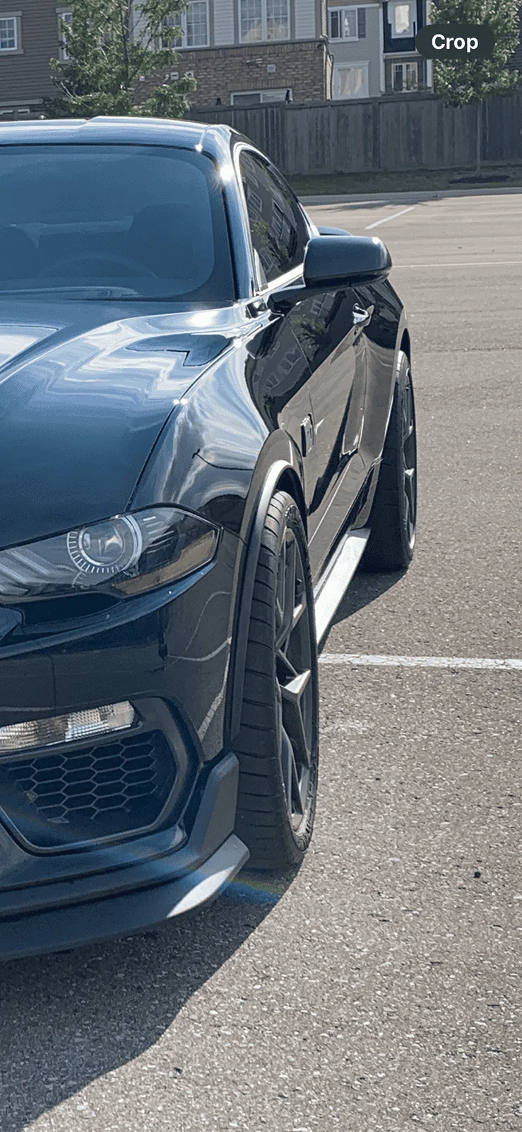

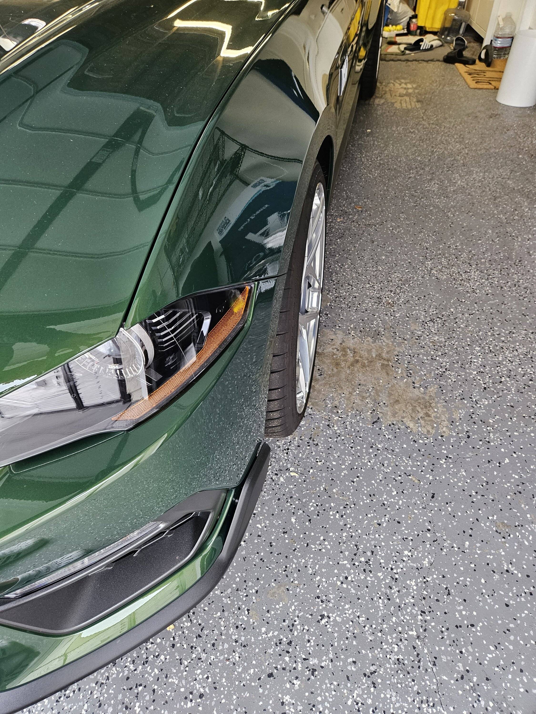

Hey guys, just installed my handling package wheels on my non handling package Mach 1 I’m still waiting on the front splitter, rear spoiler, and wheel lip mouldings,
I’m looking for honest opinions on the amount of poke on the front tires, it looks a little much to me. I was wondering if the wheel lip moulding will give them a more tucked in appearance.
Thanks
Thanks
Your front tires do not look like Sport Cup 2s. That's why they poke out so much. However, it does look like you've got SC2's on the rears. The SC2's won't sit out so far in the front as the sidewall isn't as square.
So you’re telling me they poke out so much because they’re not sport cup 2,s lol, well fact of the matter is my friend. They are sport cup 2,s and that’s why they stick out so much.

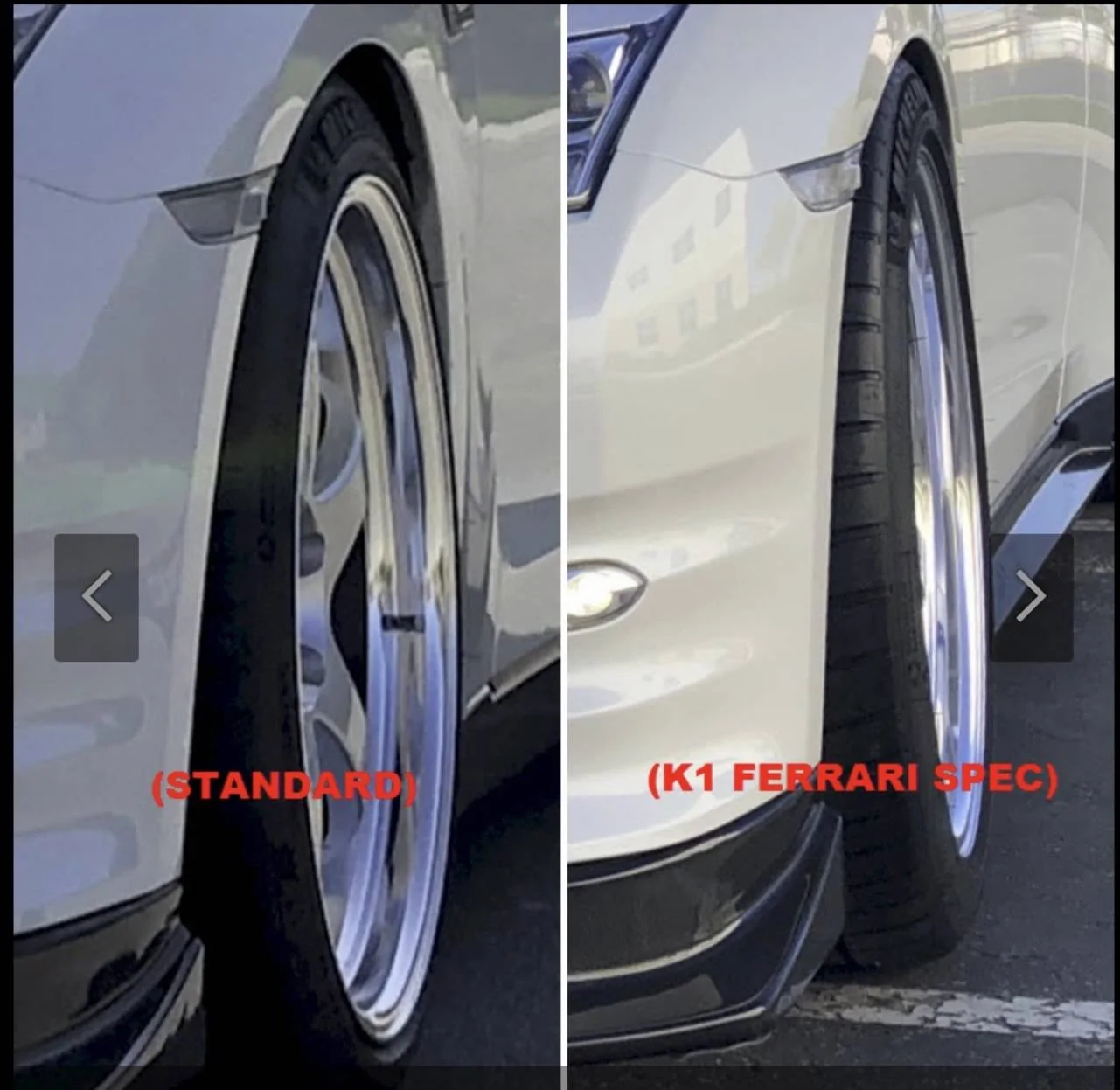

To add even more craziness, if you get a different spec of the same tire it can cause a little more poke. For my rear end I made sure I got the Ferrari spec (K1) pilot sport 4S so I could have the 35 profile height of a 295 with the same tread width of a standard 305. K1 spec also was slightly lighter.
see below pic of a comparison with the amount of poke (Nissan GTR in pic). Notice the amount of extra camber that was required to keep it under the guard:whew:
That's what I'm telling you. But, like @Ben James said, the Mach 1 must have a very different spec of SC2s than the type that come on a GT350R, or a PP2. They don't look like those at all. Way shorter side wall and let tread. But I'm glad you got a good laugh. 😁

The lip is around 1.5 cm wide in the top section. It covers the tread but the sidewall just barely, looking from the top. From the side, rubber is clearly still visible. This is with 285/335 in the front on 10.5" HP front rim (with 305 it'd be poking a bit more).
