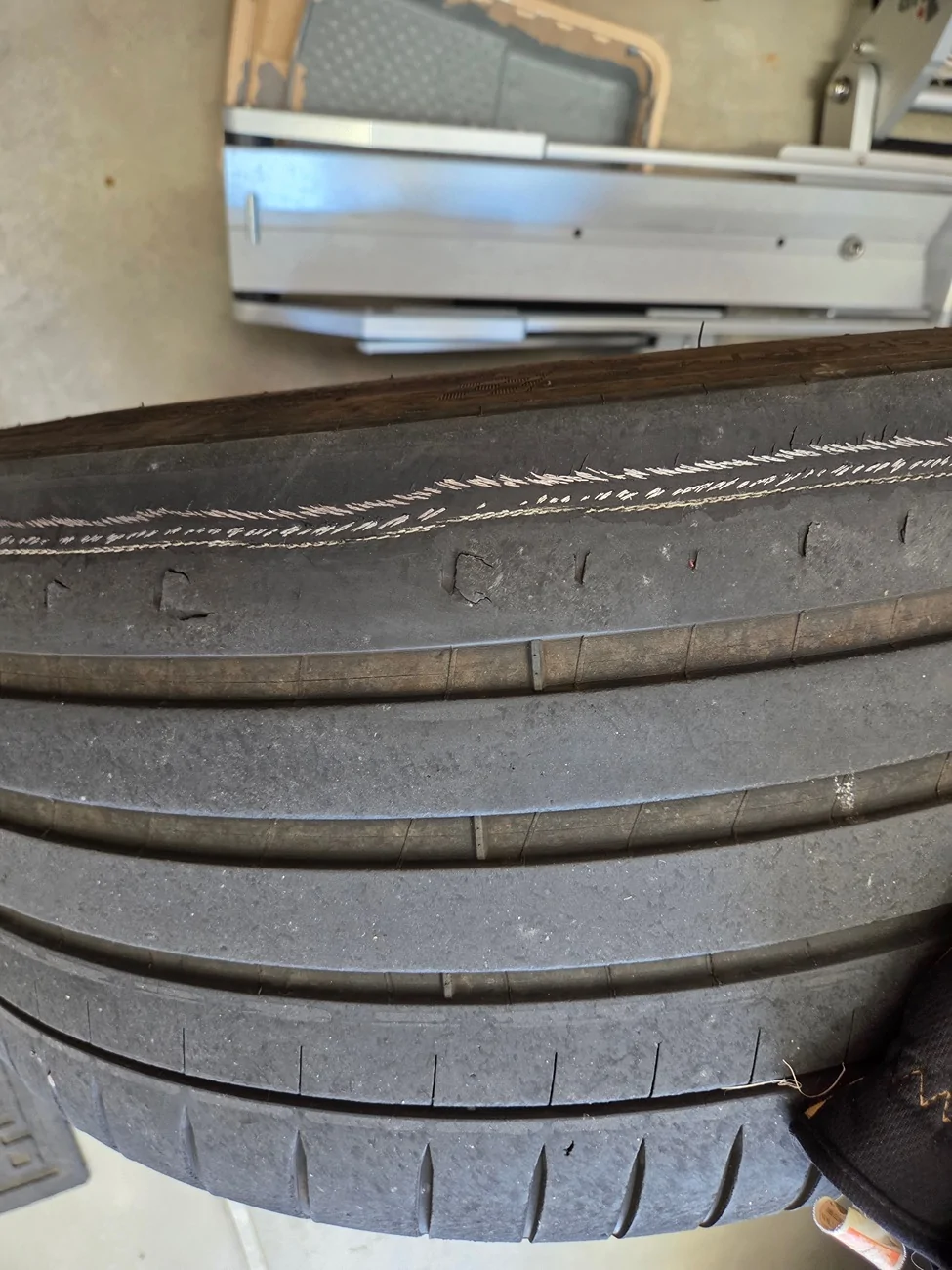

Was out for a drive today when the TPMS kicked out a low pressure warning. Got out and checked the tire and could hear air coming out through the cords. I checked the other front tire and found the same wear pattern.
I have the non-HP car with 20k on these PS4 tires, and have a few autox events and a road course session on them. I was surprised to see that wear on the inner edge, and will have the alignment checked.
On the positive side…was fortunate in having a full size spare I purchased a few years ago. Reminder to self….check the edges a bit closer.

Been there with my 18 GT. Was around 25k miles when I discovered. It was a bummer because there was still good tread on the other part of the tire.. I had replaced with a full set of Conti's but prefer the PS4 as the Conti's look a tad bit smaller. I currently have a routine, wash the car, check the oil, check the tires.

Too much toe out, but those tires at 20k almost always show more wear in the inner tread due to their design. That’s a bit extreme though exacerbated by your alignment

Happened on my 2018 GT as well. Not uncommon with S550's for some reason, and because it's just the inner edge and you can see lots of meat on the tread, you'd never realize its happening till you fail state inspection.

The inner areas of my front tires wore prematurely also. The toe was off

These cars do not have any way to adjust camber unless you buy and install aftermarket parts. Ford should have installed camber plates but elected not to. This is especially critical if the car has been lowered as that increases negative camber.

100% toe issue. Get a shop to set no more than .03 toe in and your tires will last forever. I put BMR camber bolts in to dial alignment in better. Rear toe set between .10-.13 per side. And as much positive camber as I could get on rear with stock adjustment which was .08. Car still handles great. And tires wear nice and eve on minimal drop springs šŸ‘

If it makes you feel any better, these tires are done at 20k corded or not.
Neg camber has little effect on tire wear. Toe is the issue.
