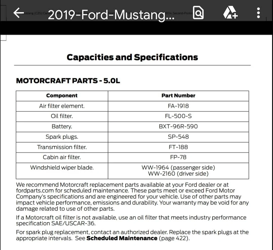

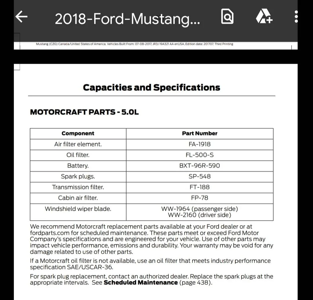

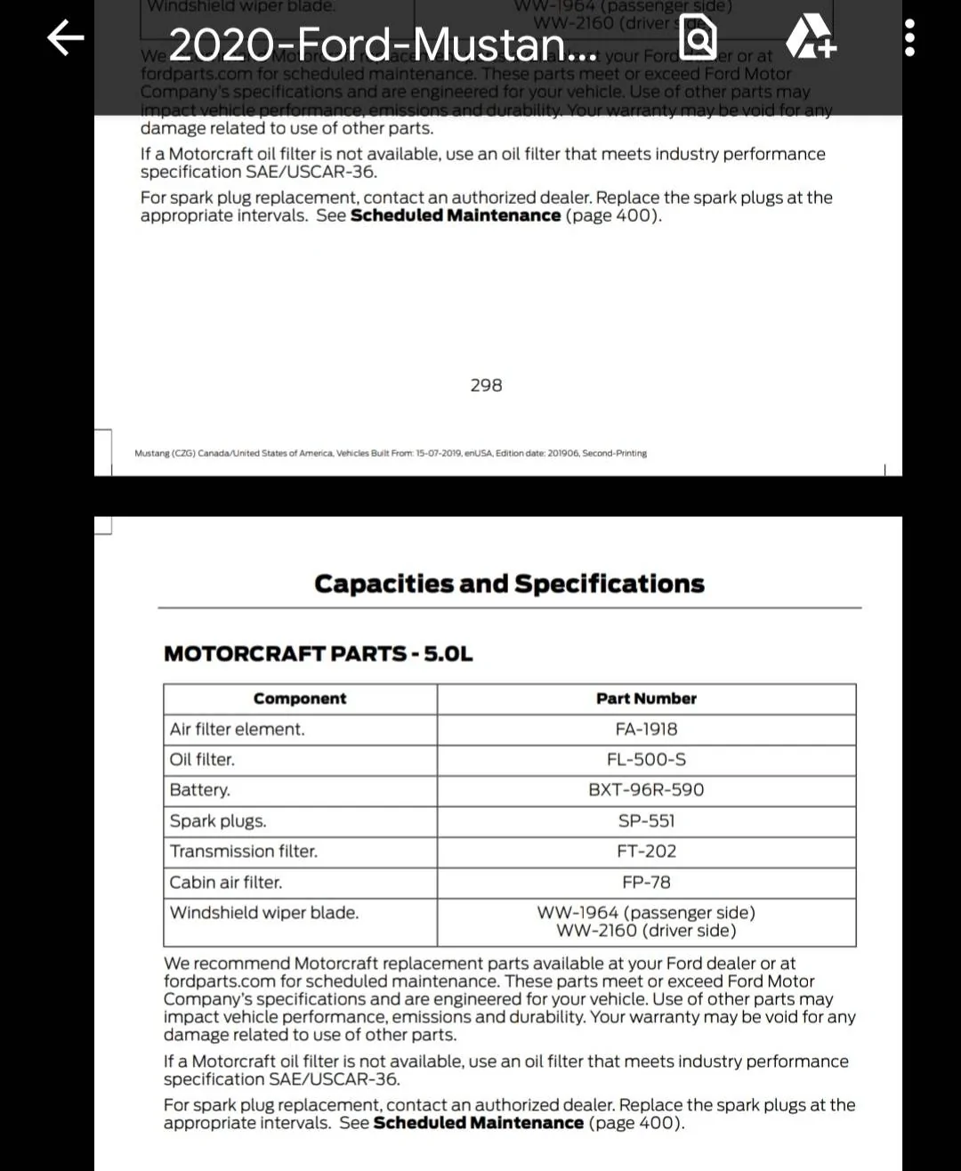

Straight from the owner's manuals online:
I didn't hear it I've seen it. My new 2020 has heat range 7 plugs, it says right on them. They are NGK plugs manufactured for Ford, the only real difference between them and the 6510 is the gap. The 6510s come with a smaller gap. This is most likely why Whipple is now recommending the Denso heat range 8 plugs. I called them and they specifically said not to use the 6510s on boosted gen 3 cars.

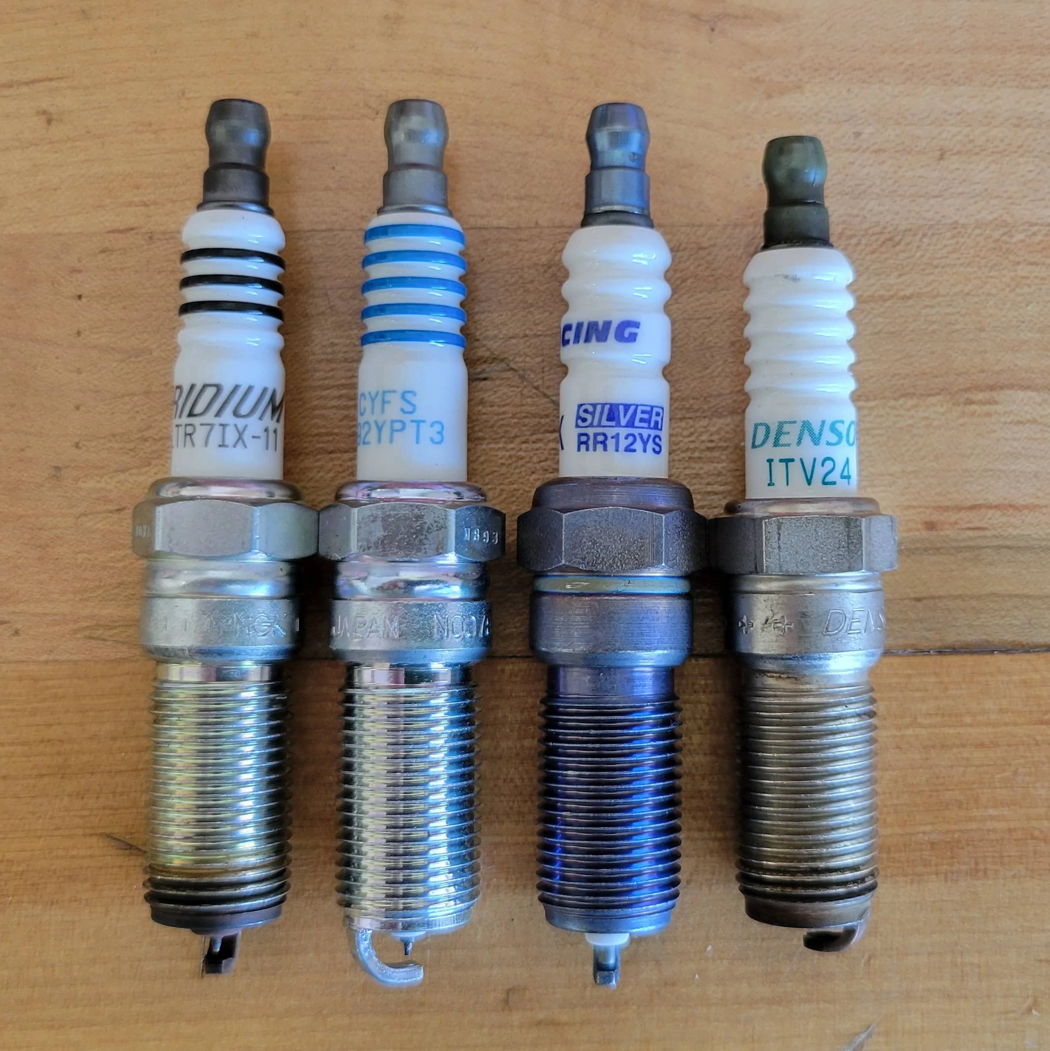

I did some research and you were right, it looks like they did make a change. The plug 20+ number looks to be superseded twice and looks really similar to the Cobrajet plugs I'm using. I wonder what they found to make the switch to a colder plug.
Just for S&G's I put a set of ITV24's back in my car today to see how it runs, It ran fine once the engine was up to temp. I didn't datalog to see if anything weird was going on though. The Denso plugs are about 1/4 shorter than every other plug for this car so maybe I didn't have the boots pushed on all the way last time.

I noticed the same thing about the Denso's. They are certainly shorter. I was actually worried about the coils reaching. But lots of guys run them, so it's shouldn't be a big deal. Keep us posted if you notice any differences.

I've been trying to find info on the change in heat range, on and off, for quite a while. I have a 2019 so the 548. To those of you that have playes around, does moving from a heat range 6 to 7 make a tangible difference?
So the sp-551; or the sp-589 if you go with the 2022 MY.

I ordered a set of Brisk rr12ys plugs which are their projected tip two steps colder plug. It is the equivalent to an NGK heat range 8. So far the car loves them. No issues to report. The Brisk plugs look more robust in their construction also.
