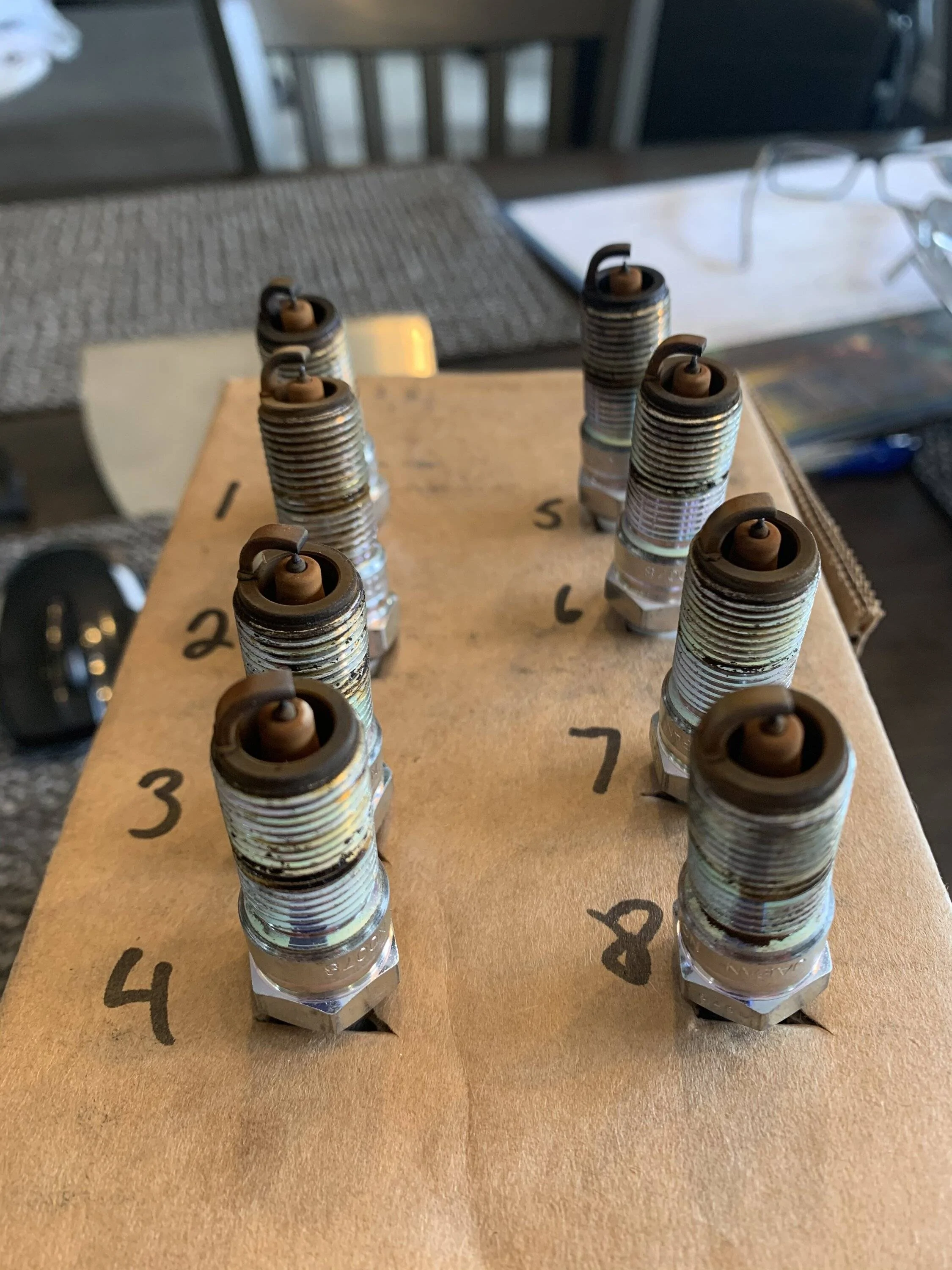

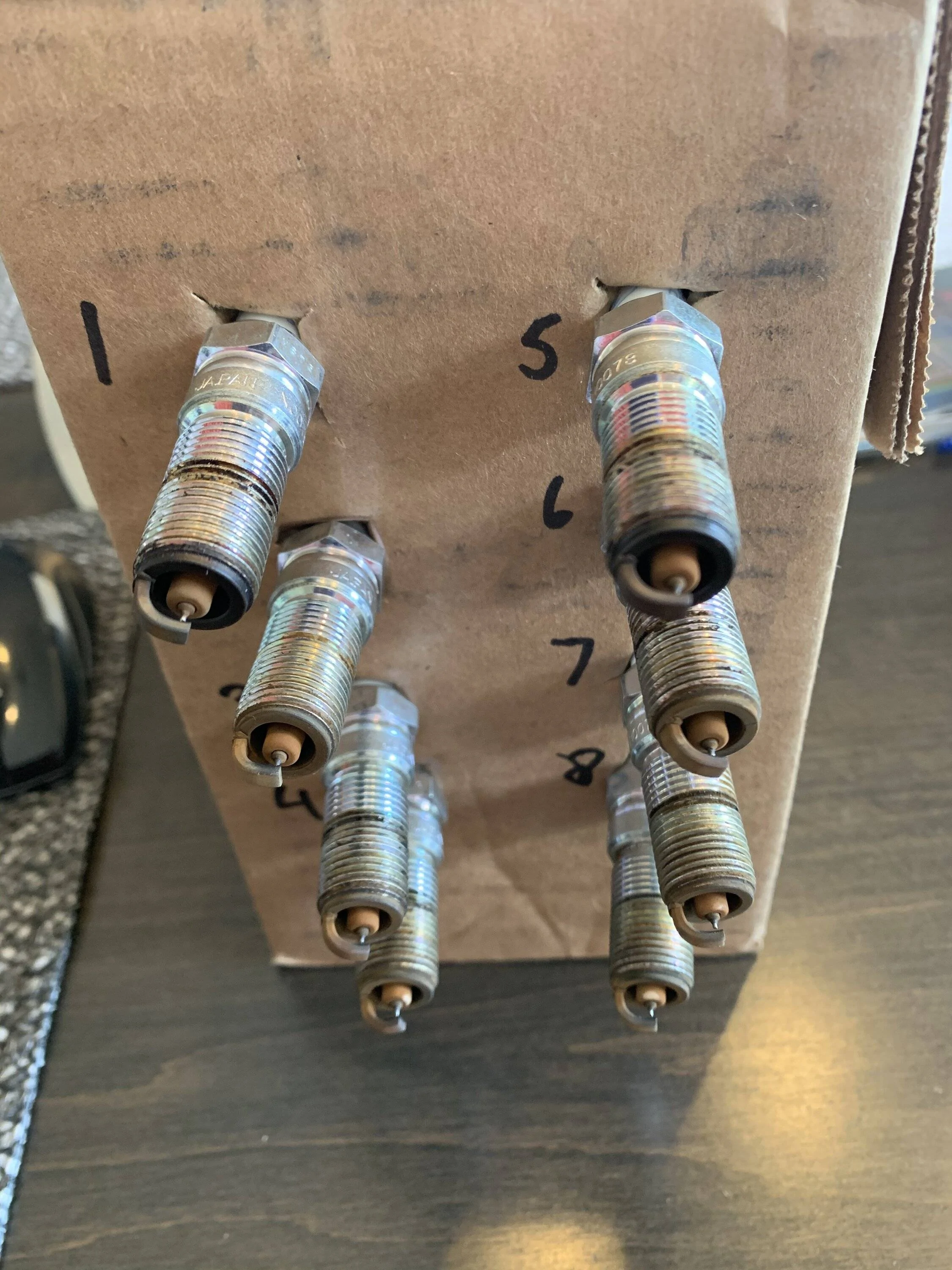

looking at the outside won't tell you much more than something being horribly wrong.
you need to use a spark plug reading tool.

Those plugs look bad for only 500 miles, I'm guessing you're running some kind of fuel additive?

I didn't think they looked bad. No octane boost in those miles. I did use Royal Purple injector cleaner as well as Techron in those miles. No hard pulls - babied the car really. They're actually quite tan coloured up close - but not orange as MMT would make them. Could be from the cleaners though.
It most be the cleaners, the base ring is full of soot and the porcelain should not be dark tan at only 500 miles.
Yes. I see the black colouring, but it's not actually soot. It doesn't wipe away and there's nothing on the rag when wiping. The porcelain is a light tan colour. Maybe it's the pic. I'll post up my old plugs for comparison. They had about 8-9k miles. These are what I replaced when initially in an attempt to correct the misfires.

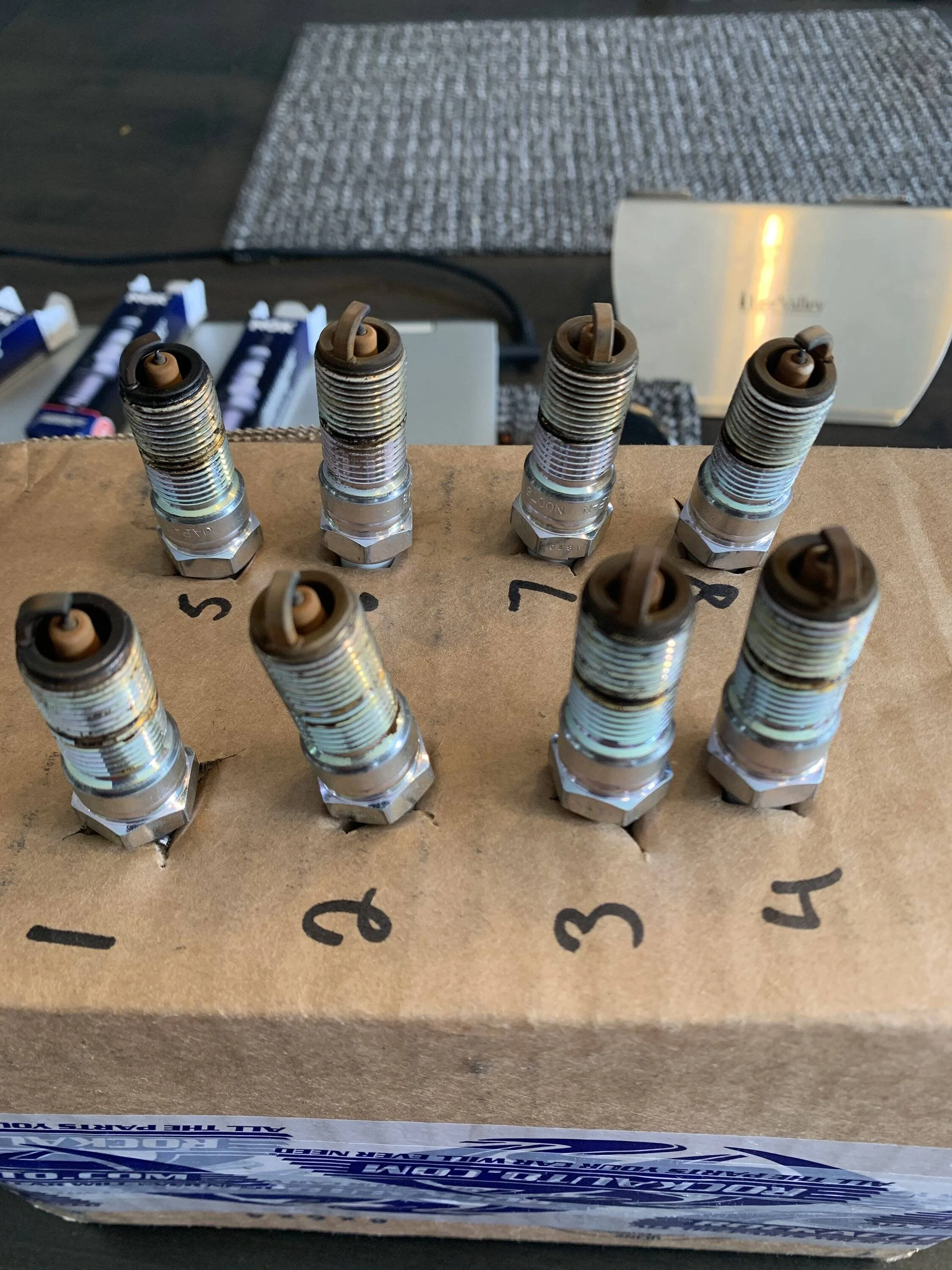

2016 GT Convertible
These were my original plugs.
