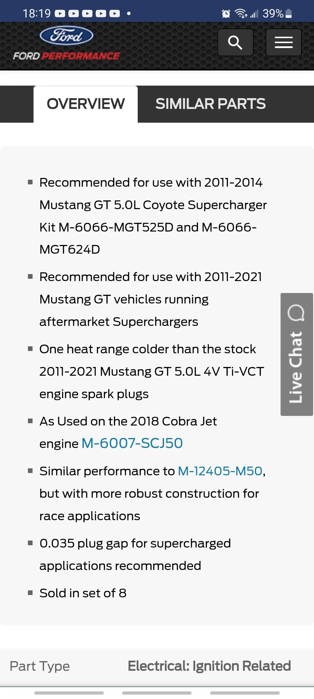

I run the 2018 Ford cobrajet plugs, also what Edelbrock supplies with their new 2650 kits. They are an iridium plug similar in design to the NGK 6510 but a step colder. They're also $65 a set from LMR. I have run 12 psi on them with boostane/Octanium and meth injection with no issues. They are a good option for low to moderate boost.

I have searched and was unable to find any heat range for those CobraJet plugs. Have you seen anything?

Yeah exactly. In 2020 Ford switched to a heat range 7 plug and before that they used a heat range 6 plug.
If they were released with the 2018 CobraJet then they're probably 7s or what the engines are coming with now from the factory. But who knows because they didn't publish the heat range for these.
Whipple is recommending a heat range 8 plug now for supercharged applications.

No it's for real. A colder plug definitely can benefit a car if the original was not the best choice in the first place. They only made the change after 2 years. Power and compression were both bumped up for Gen 3. They must have learned something. Changes happen all the time.
