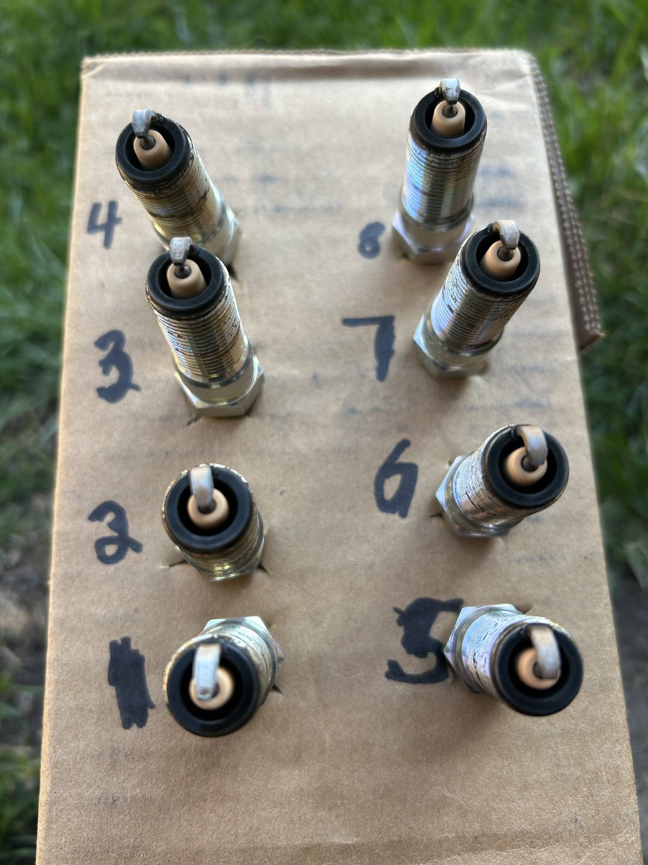

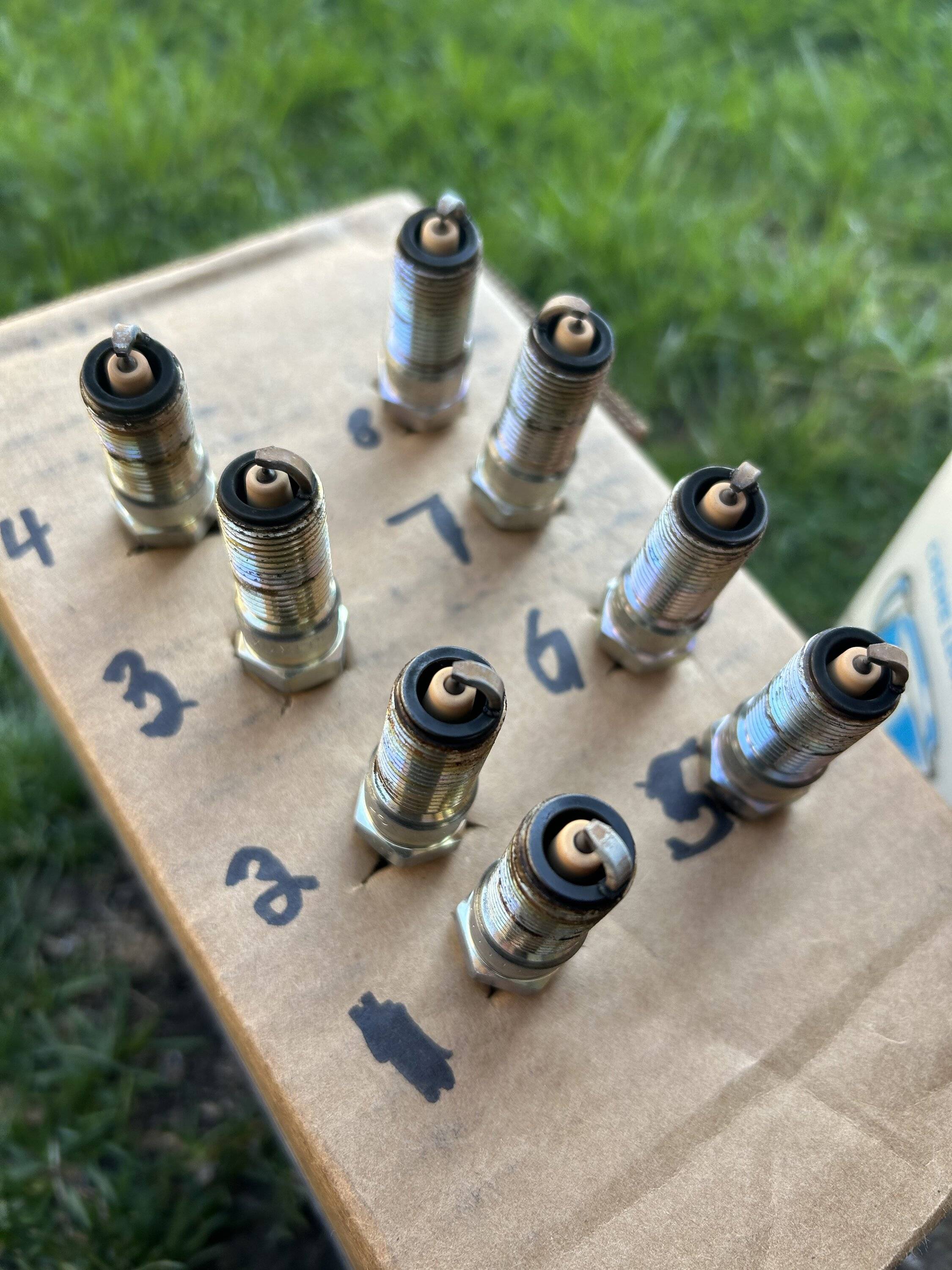

Finally able to start to figure out my idle misfires and off idle hesitation.
First up is another compression test. I’ll post the results later.
Here’s my plugs though. Anything look suspect? New plugs 500 miles ago.
Thanks!!

1 & 8 don’t seem to be discolored as the rest of them (as far as I can tell from the pic).

Thanks. Yea I noticed that as well. A little more white.
Gap is consistent at what I put them in at. 28
Just looked. #1 was the most consistent misfire and highest number of them in mode 6. All cylinders had misfires at different times. It’s the plug that’s also the lightest in colour.
Plugs have about 500 miles with no hard pulls on them.
Got the compression test done. Different tester than last time. They range from a low of 208 to a high of 216. I think the 208 was actually a fluke maybe as when I started to unscrew it it was completely tight. Likely moved a little when I set it down. But compression is super consistent. Maybe lower than last time overall but different gauge. Car has not ran in 5 months so it’s completely cold with no oil pressure anywhere. Wasn’t look for absolute numbers, just consistency across the cylinders.
Wonder what’s up with #1?
guess it’s time to pull the $&=*> injectors on this. The absolute worst job on an Edelbrock!
