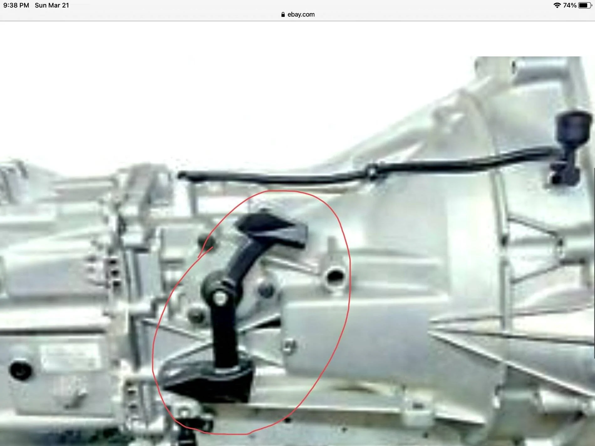

Been chasing a very annoying clunk/rattle and couldn't tell where it was coming from until today. Recent upgrades were MGW shifter, Borla Xpipe, Differential lock out bushings, Steeda stop the hop kit with subframe bushings. At first I was sure it was something I did during the installs, went back and checked everything and every bolt I touched and all was good. Finally got it back on jack stands and had wife shift gears while I was under car and found it. On the driver side of the MT82 there is a shaft coming out of the trans with what looks like a large counter weight attached to it. Nothing else is attached to it, looks like it acts as a counter weight only, but it is very loose and wobbly and makes contact with the side of the trans. It looks to have a drive pin securing it to the shaft and wobbles in all directions and probably should have had a nylon washer between the piece and the trans to take up the slop. I assume the shaft operates the shift forks inside the trans. Is this a common problem for this transmission? Car only has 1300 miles and I'm thinking about fixing it myself instead of taking it to a dealer. I would have to lower the trans in order to drive the pin out. Bad idea?

I’m at work and can’t post a pic, but it’s definitely the part I’m talking about. It’s a rattle and can be reproduced when shifting gears while car is stationary and not running. It’s loose enough that it moves around enough to make the rattle when driving over a gutter or speed bump and the noise is coming from the area where the part lives. It’s not a NVH noise. As said, it appears to be a weighted counterbalance and is about 7 inches long and is weighted on both ends and is only attached in the middle by a shaft coming out of the side of the trans on the driver side. The shaft moves the piece when shifting. I have an appointment with a dealer on Saturday. I don’t see how it’s hurting anything, just loose and rattling.

Dealer acknowledged the defective part, called it a damper, and will be replacing the part after they receive it.

I know this is an old post but wondering about the counter weight is the source of my noise. Do you by chance have a picture of it?

Here’s a pic of what’s being referred to.
