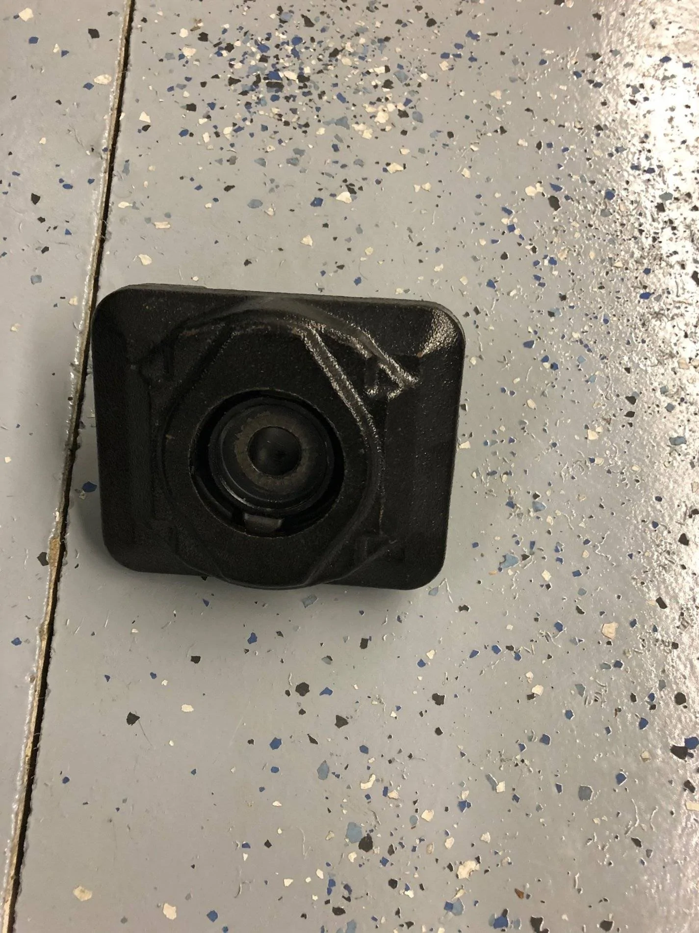

Can someone identify this part?

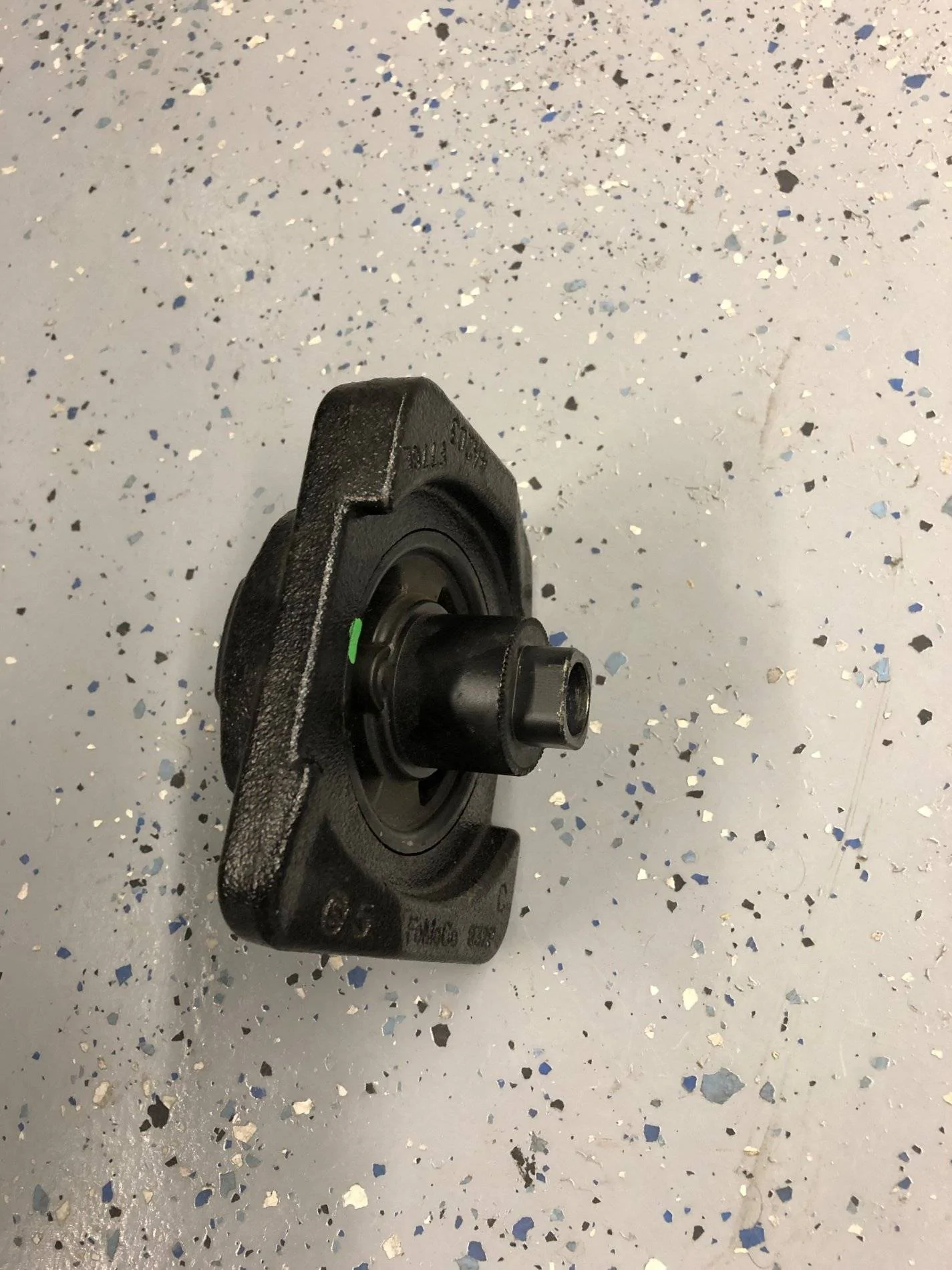

In the process of installing the BMR differential bushing lock out kit on my 2019 Bullitt I had to remove the part in the attached pics. The passenger side rear dif bolt ran through it, but it had to be removed for the install. No mention of it in the instructions. What it is it? Do I have to put it back on?

#12? It doesn't look exact but that is probably your part. Looks like a rubber mount for locating the differential. I would say yes that it is needed.
Don
Thanks for posting that up. I find it strange that none of the install video's for their differential bushing lockouts from Steeda and BMR show this part being on the car. Their completed install is just the poly bushings over the existing rubber bushing with new bolts. As of now I've followed the instructions and left it off.
