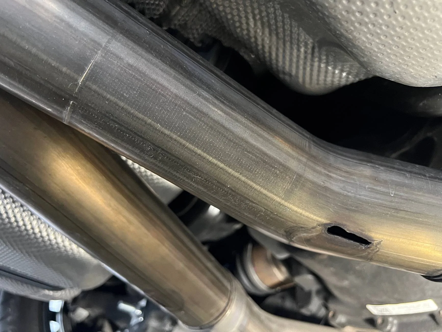

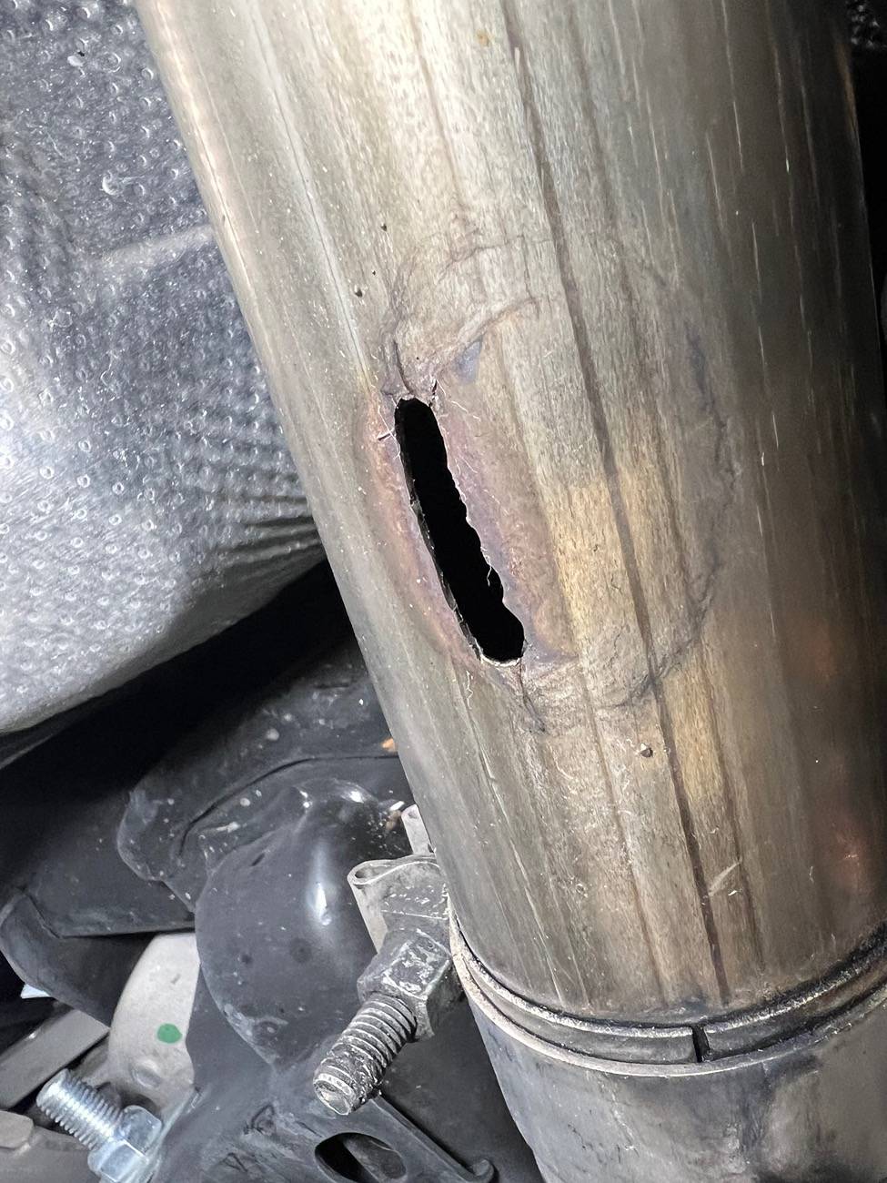

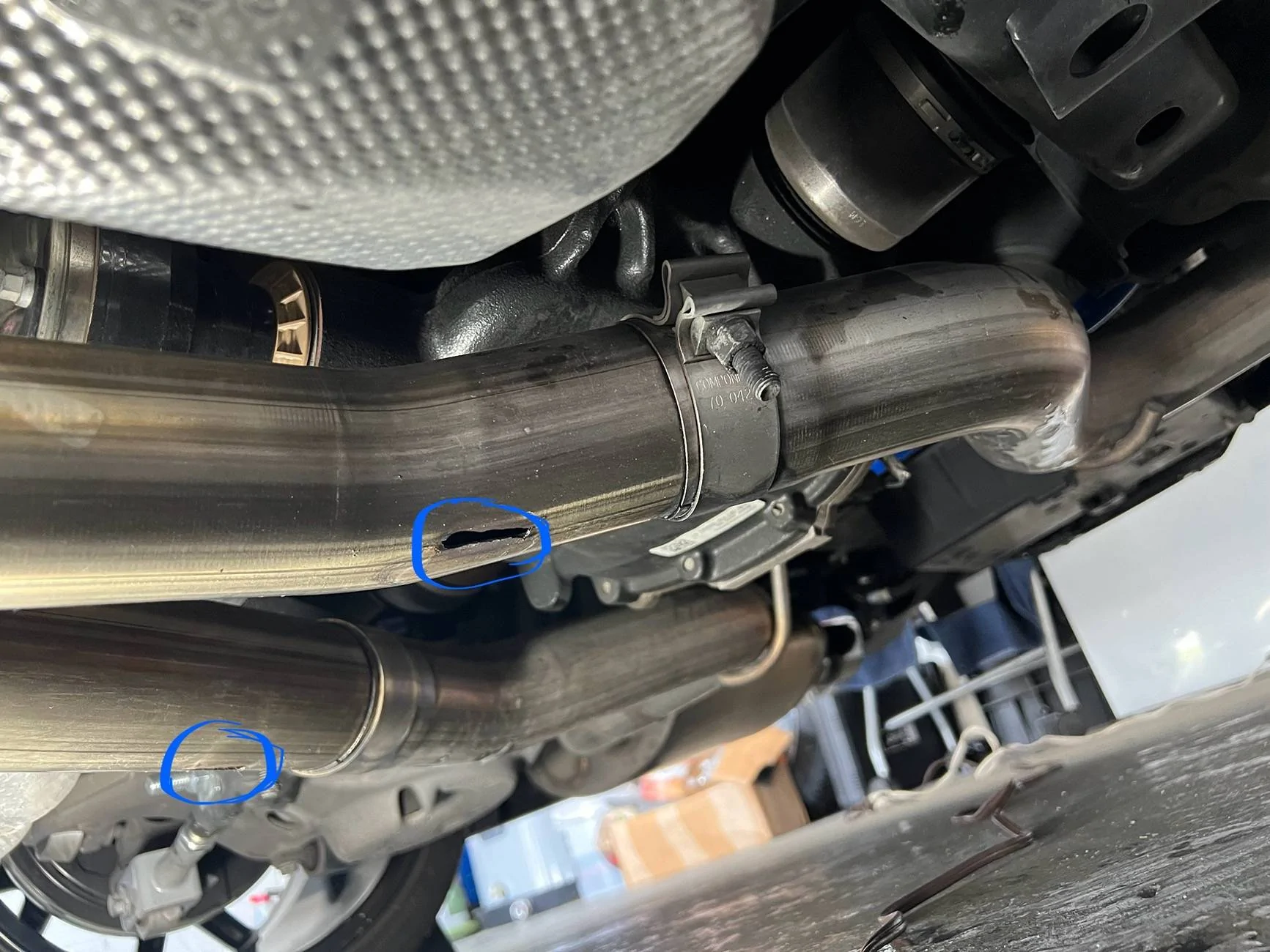

I noticed that the tone of the Corsa cat-back in my pp2 has drastically changed to a somewhat flat tone. Came to fine out that there are 2 holes in the muffler around the areas show in the attached picture. Keep in mind that the muffler is till under warranty. I have not submitted a warranty request yet. Based on you guys experience, will I have any issues with Corsa due to road debris that might have caused it? I have no recollection that I ran over nothing that might have caused it.

It looks like corrosion weakened it and the road killed it. Unusual, as the fancy grade stainless used in high end exhausts shouldn’t disintegrate that quickly…
Is that THE low spot? You might have an argument for a warranty if condensation weakened your pipes enough to cause this.

Yes, it is at the low spot areas. Where I park in the garage always has condensed water on the floor and I drive with my windows down 99% of time, that couldn’t be AC water the 1% is when the wife is in the car.

It looks like welded material broke loose.
OP,
I don't want to interfere in repairing your ride. And I do hope everything works out.
Car is garage-kept. I considered theft, but usually they just go in with huge cutters and lop things off.
By chance, was there an attempt to install cutouts in the past? One of the photos, it looks more like cutting by torch, welding, heat, slag, etc.
Did you install the system yourself? If not, any chance the installer mis-understood your instructions and began installing cutouts?
IDK. Maybe something happened at the factory, they repaired and then shipped. The manufacturing lines and marks on the piping are aligned.
Just curious.
Edit,
I'd have to go back re-learn and confirm, but if something happened, a repair was made, and the repair involved two different metals which were later grounded, they'd corrode over time.

Looks like a circular patch that failed, you can see what looks like a weld. Weird its on both sides. Edit: After looking again, the die lines are continuous, that would be hard to duplicate with a patch.

If the Mfr. doesn't honor a claim, patch it an drive it till it rots of completely, then replace it at that time.
Cars have been spewing water from the exhaust since the catalytic converter was introduced, and could rot thru where it sets after not running for however long it sits.

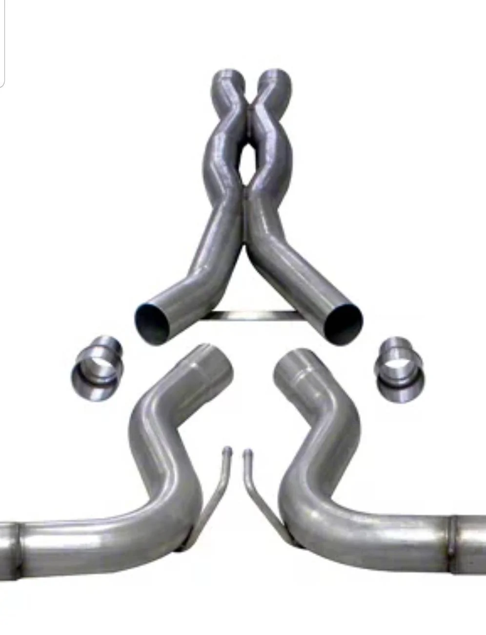

Doesn’t Corsa have a brace that is welded on at that particular spot (that’s the XX pipe, right?)? It looks like those welds failed and the brace fell off. That’s my guess. Corsa should cover that
This is the correct answer. Maybe corrosion weakened it enough it fell off, or a road debris strike ripped it out or some combo of both.
If Corsa won't replace it, take it to a shop and have a new brace welded in.

That looks way too uniform on both sides to be random. Something definitely happened in that area at some point.

Somewhere, on another car forum …
Question - I was following a mustang, heard a clunk, and now the aircon doesn’t work. Found this stuck in the rad, what is it ?
Answer - That looks just like a cross brace off a corsa exhaust …
