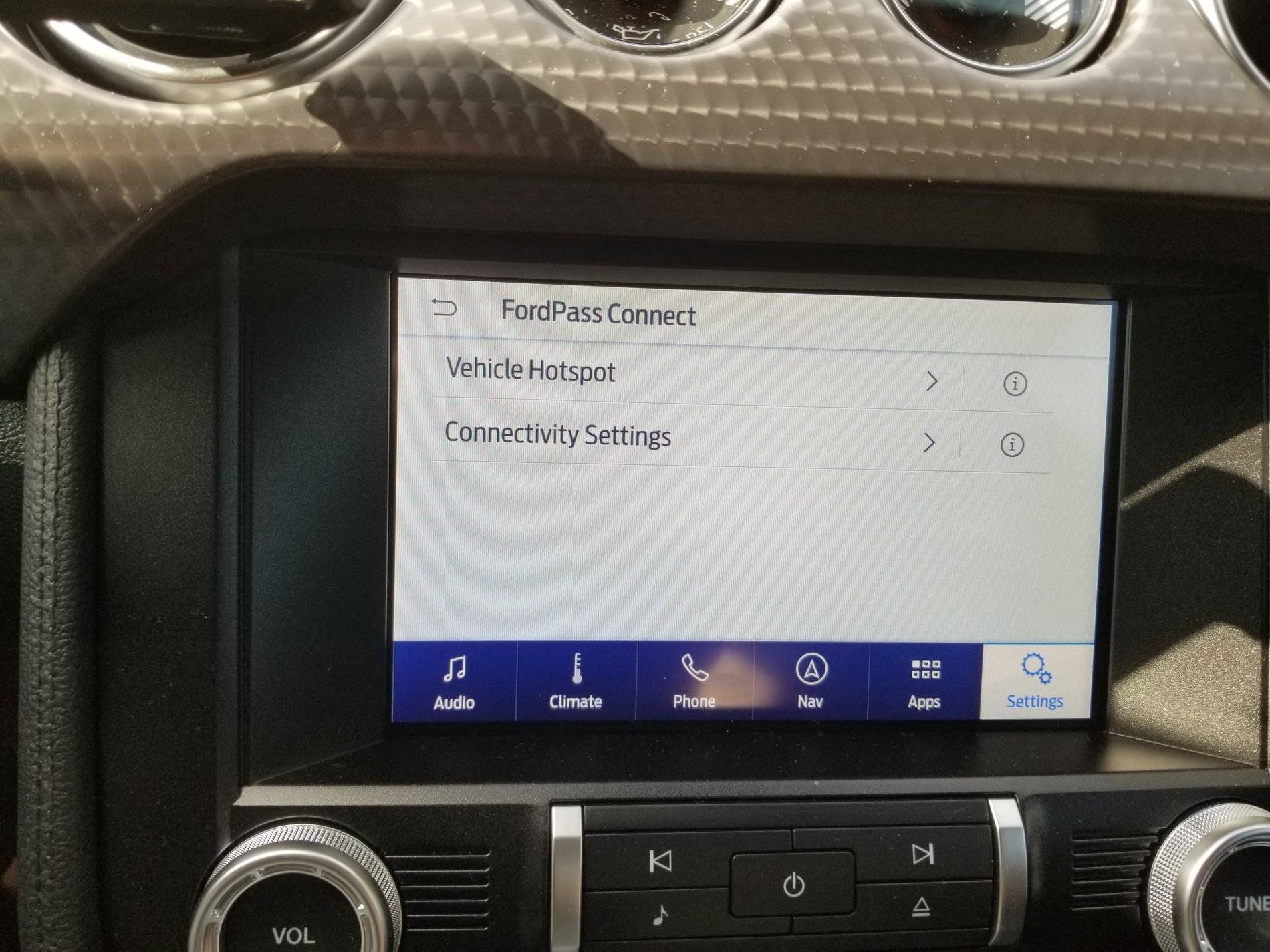

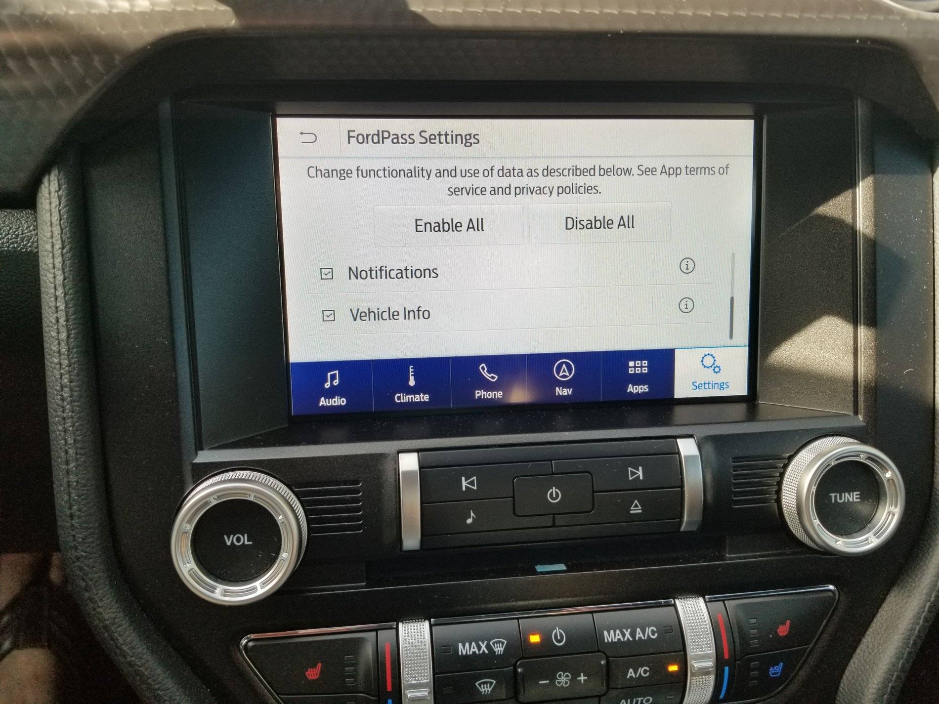

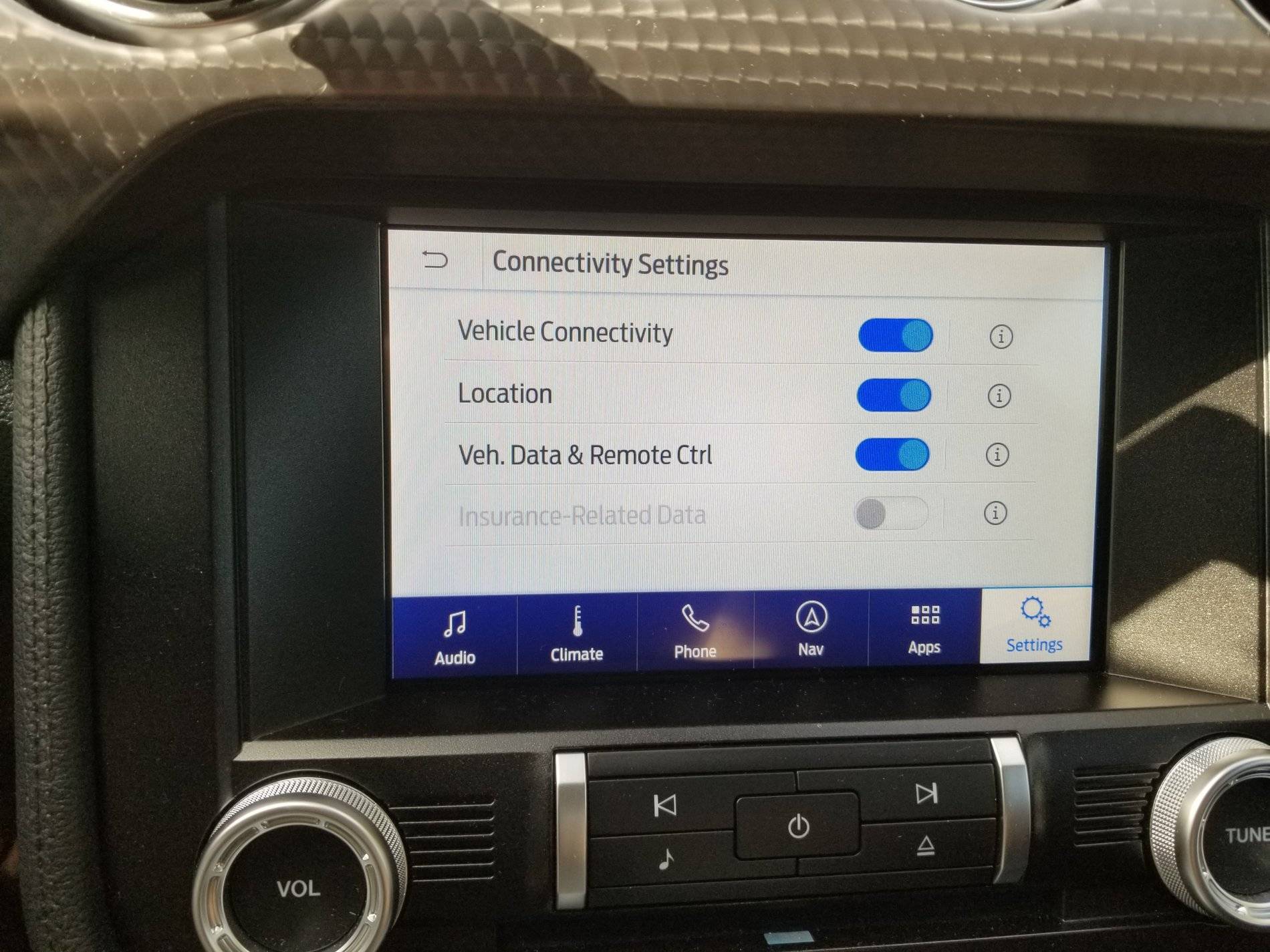

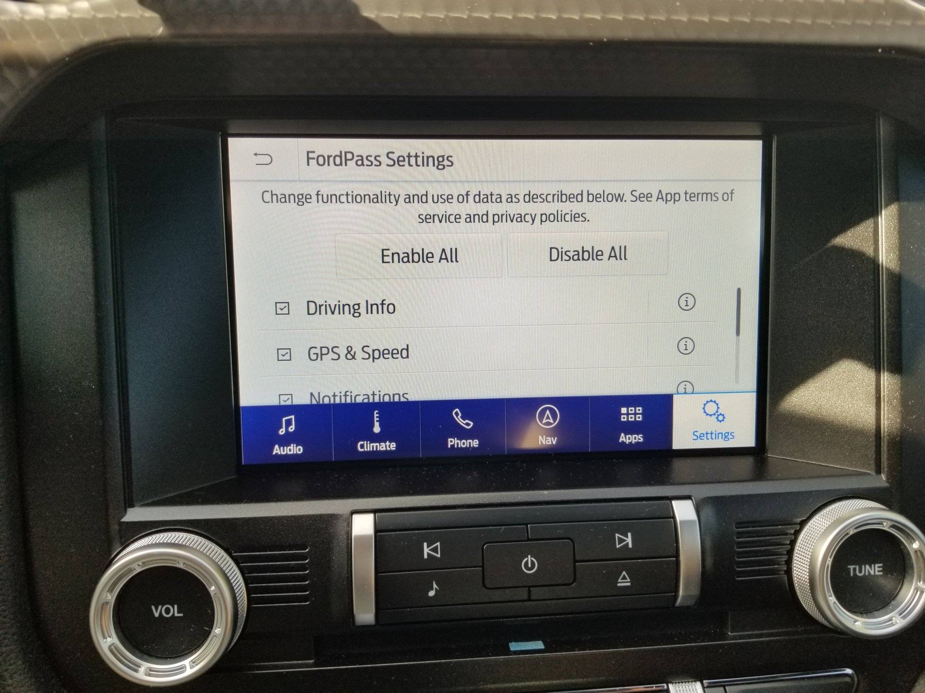

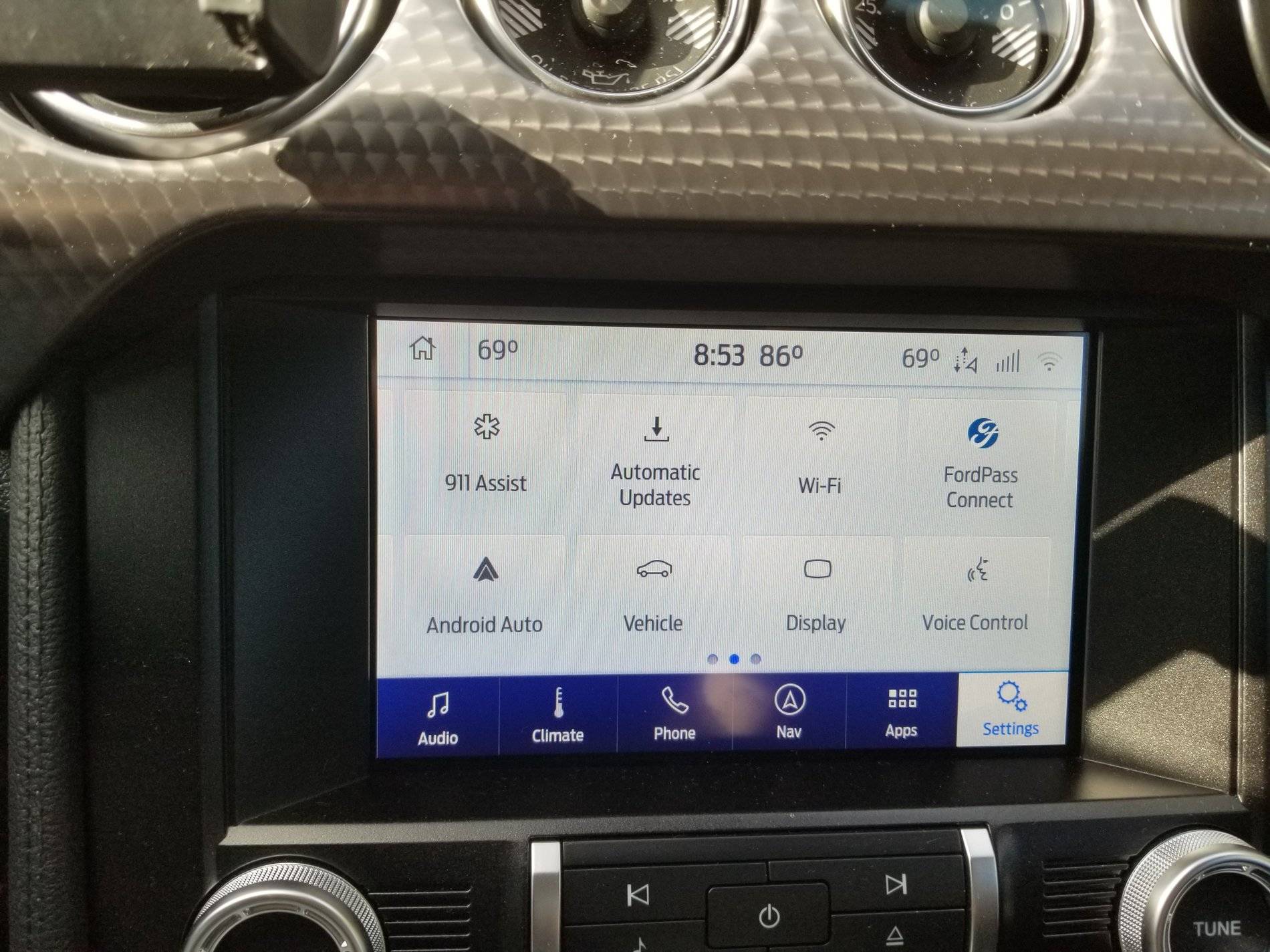

Sounds like FordPass no longer recognizes your car as having the modem. Check your WiFi setting in the car.
