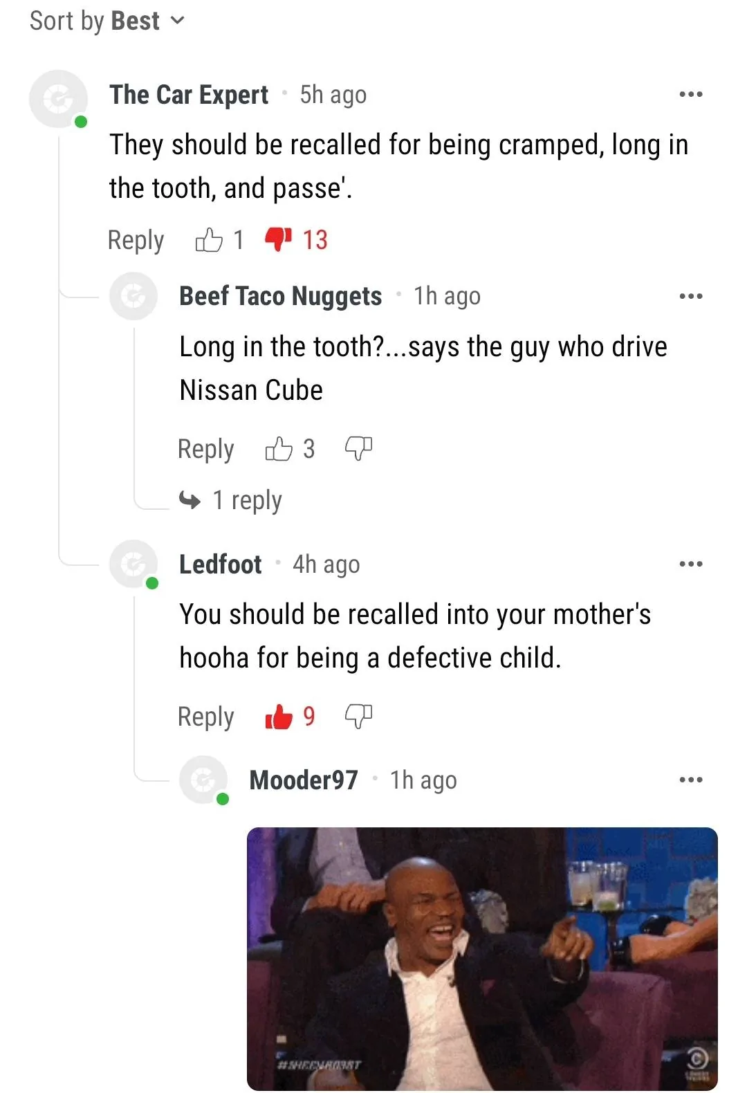

The idiot at Autoblog "The Car Expert" always dishes hate on Mustangs, but I gave it right back to him today.
