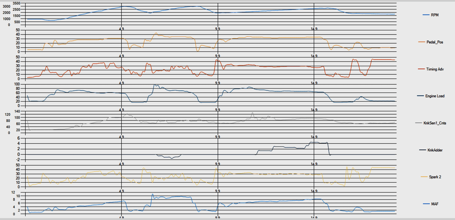

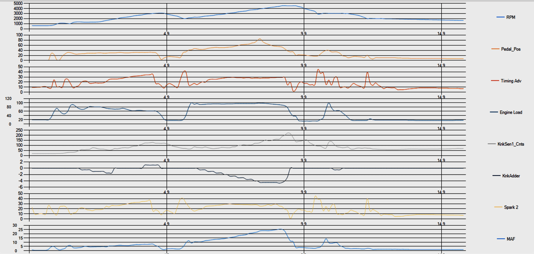

@ice445 Last night I had some time to go for a drive. But data collection was not the best. None of the streets where I live lead to "Mexico". The roads are always busy and I didn't have good opportunities to log and load the engine in the proper RPM range to induce the noise. I was either passing through the RPM range too fast or not able to dig in hard. I did manage to reproduce the noise in one situation on flat ground going from 2nd to 3rd. It was loud and it happened right at 2000rpm. Right at the point that I would hear the 2K rattle. I tried to hold it but the sound only lasts for 1 or 2 seconds and it's gone. Unfortunately I was not logging data at that time. The Procal sucks for data logs as you can't trigger it to start recording on a certain condition. If you start recording and just let it go, the data is too much and impossible to read. I only did 3 logs. My Procal will not do 4 successfully (maybe it's memory overflow related). My 3rd log was after octane boost and it got corrupted somehow and was unreadable. That figures. I was not able to induce the noise after the octane boost. I was also running out of time to try further test runs. So my results are inconclusive. I will take it out again tonight to see what happens with the octane adder in.
Here are some screen shots. Not sure what to make of these. KnkAdder never went above 5. Both pulls (1st one is uphill) that should have resulted in the audible knocking sound.
This doesn't behave like typical knock. I have driven cars with real knock and it's easy to hear under load at various RPMs. This noise sounds the same but is specific to a very narrow RPM range and does not continue. Is this related to the 2k rattle, or the dual clutch? Or is this a clearance issue with the exhaust or some other component?
K4fxd
Apr 2, 2020
122
13,495
12,325
NKY
Dan
2017 gt, 2002 FXDWG, 2008 C6,
Ford's PP tune is pretty aggressive in the 1500 to 2500 RPM range. I based my spark map off of it. I ended up reducing timing in that area due to knock retard, although I never heard any pinging or hammering.
The pp2 and gen 3 tunes are pretty different though.
@StangTime
I think that proves that the noise isn't ping. Try logging cam position, commanded versus actual. I get that the procal isn't ideal for logging. I personally use an obdlink mx+ with forscan lite on my phone. If I can figure out how to post that data without my computer I'll post mine up for comparison.
