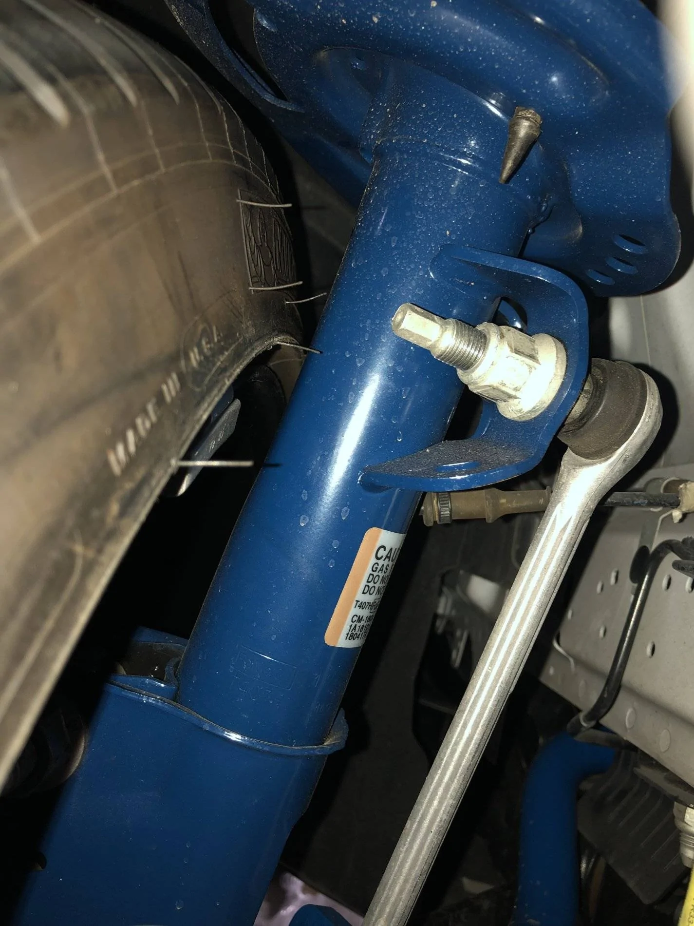

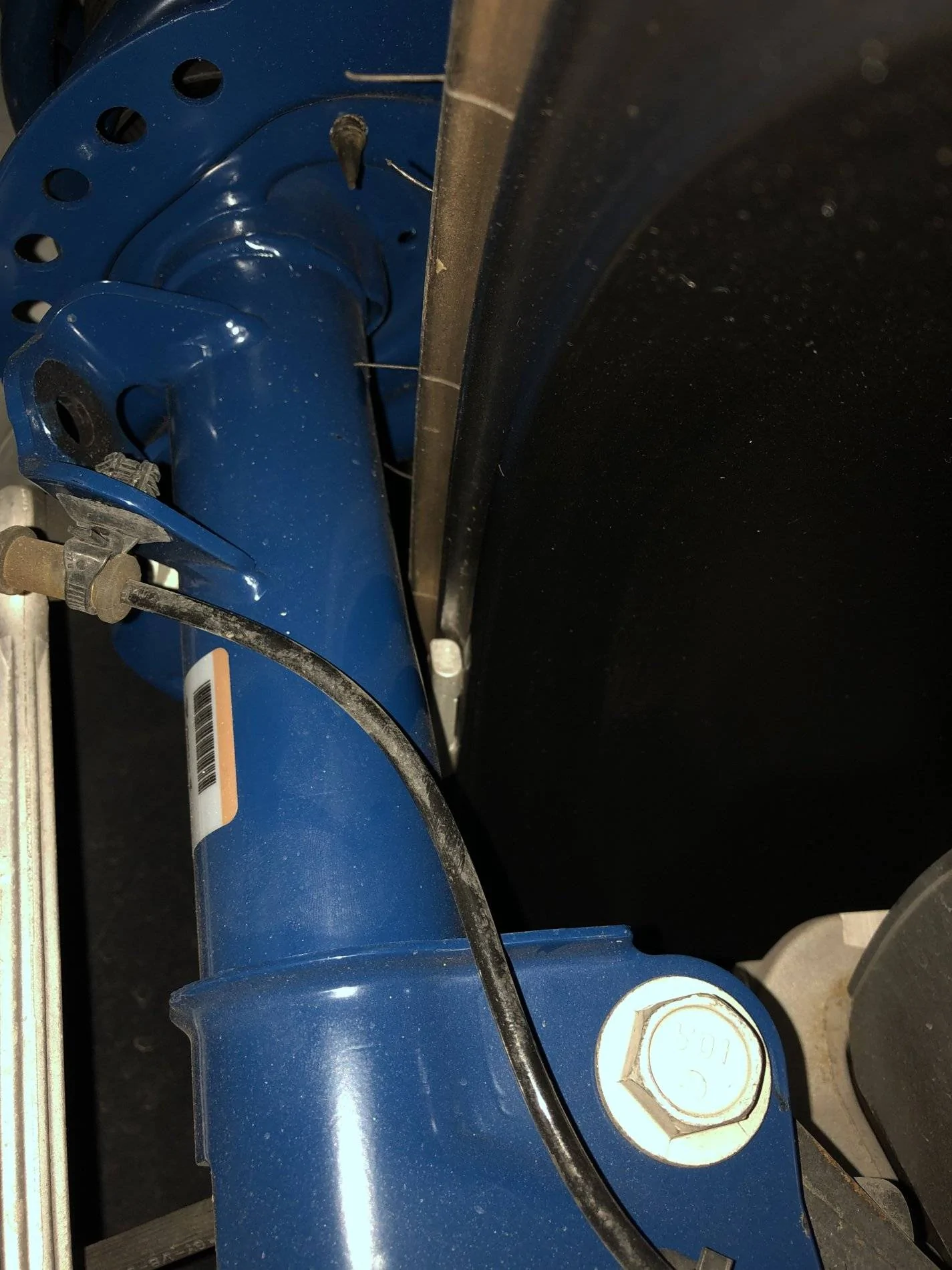

It’ll clear with the right wheel specs. A 295 fits well on a 10.5 wheel, but it takes some camber and the right offset to get a 10.5 to fit well on the front AND rear since you’re looking to go square. With the right offset, you’d have better luck with a 10” wheel. Most 295’s have very similar (if not the same) tread widths and section widths was their 285 counterparts, so fitment should be okay. But like I said, offset is key when running a tire that side on a 10” wheel. I have the Ford Performance track dampers and oem gt350 wheels. 19x10.5 +30 with 295/35’s. Front camber is at -1.7

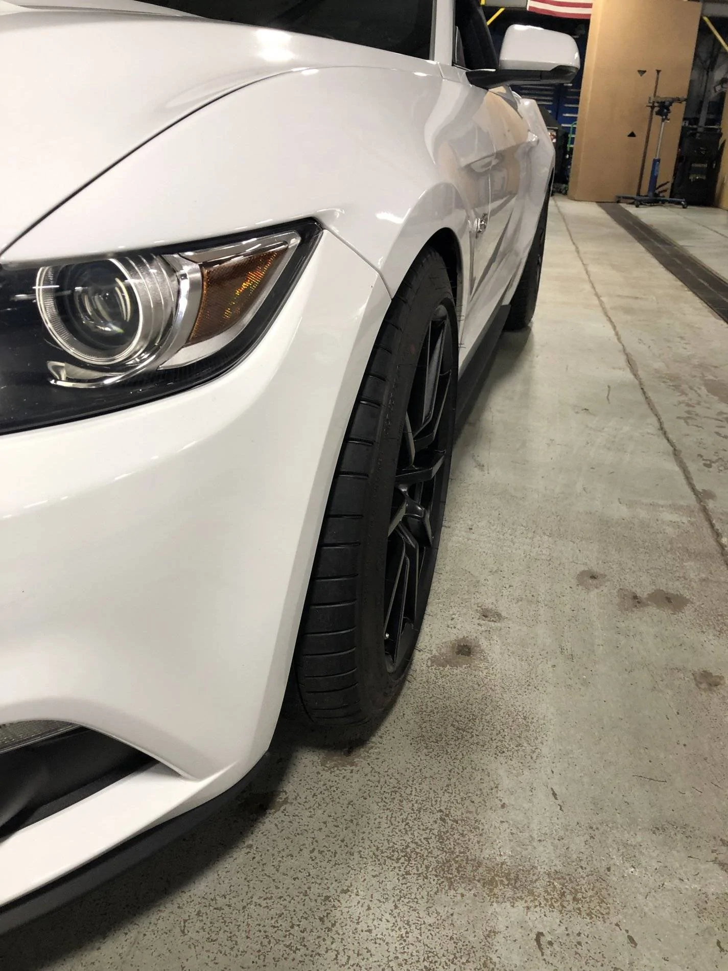

I'm 19x10.5 , 35 offset, running 285/35 , lowered on Steeda Progressive springs and stock PP shocks.
Clears with millimeters to spare between the tire and strut. Would not fit a 295/35 on my fronts, would rub for sure.
I like the 285's all around, the car feels very nimble on the street. I previously ran a 305/30 on a 19x10.5 fronts, and the steering was a pig at low speeds.

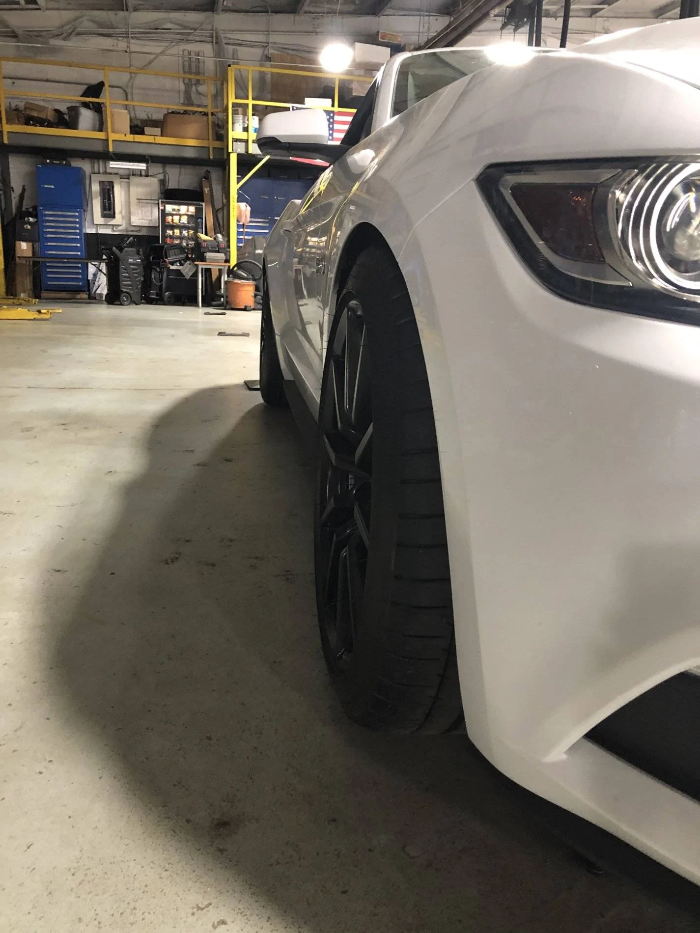

Sorry for the delay. I too am running a 19x10.5 +35 square setup, 17' Performance Pack car. 285/35 Firehawk 500's. Havent got the car on a road course yet (this upcoming summer) but I am happy with the results. No rubbing front or back. I chose this specific size since the wheel design was more important to me than more rubber in the rear, but you can tell I "waste" a lot of rear space to have this stance. But my goal was stance/looks and not outright traction.
