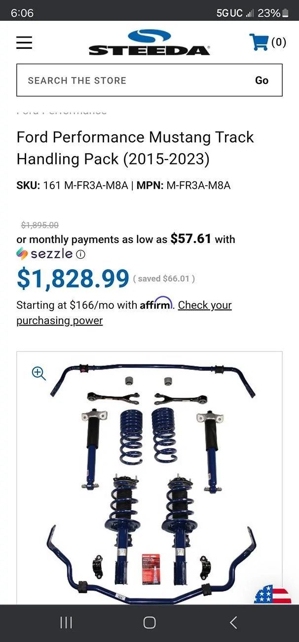

Currently have a 21 GT with the Ford performance track handling pack and 20s. I'm thinking of going down to 19s to fit thicker tires. Anyone have pictures of a 3rd gen on 19s with the Ford performance track handling pack ? Specifically the wheel well gap? (Side note should have went with the sport lines)

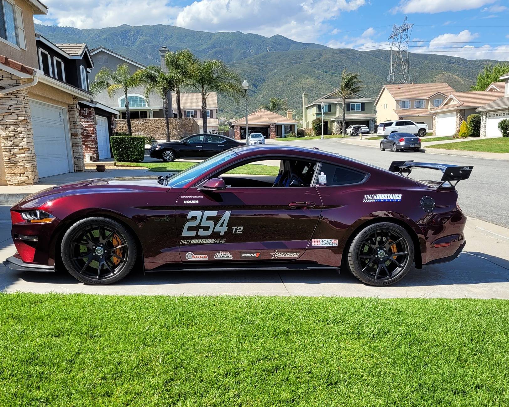

here is mine with 305/30-19 with 19x10.5 wheels front and 315/30-19 with 19x11 wheels rear

And that's lowered with the Ford performance track handling pack? My only concern with dropping wheel size is it will increase the gap in between the top of the tire and wheel well . Also is that a pp2 car ? I was told that 11 inch wide won't fit the front of my non pp2 GT . Is that why you went with the 10.5 ? Also good to know 300 series tired fit a 10.5 . Sorry for all the questions man . P.s your track car looks pretty cool

I do have the F/P track set up with Steeda adj sway bars. I run with a 1" longer studs and a 5mm slip on spacers on the front. This gave me just enough tire to strut clearance. I also am running 1/4" Steeda spring spacers in the rear to give the car a slight rake. Here is a view from the side.

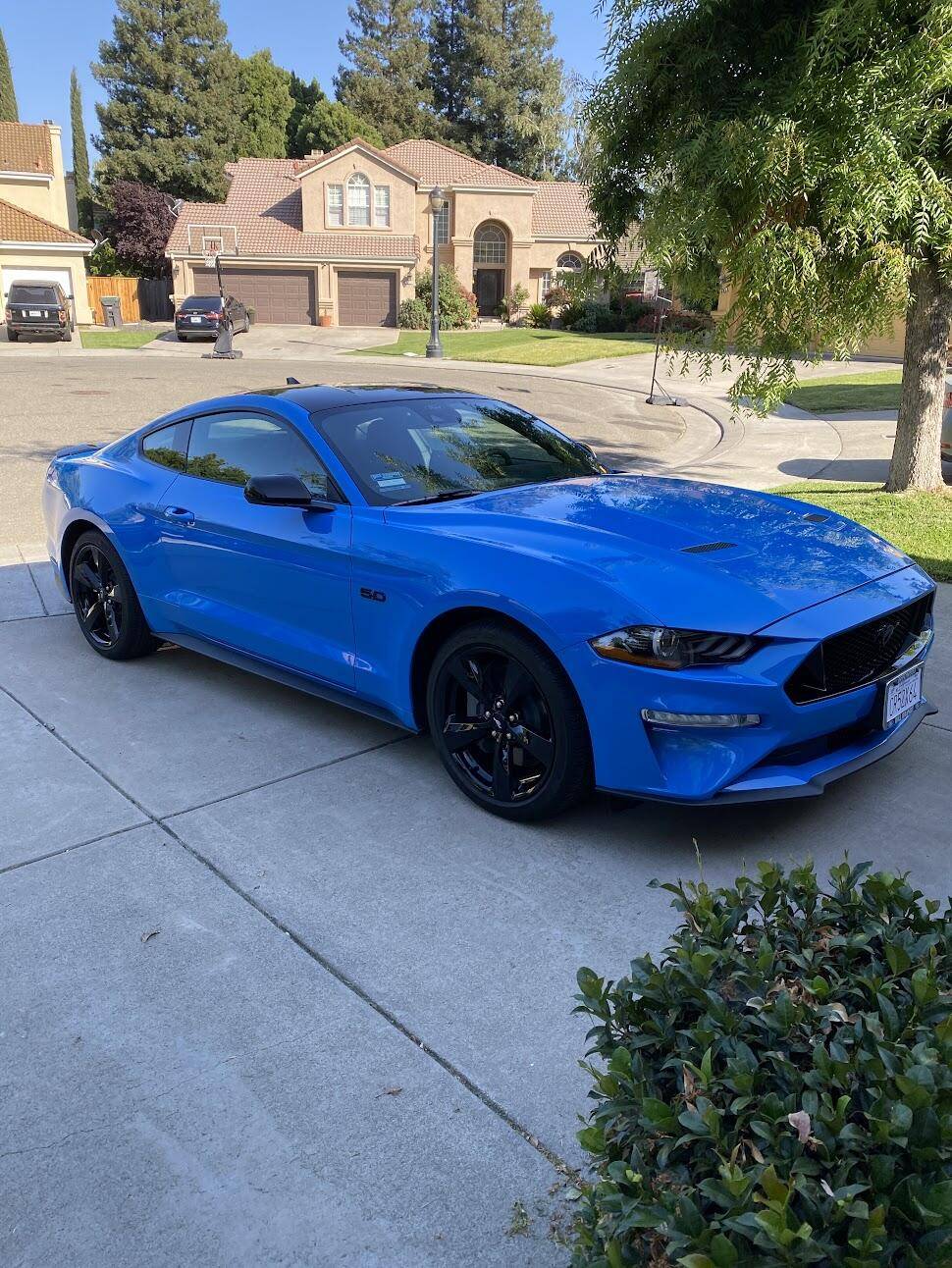

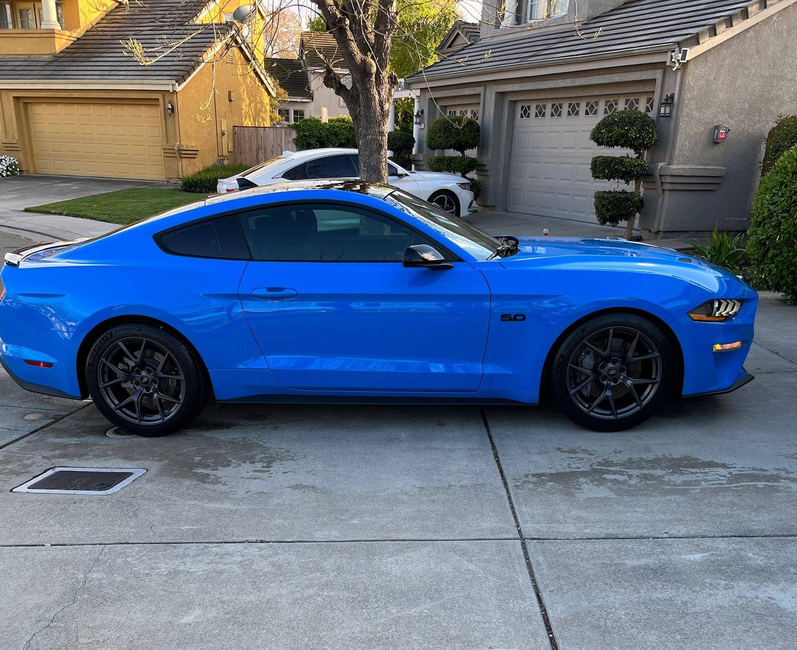

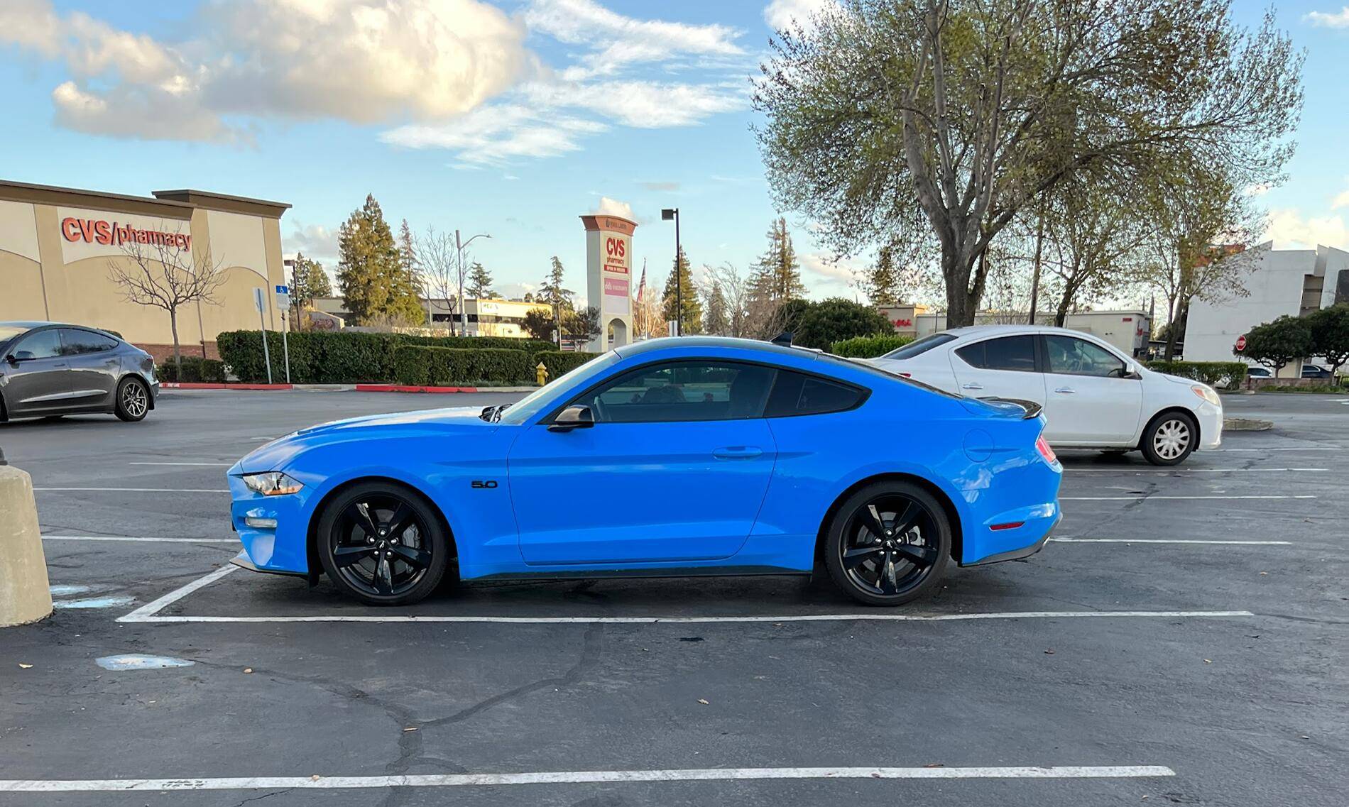

before and after on stock 255/40r19 8.5" wheels
After on 275/40r19s, SVE SP2 (PP2 clone) 19x10s.
Disagree with you the sportlines, too much lowering imo. The FP track kit don't have to worry about suspension geometry or scraping everywhere you go since it's not low enough to make a difference, but low enough that it looks much much better.
