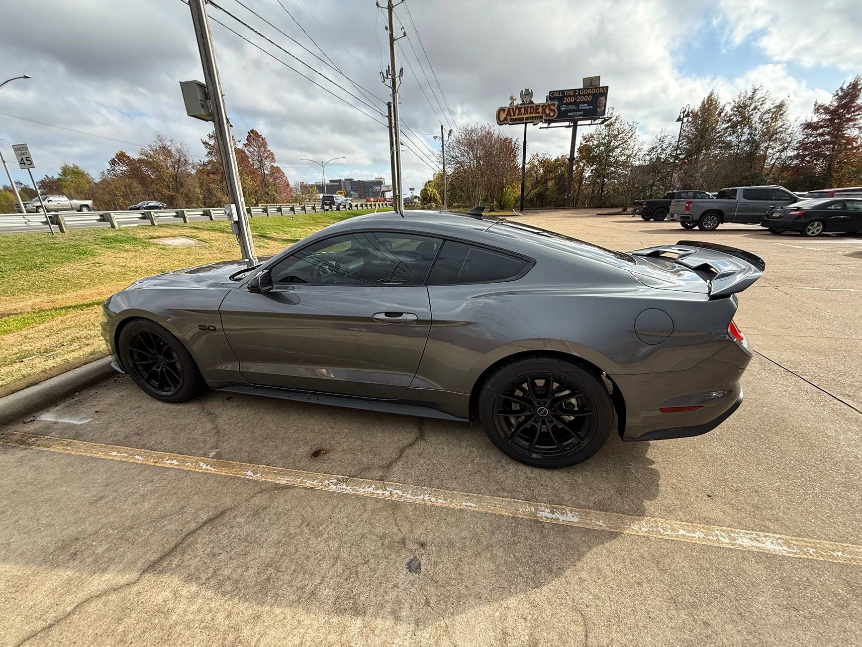

Ford performance track handling pack on 19s
MidwayJ
Sep 9, 2018
1,899
2,909
Dallas, Texas
Jay
2019 Mustang GT Coupe
Not factory. An add on. I think much of what is there is included in the PP1 and 2
Not sure about the PP2 but this is definitely an upgrade from the PP1 bits.
Yes it's an add on . You missed the point . I wanted to see what 19s looked like with that kit . I currently have 20s with this kit wheel well spacing is perfect but can't fit fat boy tires. Wanted to see the difference in wheel well gap with 19s

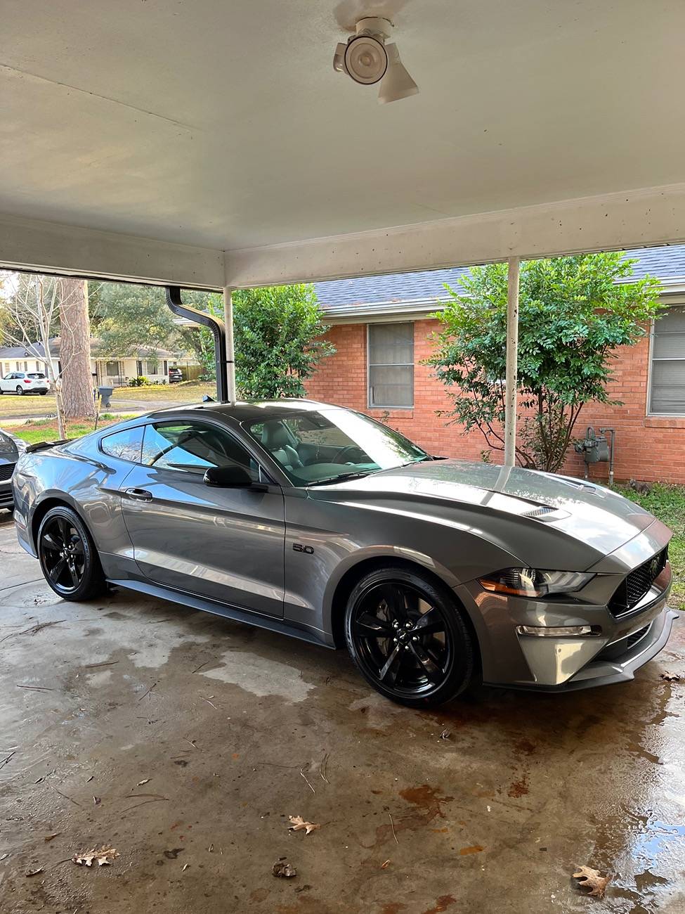

Just wanted to see wheel gap with that kit and 19s. I have that kit on my 21 but I have 20s. Wanted to see how much more of a wheel gap there was with one size smaller rims
