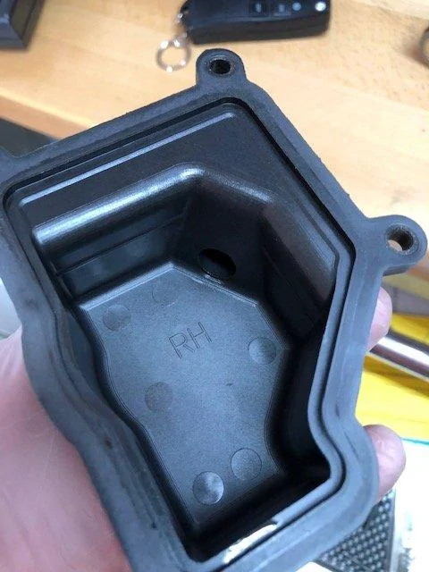

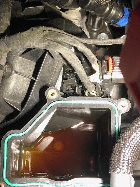

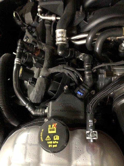

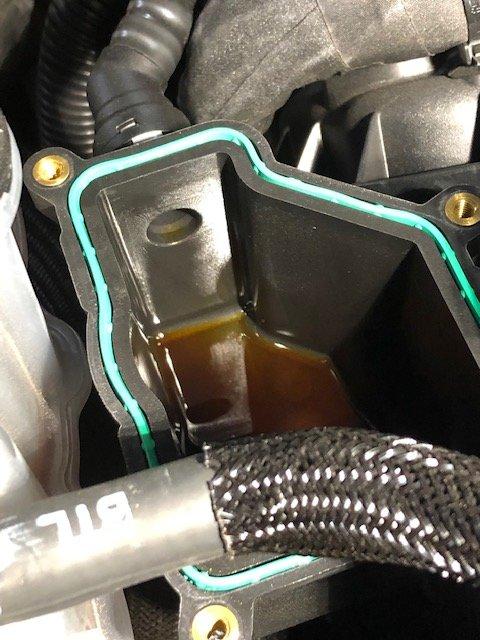

Thought I would share how the oil separators have been doing since installing them about 750 miles ago. They work very well.
In the attached photos, these mainly are of the passenger side, as there has been nothing in the driver side, which is great.
Again the oil seen in the pictures is after 750 miles, city and highway 70-75 mph range driving, and some high rev playing. You definitely want to get a seperator on the passenger side, wish I had done this in the first couple of hundred miles.... currently 3700 miles.
The one picture is of the top half of the separator with the filter out....dry, no oil film to the touch.This filter screen works great.

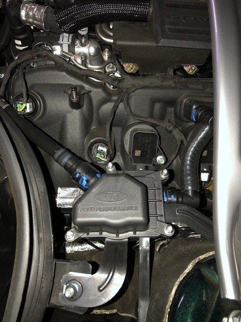

The driver side is the GT 350 model with slight modification to the connection to the bank. Actually going to get two 45 deg angle connectors next week and make that even better looking.

The passenger side is plug and play ... but does require some minor installation of the bracket that holds the separator. Nothing to intense.
You could do it without installing the bracket and would just hang like the JLT, I would think.

The drivers side will require a slight modification of the connection from the separator to the driver bank. This is because the tube is designed for the GT350 right bank which has the connection in a different spot.
I used 5/8 tubing with the original connections I took off the GT350 tube. Fits the Bullitt because we have the GT350 cold air intake setup. Look at the installation PDF.

My only concern with this is performance on inclines. As the bottom appears wide but not deep, I am wondering if you would have issues with oil pulling on steep inclines (20-30*).

Good thought, I thought about that as well, but did not see a real issue due to its size and location of the inlet from the bottom of the reservoir . I believe it can hold about 6.25 ounces to just below the inlet bottom.
I will never let it get even close to the that, as I am use to checking my oil seperator on the F-150 frequently ....man you should see the stuff that UPR collects... especially in the winter.... crazy.
I guess any of them, JLP 3.0 and others with smaller capacity could run into the same condition, if the right circumstances occurred, meaning can rather full and a decent angle.
I will take a photo of the inlet from a angle you can see its height better tomorrow.

Thank you. I just thought about it today when pulling into a sonic. Side note - why do all new Sonics have insane inclines?

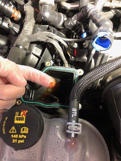

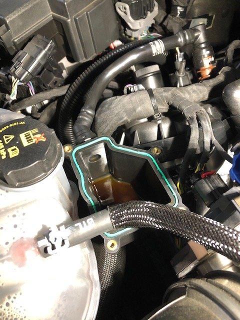

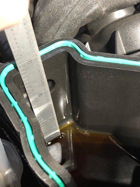

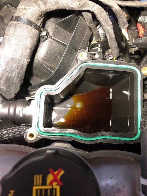

Here are the photos showing things a little better. Hope these help. amount in there is 1k miles worth.
About 1\4 oz. or so.

Thank you. This makes me more comfortable about my order.
