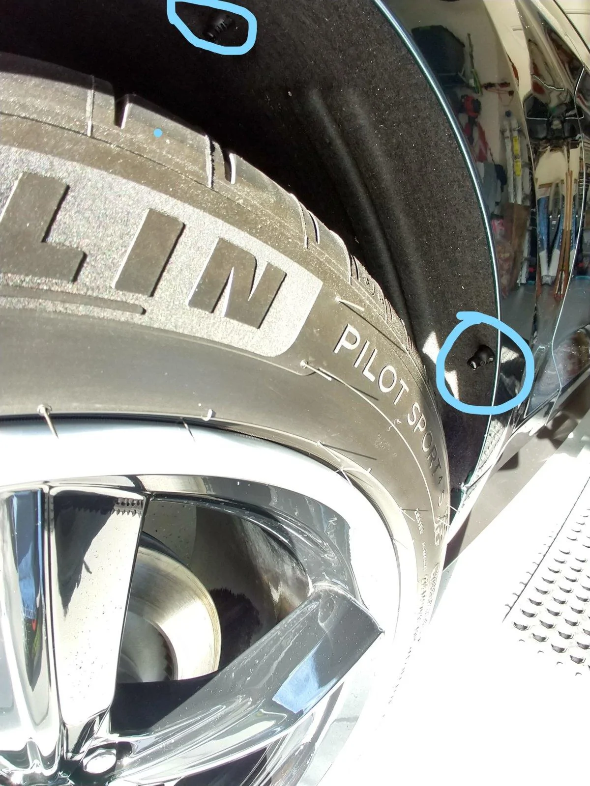

I just happened to check under the rear fender well and noticed most of the end caps that hold the fender liner on were loose. I would advise checking both sides! Not sure they will stay on forever.

Yes those seem to be loose on all S550’s. I found the same to be true on my prior 2016 and on my current 2018.
If they are loose, some may find they have miraculously silenced rear “squeaks” by tightening them up.
