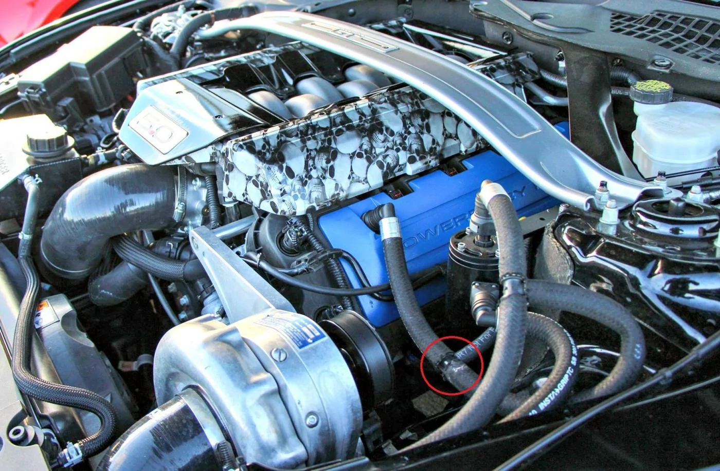

Beating a dead horse....if you have the N/A setup and go supercharged, you just need more line? I looked at the Procharger diagram, and it looks like the driver and pass side come together with a t fitting, and then to the catch can. Then catch can to intake tube. Would we just buy more line, cut the dirty line to accept the t, and maybe extend it if needed?
62ecoboost
Nov 21, 2016
93063
62 Ford Falcon
Here's a moroso installed with a procharger. We removed the the CMCV's and put the MMR lockouts in. The passenger hose was ran around the rear and t'd to the drivers side then to the OCC and the inlet
