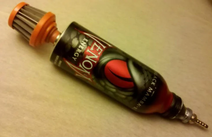

Google searched and this was one of many. Kinda LOL, but kinda not. I know next to nothing about catch cans, but will eventually, so I don't even know if this one would work, can only guess yes. Guessing the big size is for big 4x4 guys that bounce around on rocks more.
Under $15.
http://www.pirate4x4.com/forum/gene...ass-mostly-aluminum-catch-can-under-15-a.html

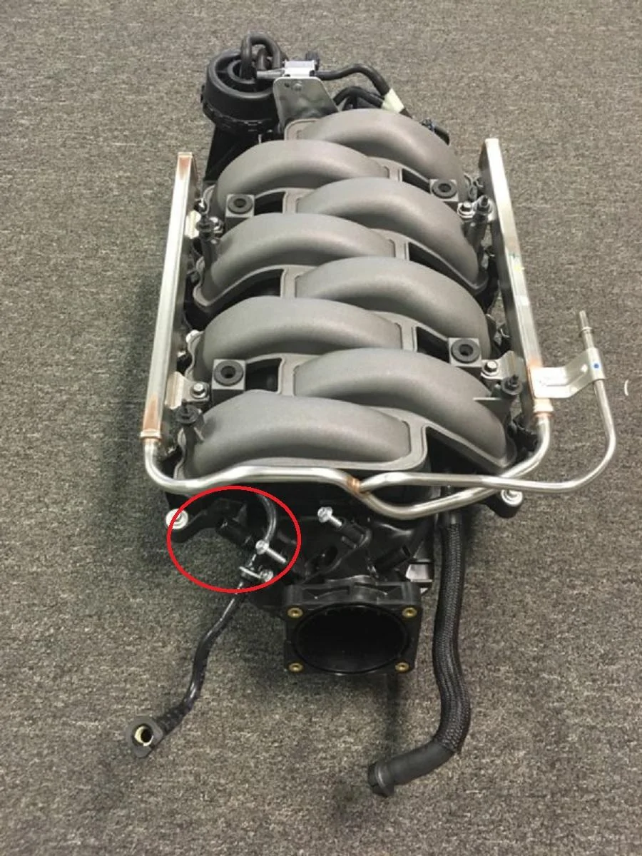

Hey, can someone comment on that diagram. I'm going ProCharger also and see reference in the diagram to the clean side getting blocked off. What's that about?
Circled in pic. Its where your clean line connected when NA. need to plug closed so you dont have a boost leak. I used a piece of hose with a plug in it. When i first got car running I was having issues...blew the hose off two times from going into boost. Gotta tighten everything down on boost applications twice as hard.
Hey, thanks man for the info. I'm all new to this. I was going through my ProCharger kit making sure I have everything the other night. I remember seeing a plug and wondering what it was for. Thanks again for the explaination.
Are you sure that wasn't the firewall plug for removing the sound (air) tube?
