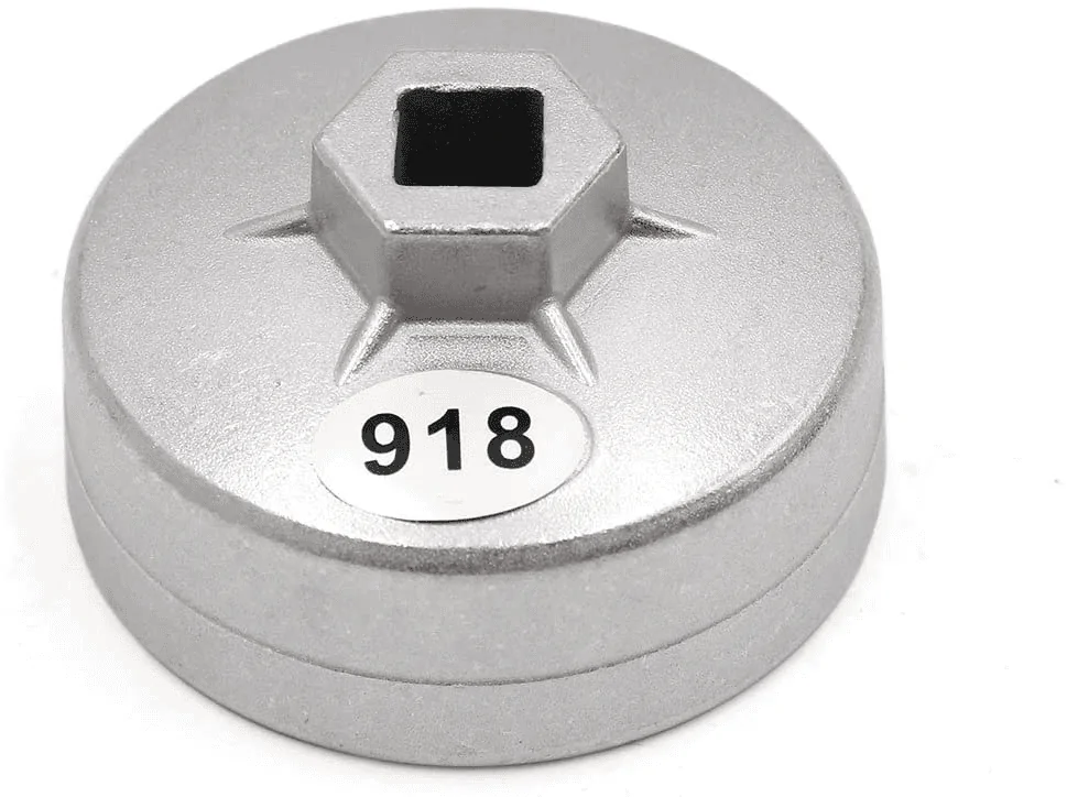

so common...have had this happen on several new cars. The best way to remove, with the most torque is an end cap filter wrench that allows you to put either a 3/8 or 1/2 inch rachet on the end of it it. I have a Lisle kit with several different sizes. this has never failed me. When I got my first Hellcat so many people complained about how difficult it was to get the filter off the 1st time...with my Lisle end cap wrench, it came off with ease. Not sure of the size you need for your car, just go to the auto parts store and match up a new filter with a cap wrench.

do you think this would work?
https://www.amazon.com/Lisle-63830-...ds=Lisle+end+cap+wrench&qid=1624757203&sr=8-6
was at pep boys earlier and thats where I got the strap wrench from they didn't have anything else.
I've used this or one just like it. Bought it at Pepboys. Not sure if they still sell it, but it works for both loosening and tightening. Have to be careful on the tightening though as you can way over do it. I hand tighten, then mark with a sharpie before using it so I know how much I have tightened it.

I use the 74mm ID X 15 flute oil filter removal tool.
