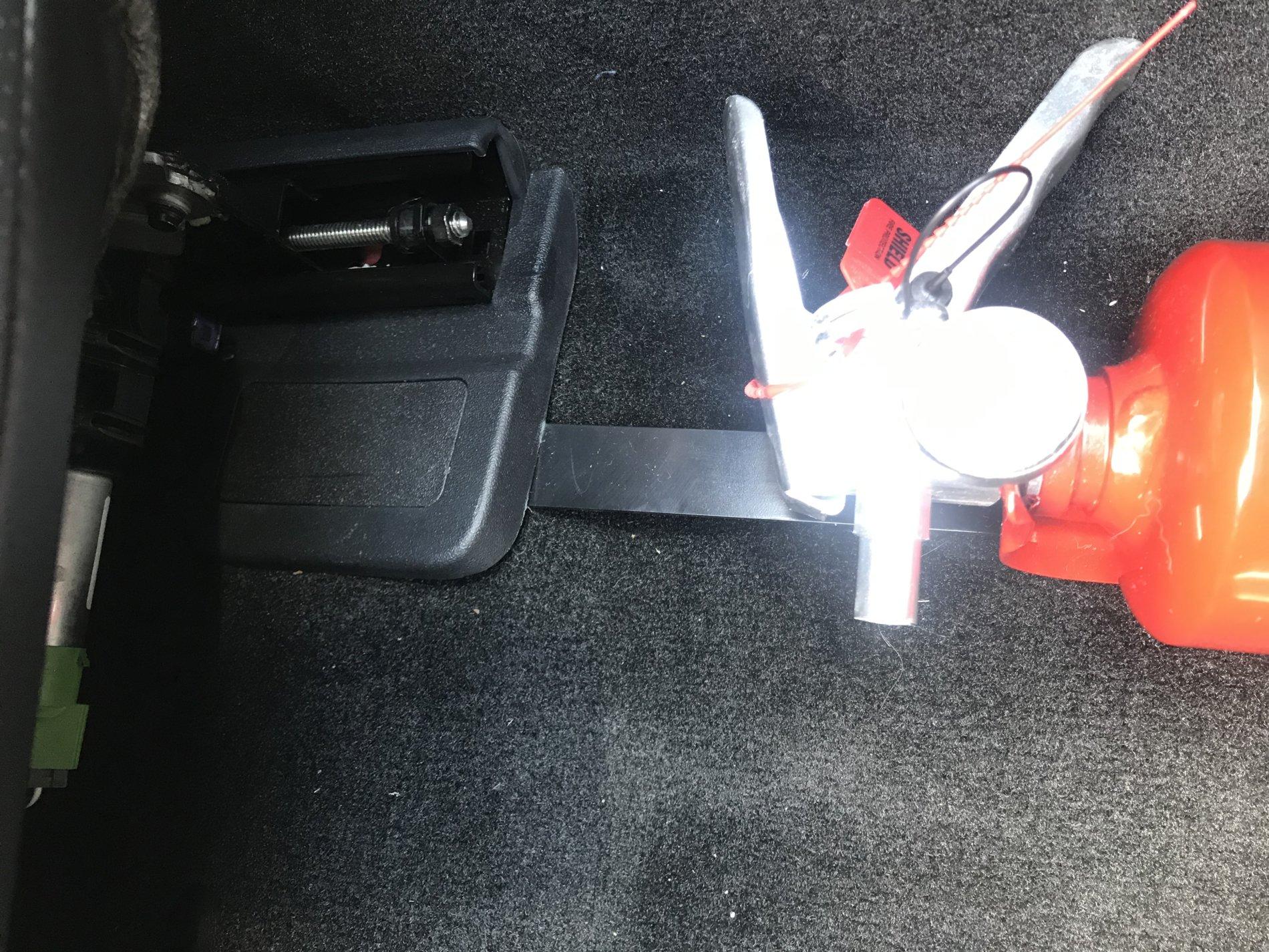

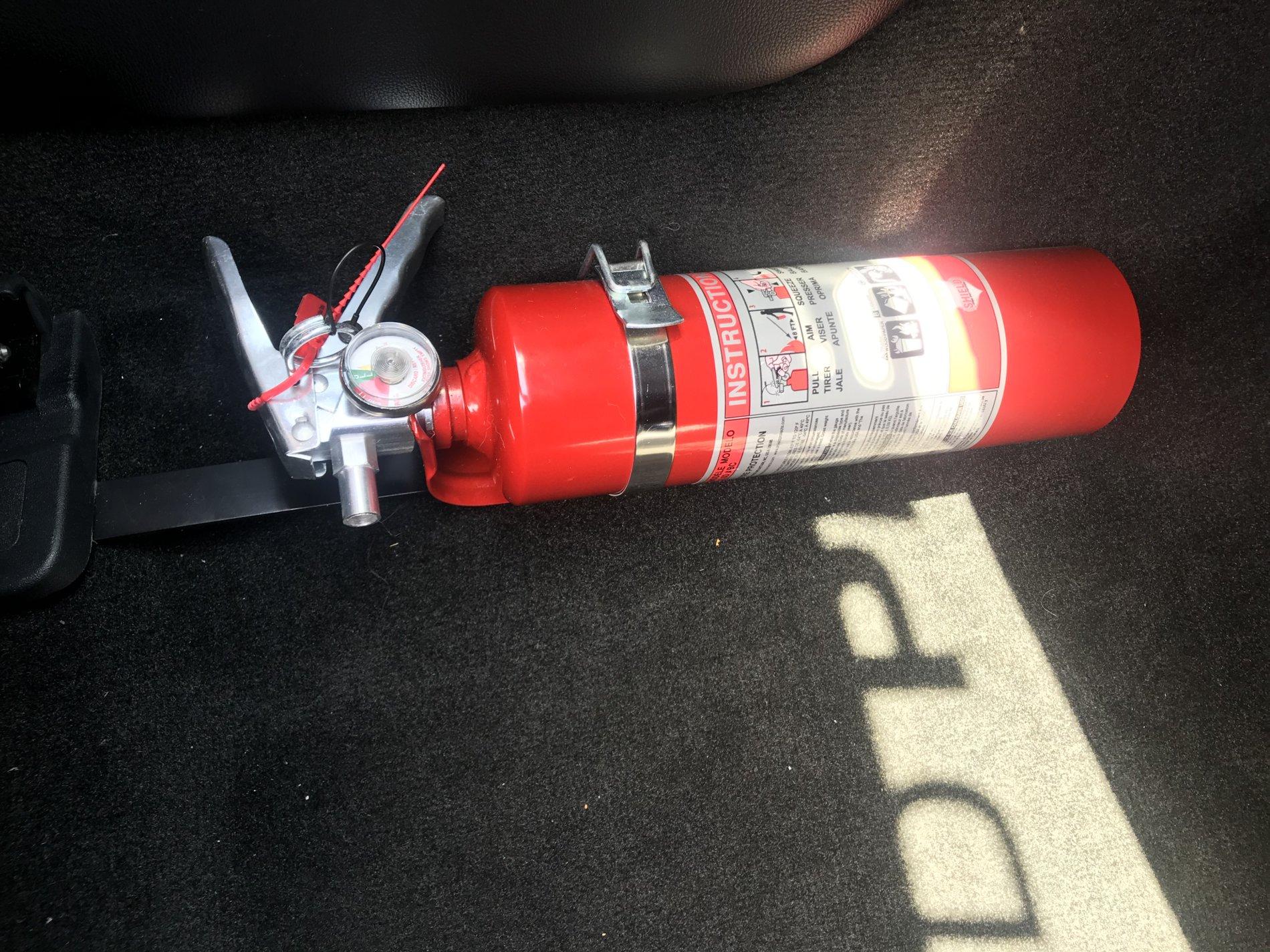

I used a piece of strap steel and mounted it to the inside front passenger seat bolt and it lays along the transmission tunnel. Cost about $10 and it doesn't move around at all and I can get to it fairly easily. I'll try to dig up a pic or grab one this evening.

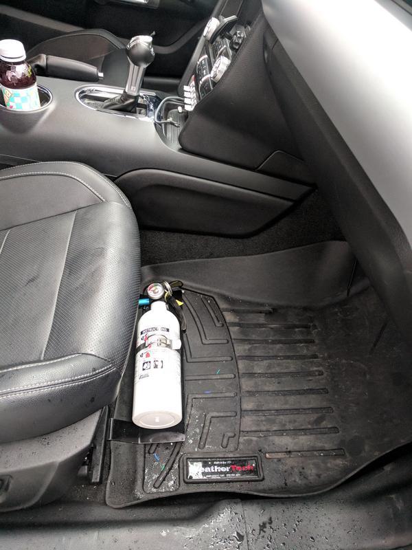

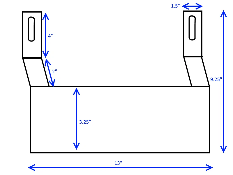

Mine doesnt move with the seat, but this is what I made. Pre-made ones were over $100, I made this out of an old street sign lol.

Mine was simple and cheap and it doesn’t move around.

That doesn't look secure at all... Maybe it doesn't move during cornering, but during a crash you don't want that to be a projectile. Is it held only to the seat by only that thin sheet steel??

I don’t think it’s going anywhere personally but if you are just tie it into the other front seat bolt like someone did above.
