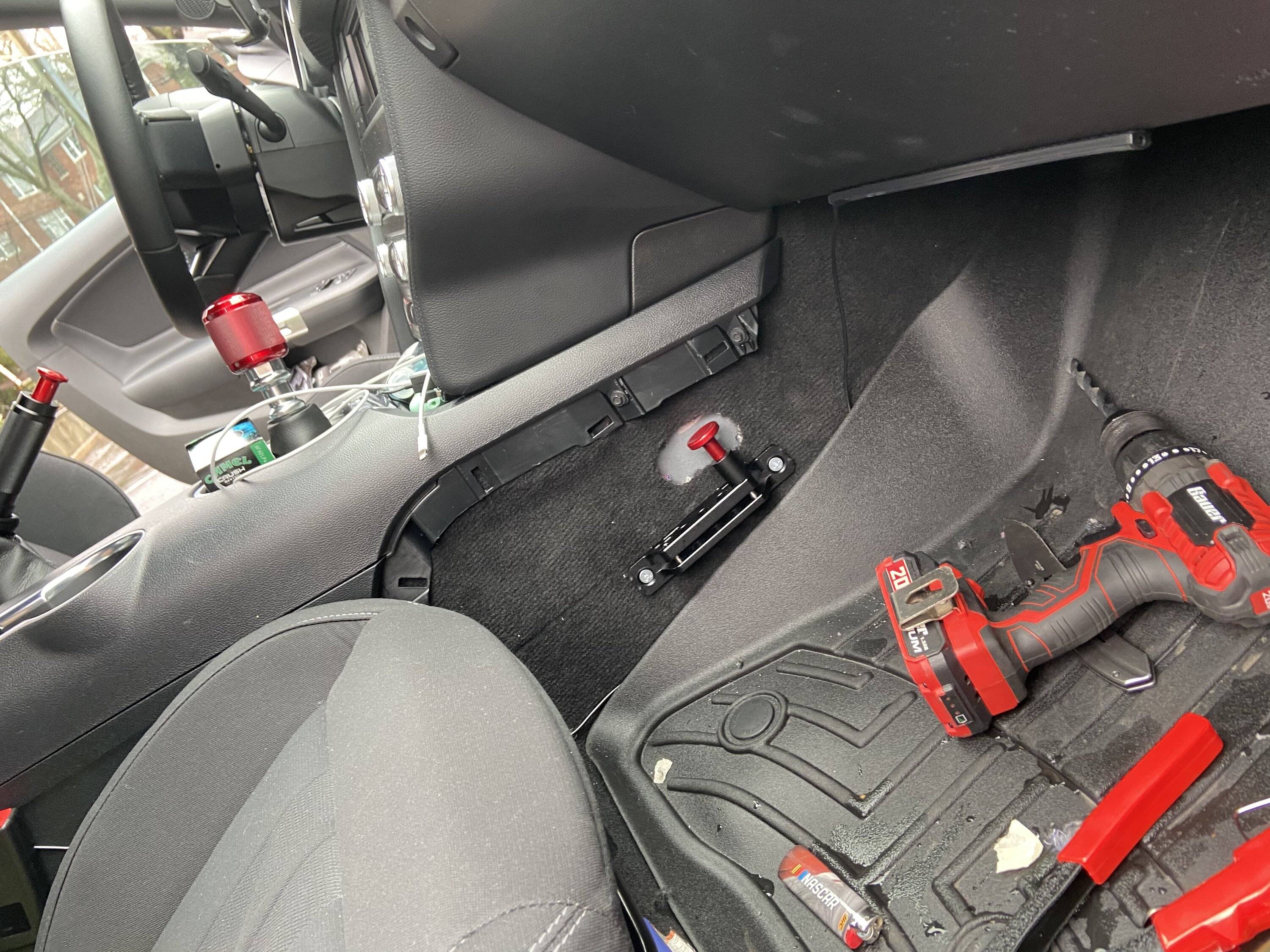

That’s a good mount and location. Do you think if the kick panel was removed and provisioned with bolt holes for the mount, would the mount still work or would longer bolts be needed?
Yup. I think that’s what he ended up doing

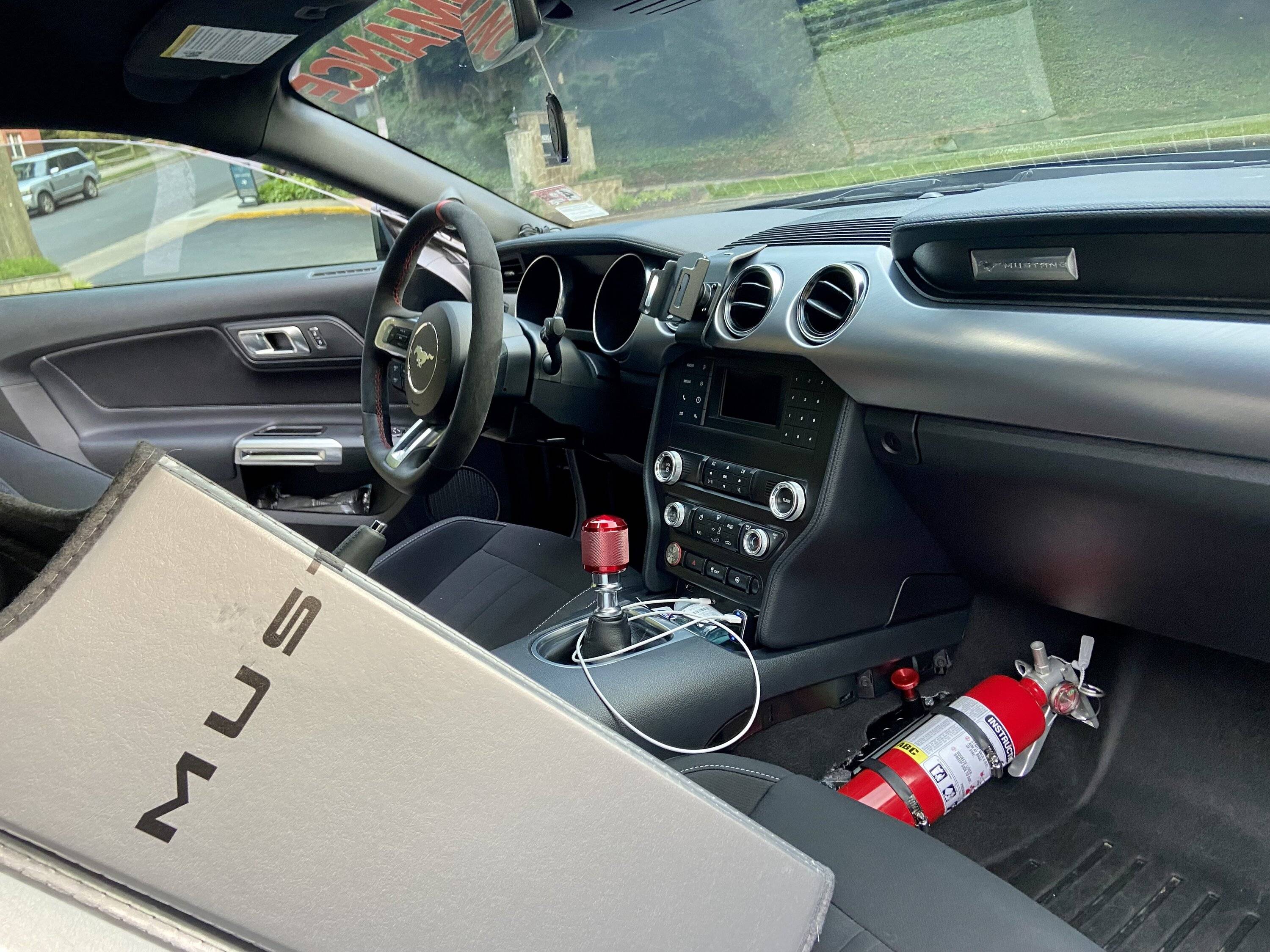

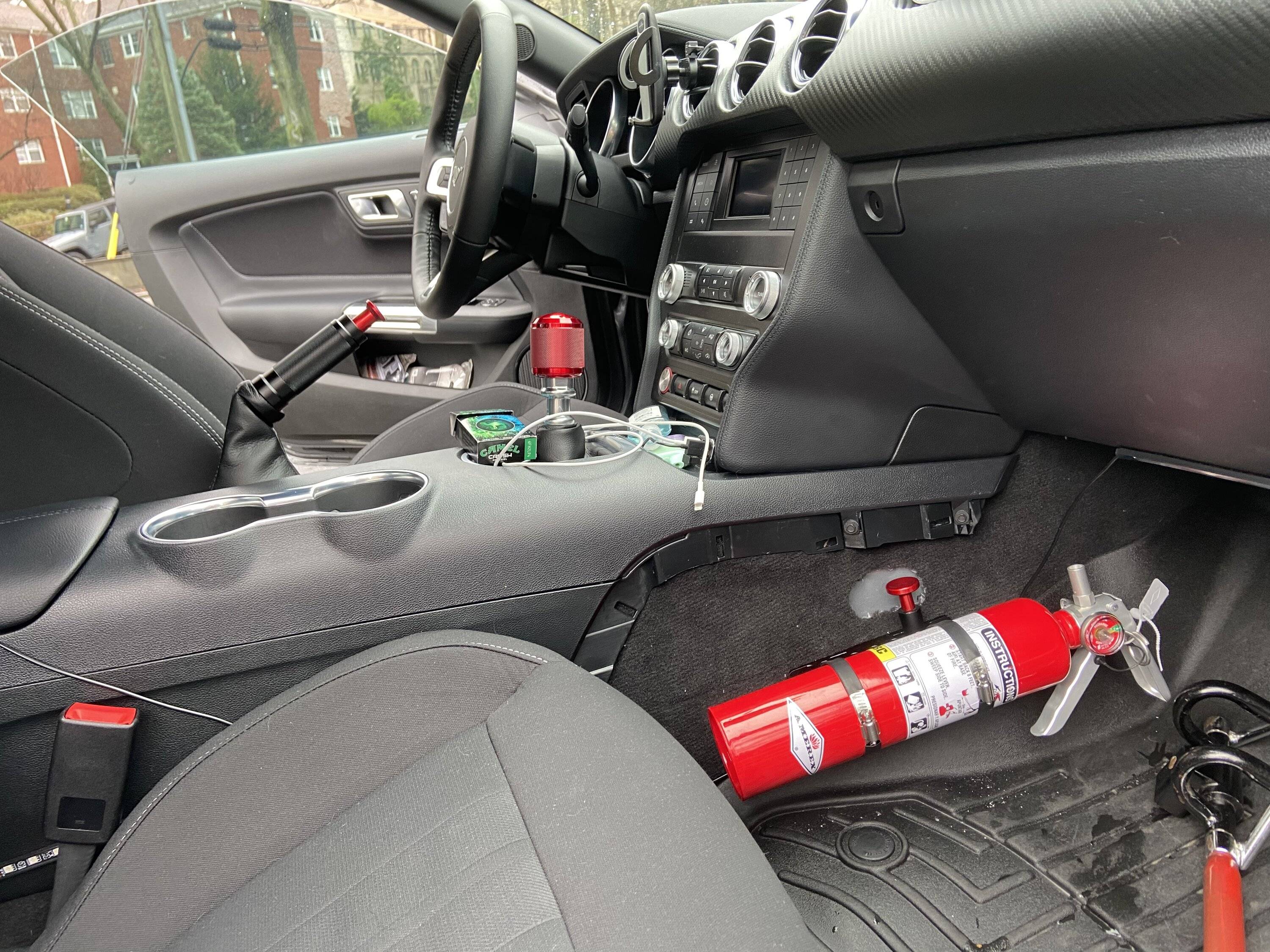

not sure what your question means but I just got mine installed and it worked great, seat has full range of motion

Does the plastic panel fit back on with the mount there?

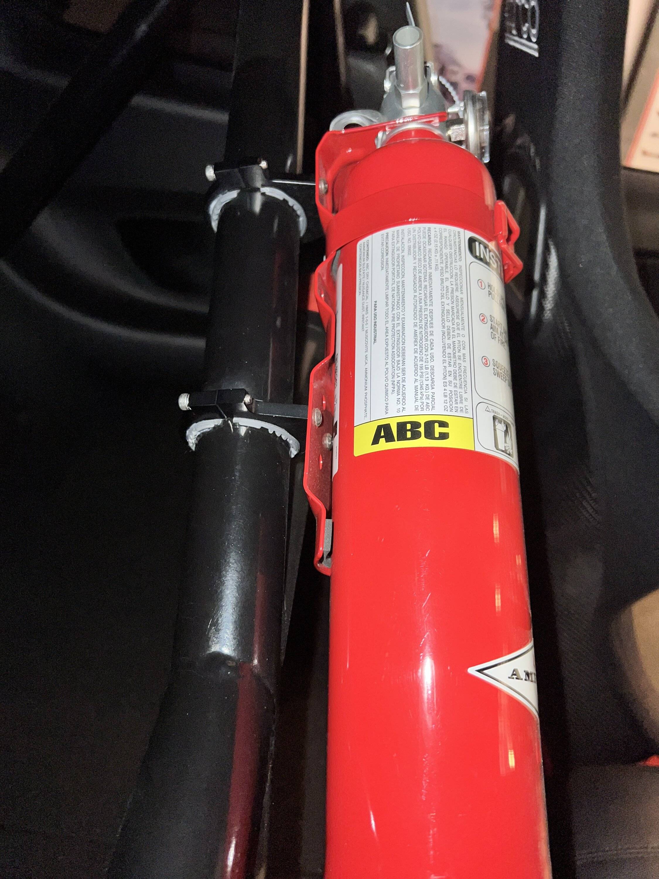

I just went with a simple $10 mount found at any racing shop. I got mine at Wine Country Motorsports at Sonoma Raceway. They also have shops in Colorado and at Sebring, FL.
are you talking about the trim panel? not unless you cut an opening in it, but I just left it raw
Yea that is what I was asking.. hmm.. alright, thanks. I want to put one there but I would want the panel back on, I will figure something out.

it's doable, you'd just have to cut out the opening of the bracket in the panel and add washers to both screws to make clearance for the pull button

not all of us have roll cages :crazy:
We’ll if your doing stuff in your car that you feel a fire bottle is necessary then I’d consider a roll cage:crazy::crackup:
