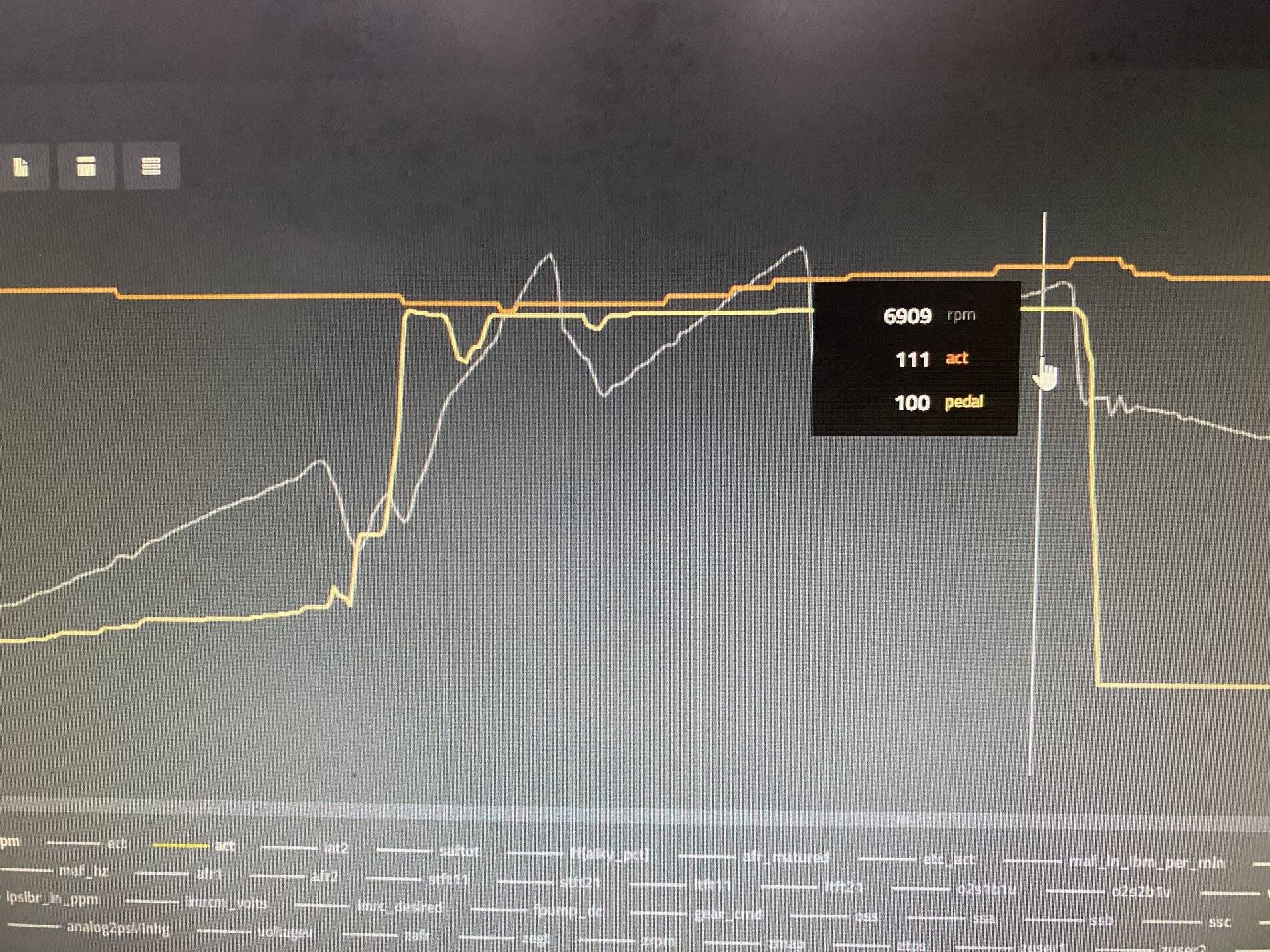

Centrif/Air to air can not possibly remove heat as quickly from the charge air because air is not a great heat transfer media. 109 is very respectable and only about 30 deg over ambient at the end of the pass. This indicates an adequately sized air to air intercooler. Iat2 starts at 77 and ends at 109.

ill wait for actual comparable data in 1500-2000 DA 1/4 mile pass. Theres a reason why most S550s running PD blowers down here run an ice tank or simply dont go as fast as a little centrifugal.

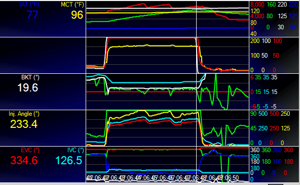

Attached is a log from yesterday, 15 minutes into my commute. This is a Whipple that does not have the upgraded LTR or fans. Conditions are similar to the log you posted, with IAT1 being 75 deg. The attached data is the 2nd WOT pull on the drive. IAT2 (MCT) started at 94 (as I mentioned, by this time the water was warm, keeping IAT2 hotter than ambient), but only increased to 96 deg at the end of the WOT pull. And, you can see the IAT2/MCT trend is flat. The behavior vs air/air is exactly as I would expect.
I even suspected the MCT transfer function was incorrect due to favorable MCT readings, so I went as far as testing the MCT output from 32 to 212 deg and found it to be accurate within 2 deg up to 110 deg.

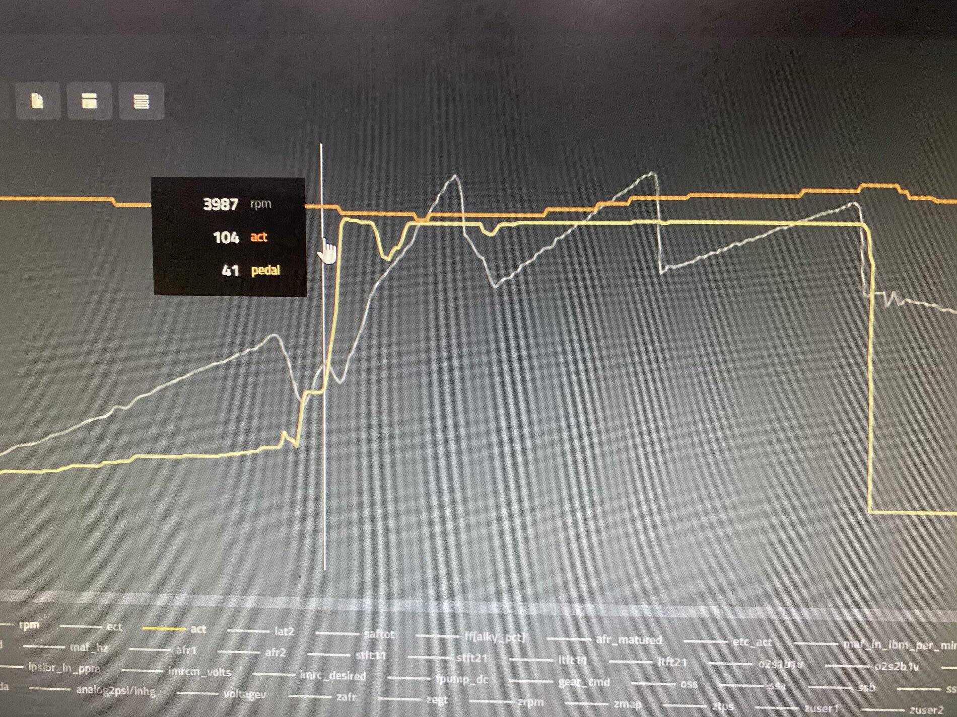

Good data but Im hoping a track guy posts some data from Florida. I also have logs on very hot days where Im cruising and hit in 2nd to about 140 and my charge temps rise 7-8 degrees.

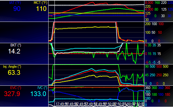

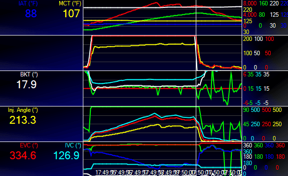

This was a warmer day with the Whipple; MCT dropped from 110 to 107 during the pull:
