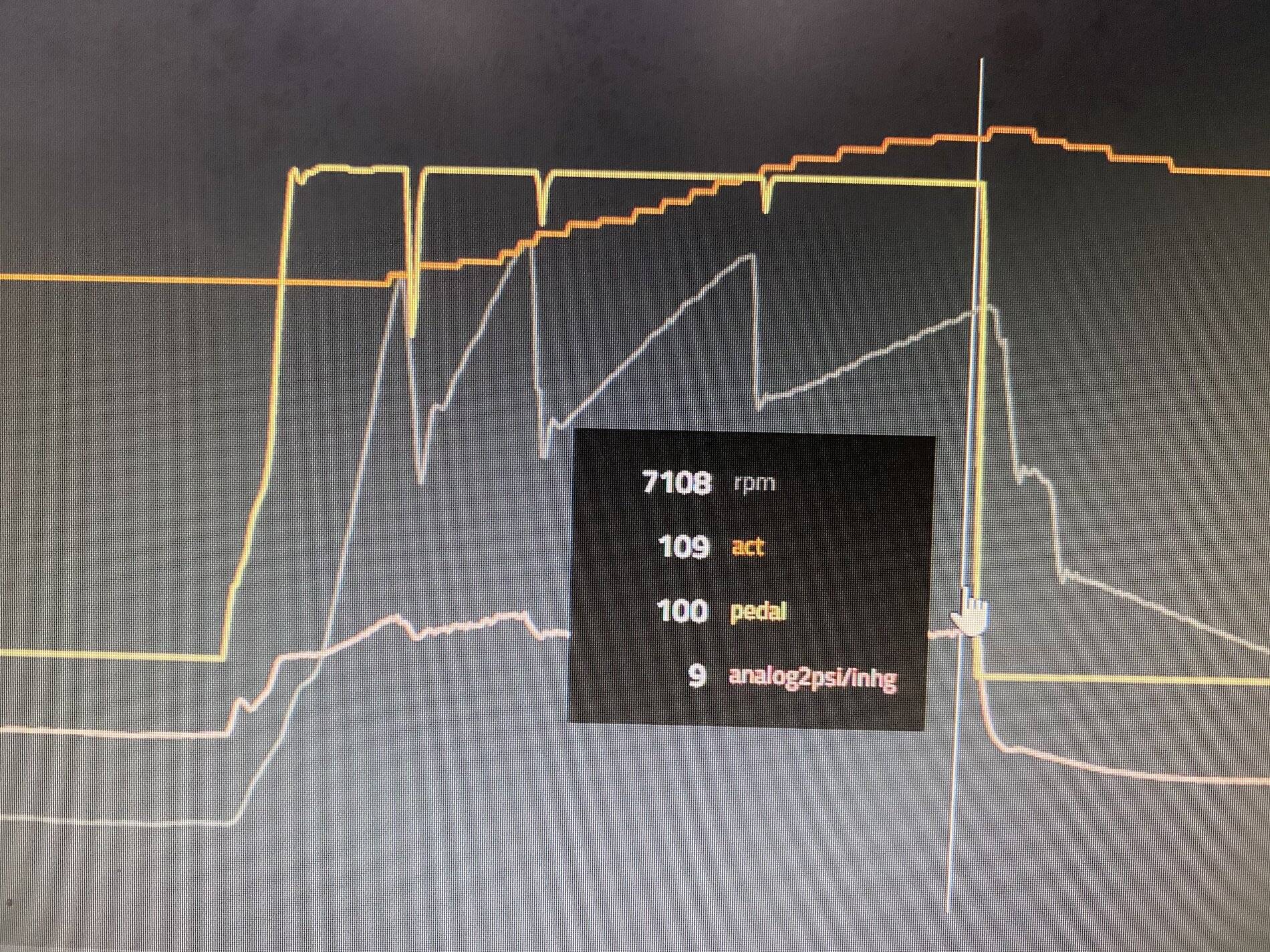

Methanol prevents heat soak regardless of the system. I’d like to know what iat2 is on a centrif/a-a Intercooled combo at typical 9-12 psi boost level.
SolarFlare
Aug 24, 2015
76
4,145
2,403
S. Fla
2015 CO GT
10.4psi was peak Boost here. 80* south Florida night night. IAT at the starting line 77*. End of the 1/4 109*.
