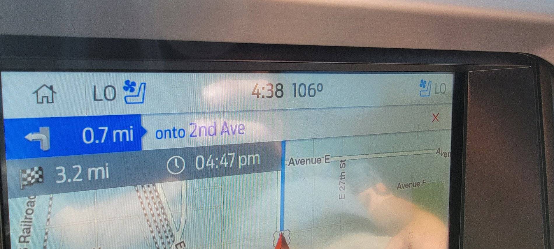

I do not have the data to back it as I haven't reviewed my logs yet, however, I just returned from Rocky Mountain Race Week, and we did 1 week of racing in 10k+ D/A (Bandimere), down to 3k ft D/A in Kansas. 109 Degrees ambient in Kearney NE at race time last week. Car didn't skip a beat, and power was the same pass after pass after pass.
The intercooler system on this Whipple kit seems pretty good. They said that was the most punishing week ever ran on Race Week to date temp wise, it killed a lot of cars. 10+hrs alone on Thursday's drive day at 105-109 ambient. Race days were sitting in line 20-40 mins minimum before you ran a pass.
I would think if the IAT/MCT was high, the power would suffer. Car ran it's usual E/T all week without a hiccup.
15k miles now on this Whipple kit, and it's been solid running the Whipple tune right out of the box.

Man that's an impressive week and sounds like a max punisher for the car engine. Great to se it held up great during the week of torture. Thanks for your info.

Anytime.
It was a hot one! 100+ at all tracks all week, with 2 days being drive and drag days.
