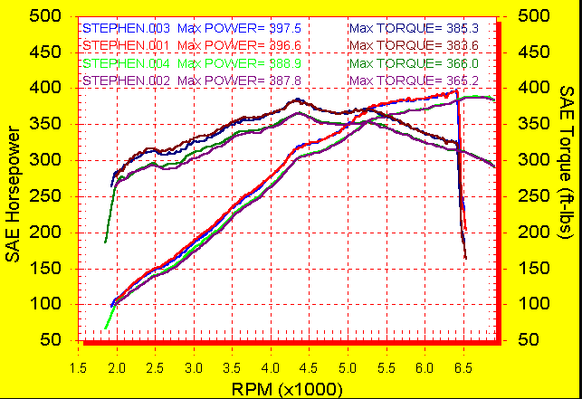

Here's one of dozens of examples of what I am referring to. This is a coyote dyno in 4th and 5th gear, of course with 5th making more. If we had this for gears 1-6 on the OP's car, then we wouldn't have to resort to the mass-equivalent math that SAE published. Alas, we don't, so we have to approximate if we want a more accurate answer. This is caused by the engine's mass-equivalent difference in 4th vs 5th gear and can be calculated using Gillespie's, Stephen Mason's, or my own methods.
Any mass attached to the engine after that, just increases what the total energy output gets distributed to.
Exactly! And if you were to calculate the power absorbed by accelerating an attached rotating mass, it would be dependent on acceleration rate, just like existing rotating mass in the engine. This is very easy to show and I did the math for you 2 days ago.

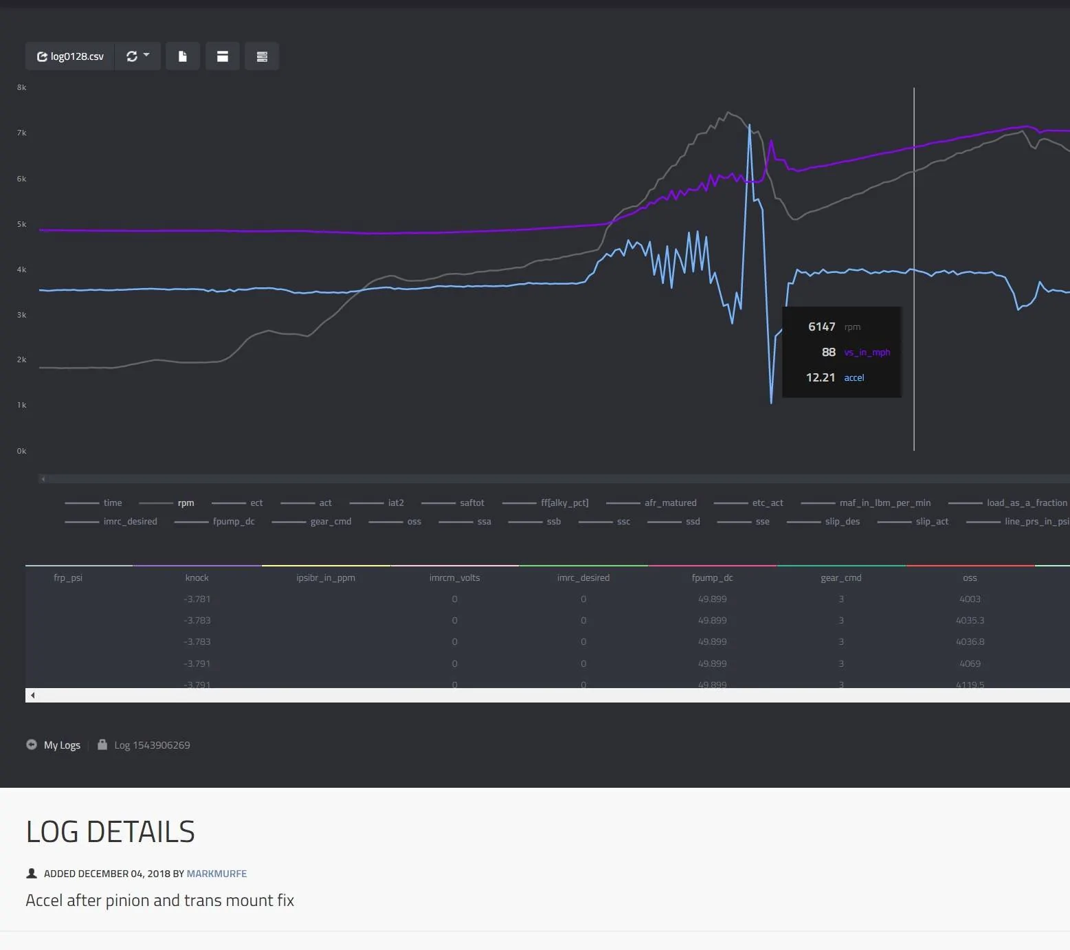

Here an example from trying to tune a 2-3 shift in 2018 where the car spun. I uploaded it to datazap then to show someone else. I have been doing this for shift points since 2006 in a manual Fbody. Automatics are definitely more precise. I learned it in algebra, but didn't understand it until calculus.
21.9 MPH/s is about 1g, so in the middle of third I was doing a near .56g. I'm telling you it looks just like your torque to MPH chart, I just added what the RPM looks like to that.
I know how to apply the theories and I know what is just text book nonsense.

This is wheel speed, same as oss with a little more math, if the tire has traction on the roads surface, it should be the speed the car is doing and the slope of acceleration, well as close as you can get to it over the time interval. Same thing a dyno sees if the tire sticks to the roller.
You tell if you shifted to early or too late by comparing acceleration before and after each gear. There's nothing compensating for mass, just looking right at the acceleration.
It will even tell you the changes you should make to your shift points between a hot summer day in Denver and a cold autumn day in the east coast area.
