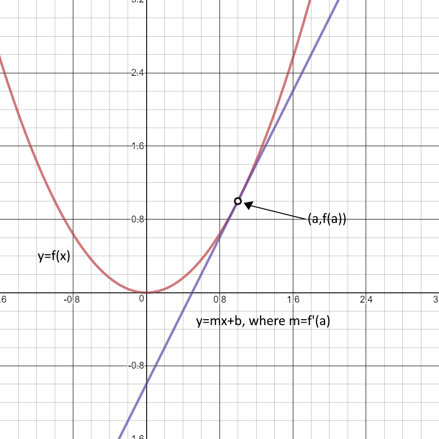

The slope of a point.
I never said there can't be a slope at a point. I just said it's not what your VCMScanner math is doing, or even what you thought it was doing. Yours is looking at average acceleration over the prior 1 second and timestamping it 1/2 second offset.
