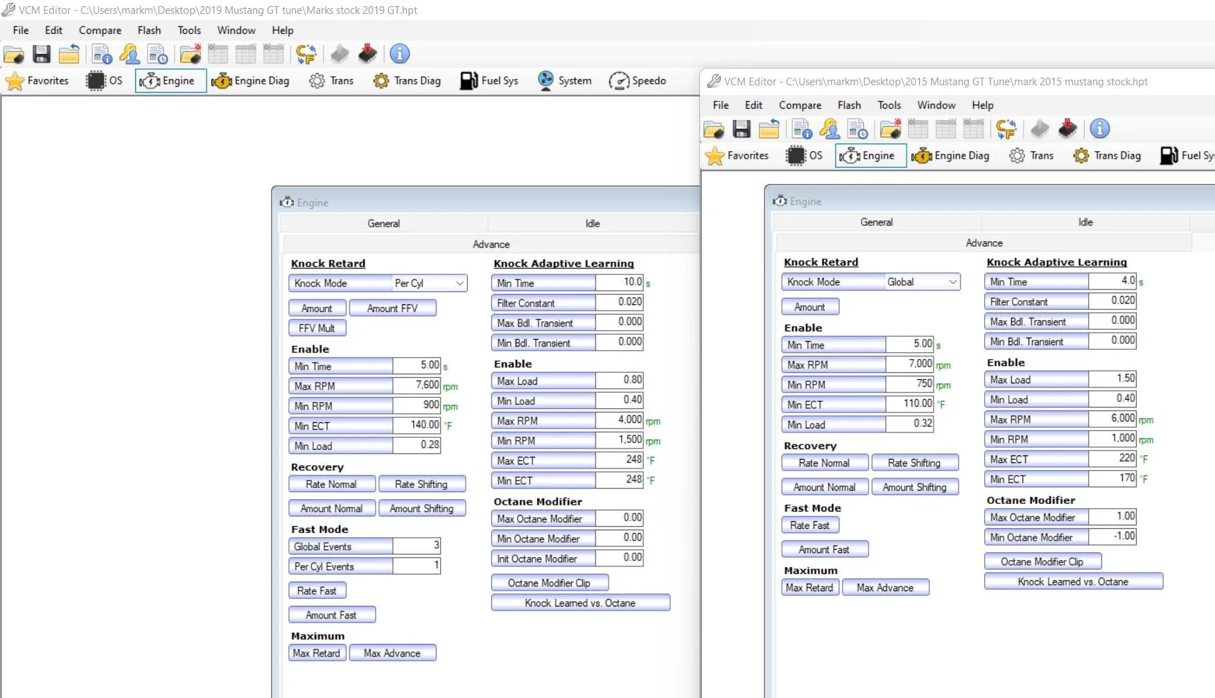

When running an aggressive tune, I always watch air load and knock, when testing a new tank of fuels knock resistance. I do this 10 miles after fill up, then again after the first 1/4 tank.
Part throttle holding around 2000 RPMs in 4th(6r80) or 7th(10R80). I only apply enough throttle to get airload to between .45-.65 and try to hold it steady. If the knock advance gets to 8-10* its good for WOT. If it only gets to 4 or less, I just drive easy until that tank clears out. Its really the only way to see if you really are getting that 91/93 as advertised.
Others tunes may vary with how much they can add at that RPM and load, but you can pretty quickly figure out what good gas does and what low octane will do. Its just safer to keep air load low, compared to checking it with max air load at WOT.
Or just have a soft tune and trust the sensors/ ECU will have your back. Which is what I do when not planning on racing/ having fun and just commuting.
Mark what mapped point or cam angle are you usually in?
On the roush tune that's 17 or 18. I need to check there is room between borderline and mbt. Normally I find 20 or 21 with more of a gap and KR adding. But load is also higher
Thats clever though. And a lot less stress on the engine
markmurfie
Jun 6, 2015
1,320
626
Hawaii
Mark
2015 Ford Mustang GT
I think what you should be asking is "what are my knock adative learning enable settings, or do I even use adaptive?"
It can open a can of worms tring to figuring out why your car is fast one week then slow the next.
Good concept for global supply of cars, not so much for making a car go fast consistently.
I just use the same parameters for my manual octane detection window. Sort of a blend of what I've seen comparing different calibrations of different cars.
