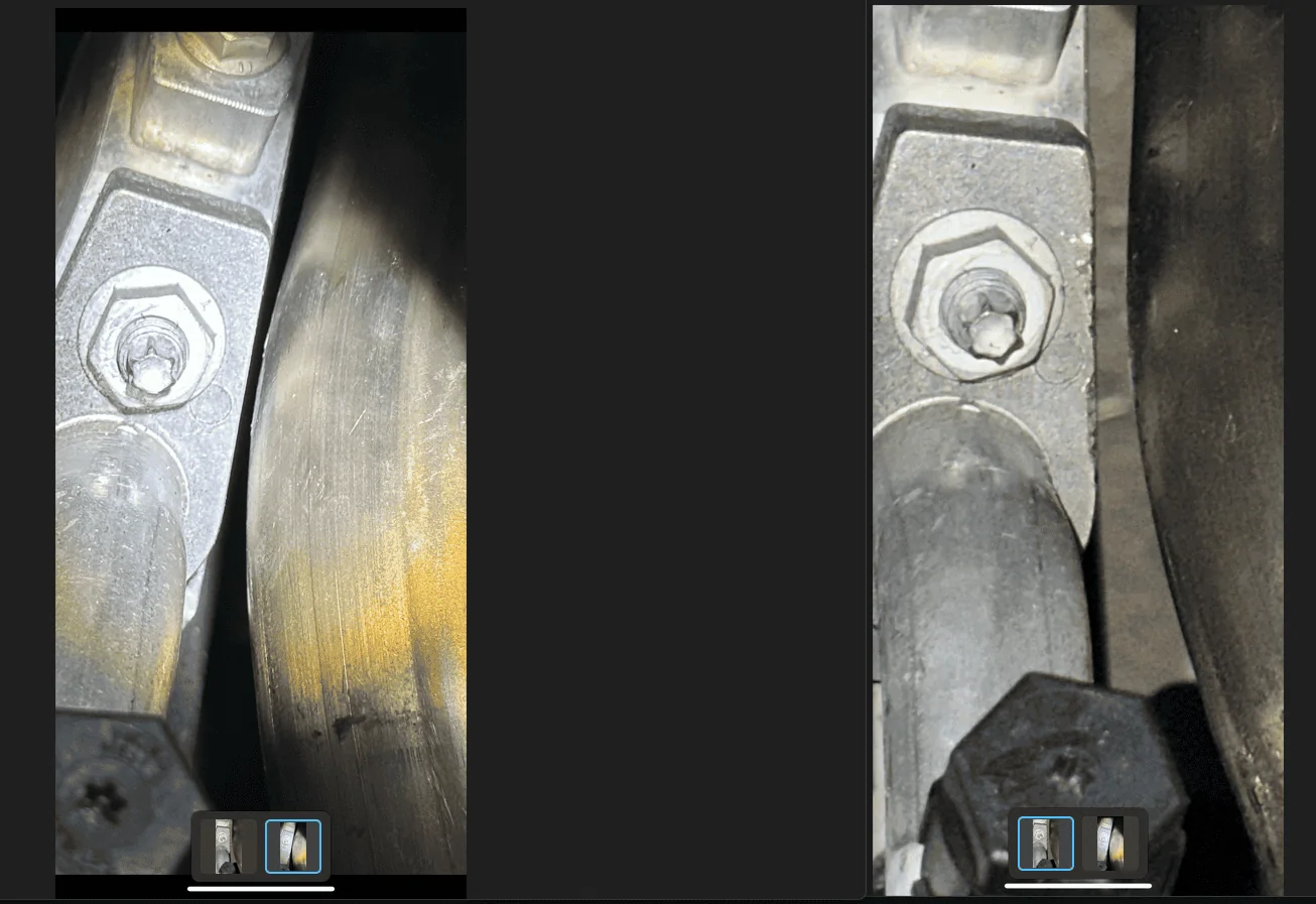

This was the source of my knock. Passenger side header touching the AC line. My shop was able to move the motor over a tad and get the clearance we needed. 22GT with TSP 1 7/8 catless headers.

Yeah mines cleared, its the actually header of mine that the tubes are so close they resonate and make a ting noise that causes it, i putted metal clamps on it and they broke off but it did eliminate the knock tho! But it also dented my headers since they got hot so I said fuck it ima need new headers :( I got American racing catless headers
