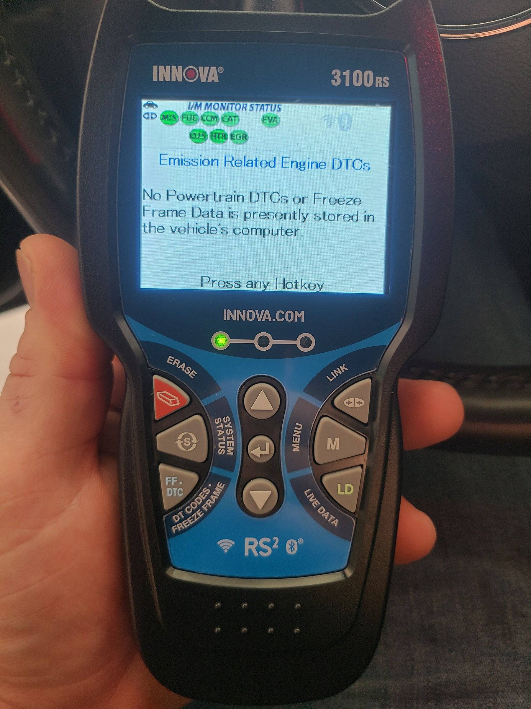

The EVAP has to be done with less than 3/4 of a tank of gas and more than a 1/4 and it just takes a couple of drive cycles with some idling.
Maybe but I drove at least a tank and half of gas over those few days and lots of open roads and lots of rush hour driving before it cleared for me. I'm just happy everything went green. I figured I'd have to mess with defoulers or what not to get everything right.
Most states require all but one monitor to be ready in order to pass unless it has previously failed for the one that is not ready. I assume the reason is because they acknowledge that EVAP can take days and sometimes weeks of driving to run.

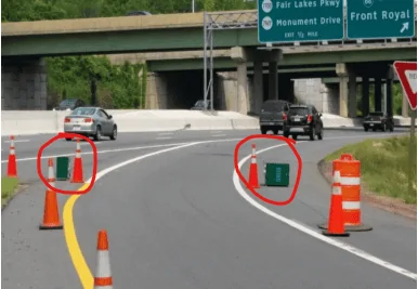

I live in NoVa also and the easiest way to pass the emissions test is to simply drive through one of the Rapid Pass emissions test zones that are on side of the road (usually near roundabouts of major highways in the area) around both Loudoun and Fairfax counties. You are eligible to do this months in advance of your registration renewal date and if the car passes, they just send you a letter in the mail or you can go to the following website to check your test status and submit the emissions payment after you pass.
If you are on E85, you should pass even without any cats.
www.rapidpassvirginia.com
As far as the safety inspection goes, a law was passed last year that the cops cannot pull you over minor infractions like tinted windows or expired safety inspection stickers, etc. However, they can still pull you over for a moving violation like speeding or running a light and then they can and will tack on any other minor infractions that are found on top of the moving violation.
That's pretty cool. I wish we had that in IL.
