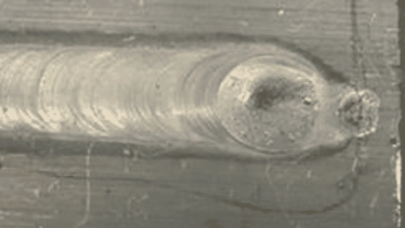

By chance is the leak located where the welding bead stops or possibly stops and restarts ?
We can't get close enough to take a picture to see the specifics of the weld. We can see where the tube meets the end cap but we can't see where specifically in the weld it is leaking. I will say this, it has to be tiny. It wouldn't surprise me if it is where the weld starts/stops since I could see the possibility of a very minute gap if you aren't careful with your bead.
When we remove it, I'll take pictures. This isn't going back in so a suitable replacement is necessary first before we rip this out.
Yes, Fliudyne states TIG welded construction.
Proper weld tie in, overlap and tail out are critical to avoid forming an inclusion.
Here’s an example of a weld bead that was stopped improperly. The pit in the center of the end puddle is the first place corrosion will begin.
You keep saying inclusion... Inclusions are usually from Slag. There is no slag in aluminum tig welding. The picture you posted is an end crater that needs to be filled up because of the micro crack due to improper termination.
Yes or Tungsten inclusions.
So Crater Cracking it is or in the Fitter world an (A-hole)….. The big issue with thin wall tube or thin gauge sheet stock material is the crater will penetrated to the back side of the weld.
We do agree it’s improper weld termination.
I’ve used the term Crater Inclusion but that could be incorrect and I do tend to generalize on the forum board.
