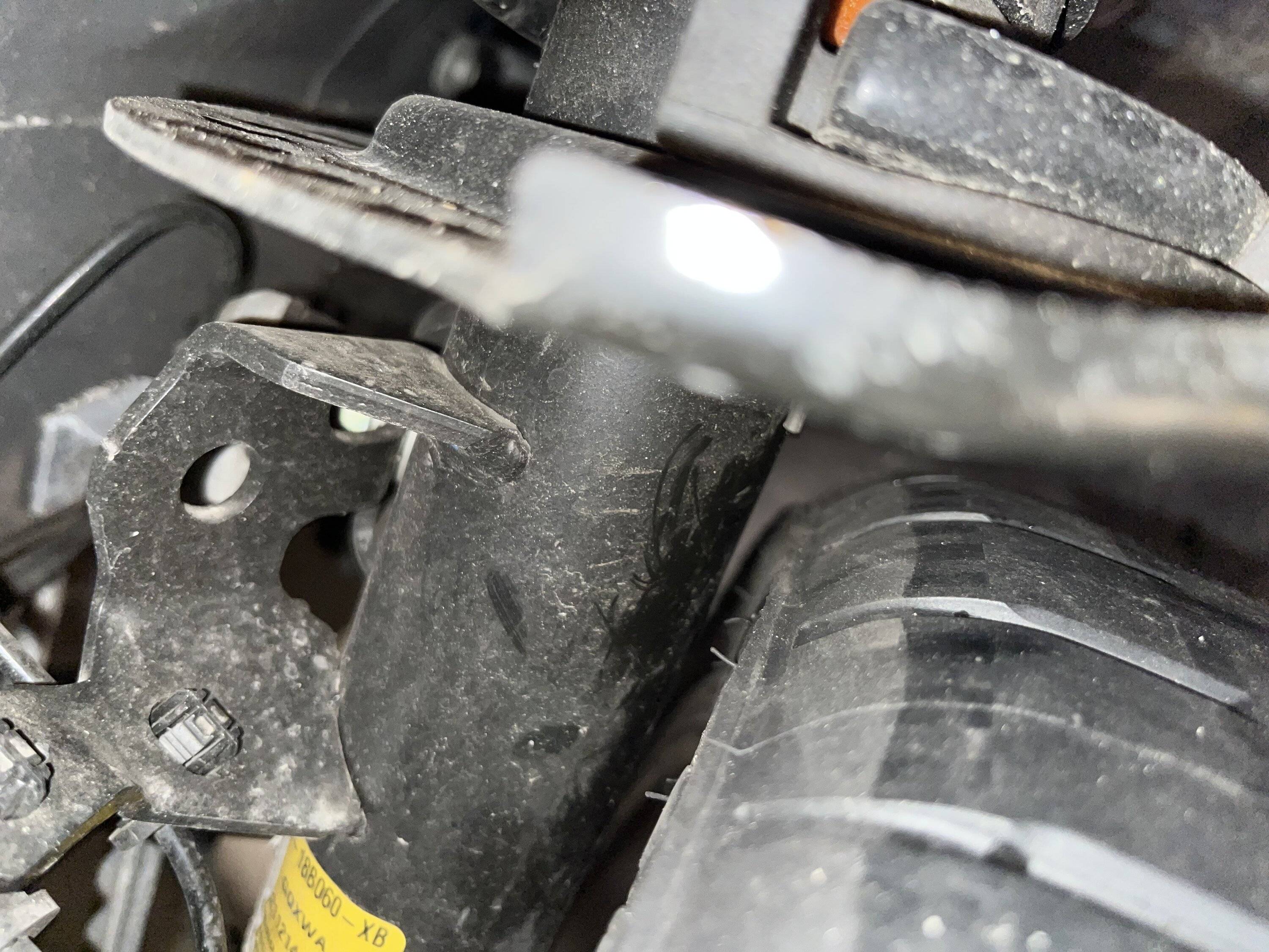

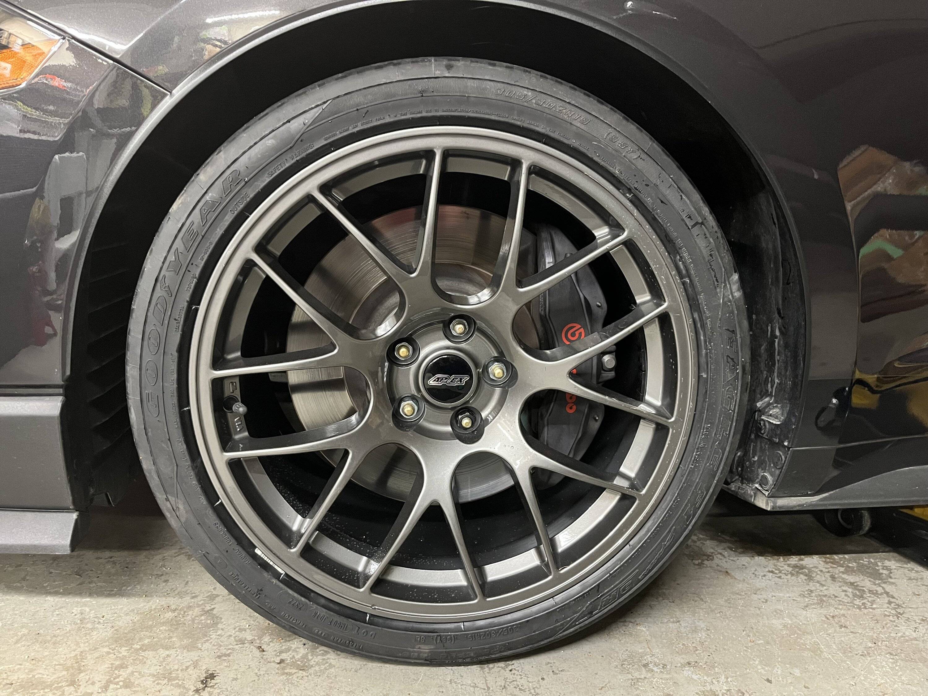

Hey Anthony- here's my take- I did exactly the same - I installed the Apex wheels offset 52 with same setup - 11" rims, 305 all round, with 25mm spacers up front and same ARP studs. Front pic attached. I kept my factory plates and got the wheel alignment place to do the camber at neg 2.55. I still can go a bit more with the factory setup and I might in the future. I was worried about the clearance from the shock because it was far less than the 10.5" wheels. I have been on the track that has tight corners and no issues with scraping. So all good and worked out great.
