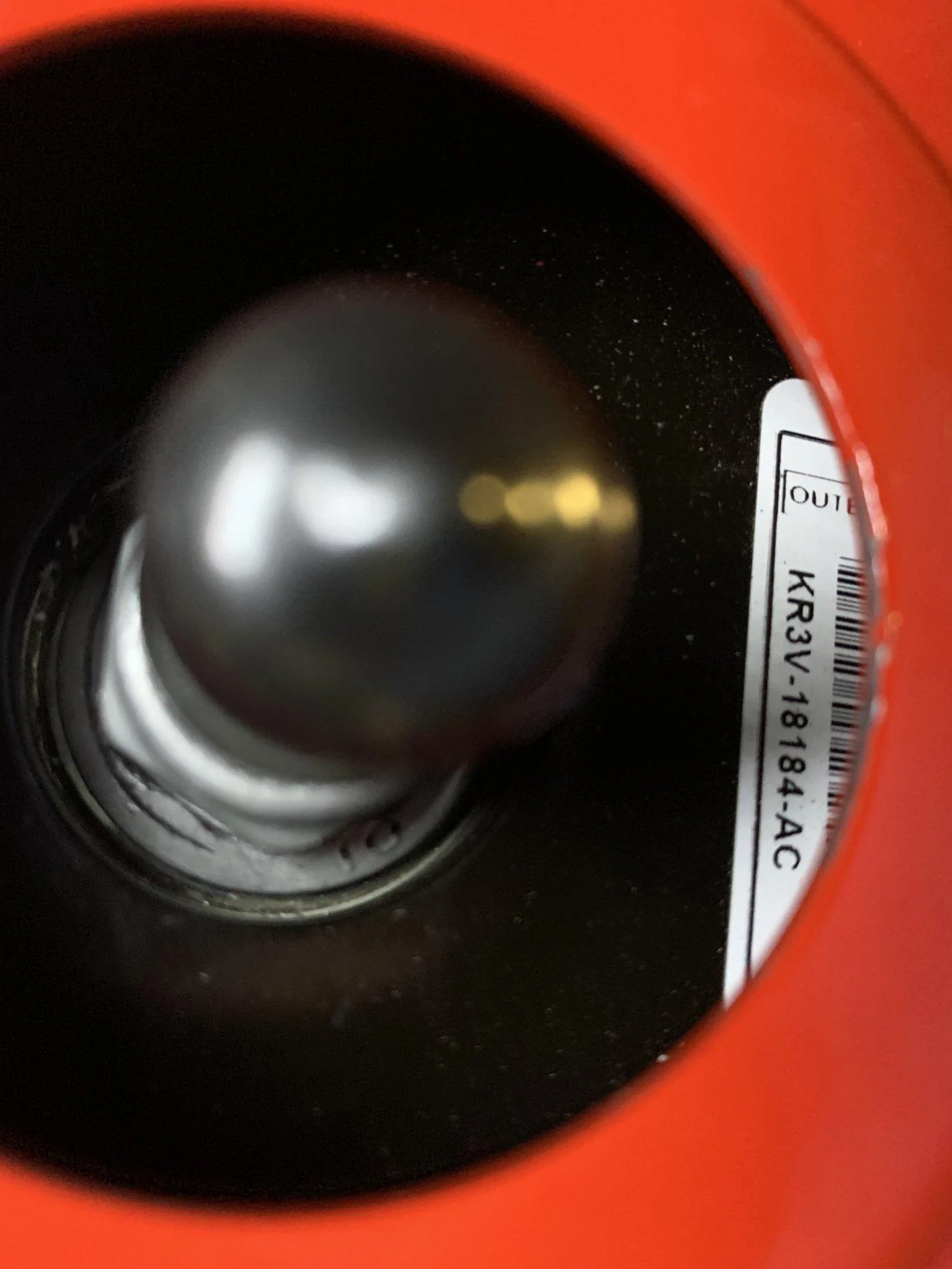

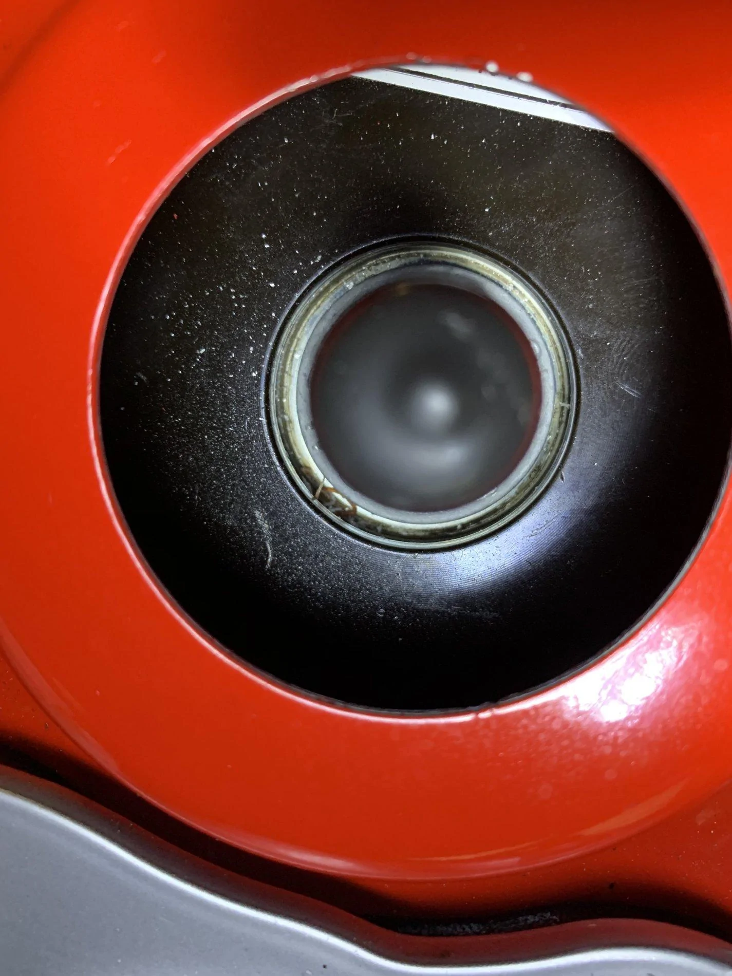

Anyone know what the mounts look like installed? My 2019 came with the option the dealer stated they are installed but I don’t see anything different. On my race cars ( Datsuns) they are visible. Anyone have pics?

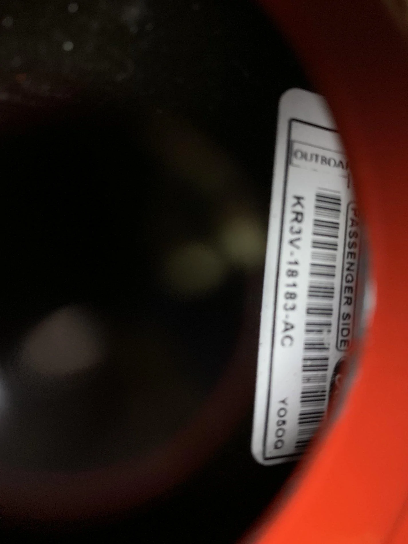

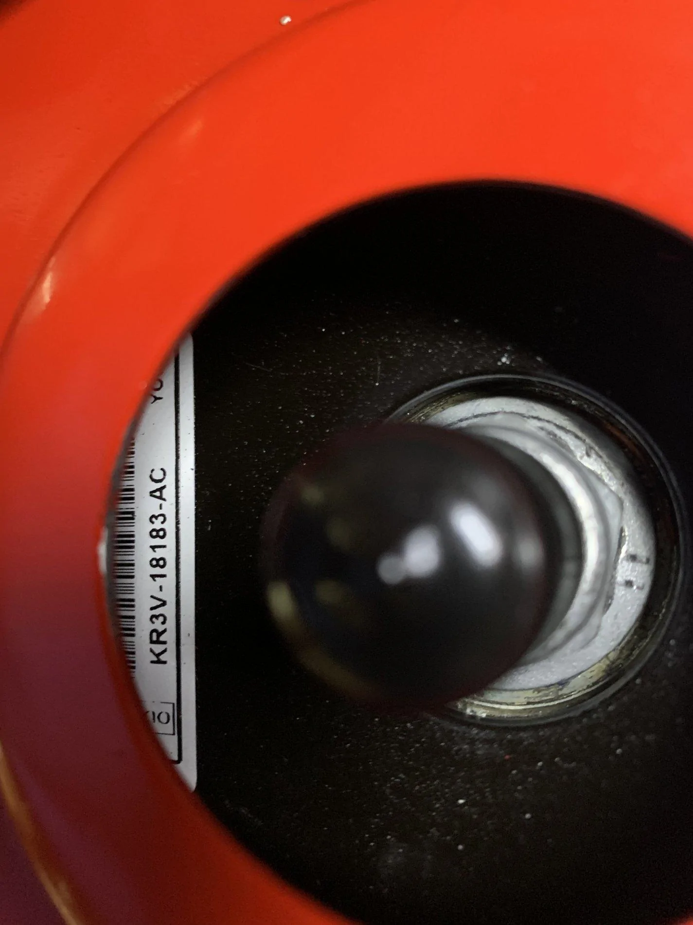

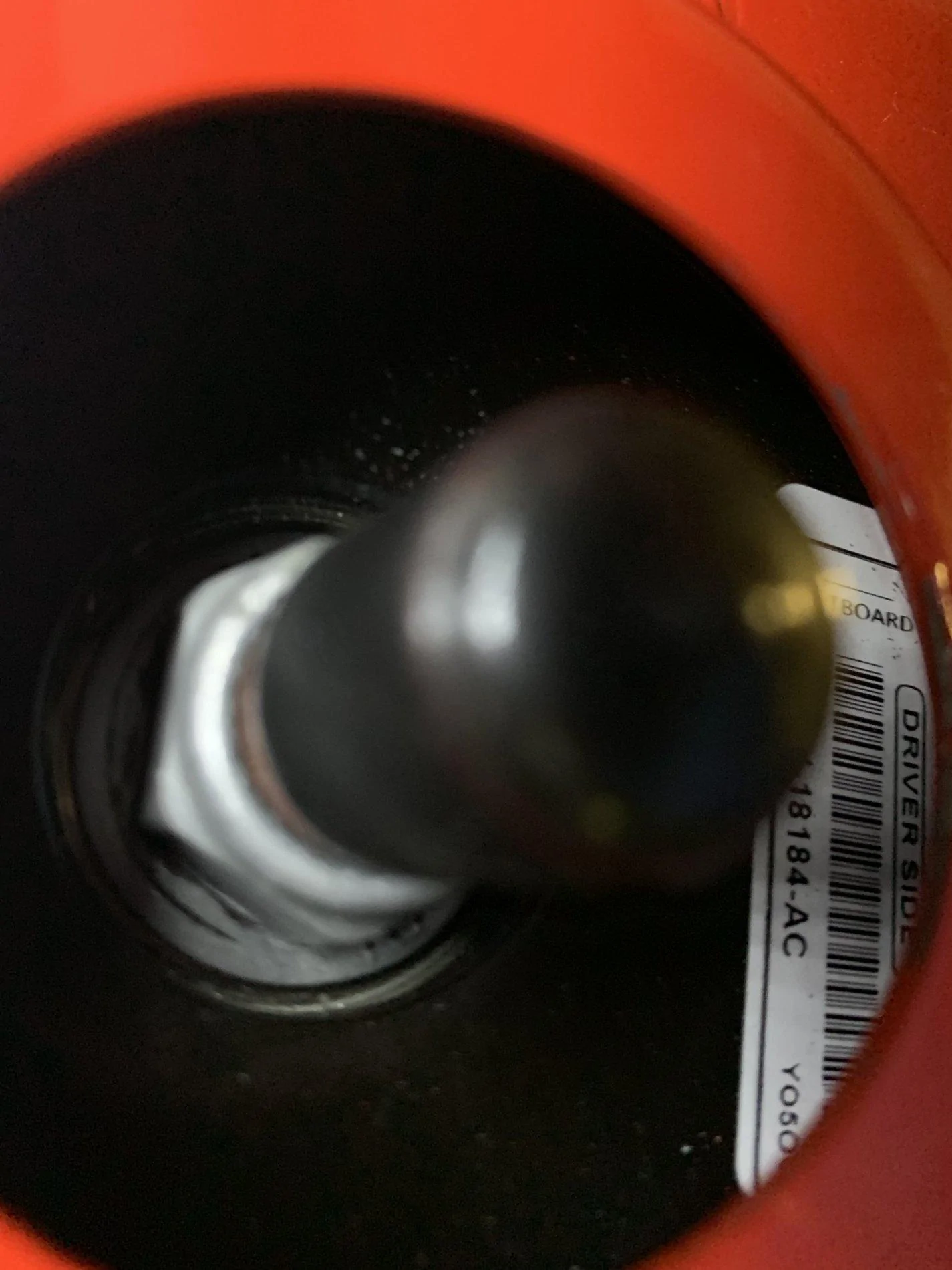

Here they are; you should be able to see the part numbers if you look at the right angle:

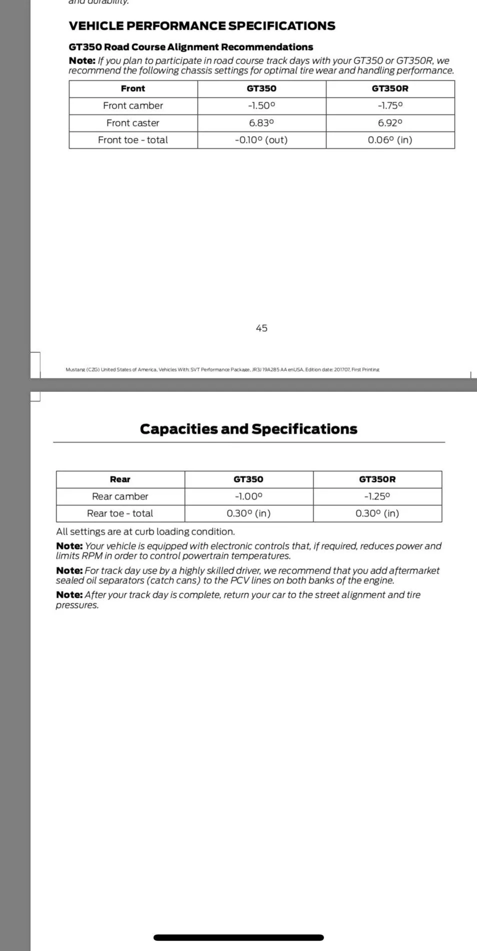

Something must be up, I think the recommended track setting in the owner’s supplement is -2 or -2.2 in the GT350 so you should be able to get at least that on both sides. I haven’t tried to adjust mine yet
They changed the recommended track settings to -2.2 deg neg camber up front in the 2019 manual. I'm confused to why the left and right maxed out differently. FYI the caster changed with the plates installed and is uneven side to side as well.
The alignment shop is a muscle car specific shop, they seem to know what they're doing. But I'd like to see what others are getting b/c this is so odd.

So it seems like mine are attached but the driver’s side is labeled passenger side and passenger side one says drivers side. Still waiting until the recommended 1000 miles before possibly tracking the car, but seems to go down the road straight. I am certain Ford labels them driver and passenger for a reason.

Thank you for pointing me to that thread. I spoke with Ford Performance but the person who was knowledgeable in that area was unavailable so they recommended I email them. I will share their response when I receive it. I also recommend all owners with the Handling Package check to confirm the strut mounts are installed correctly.
