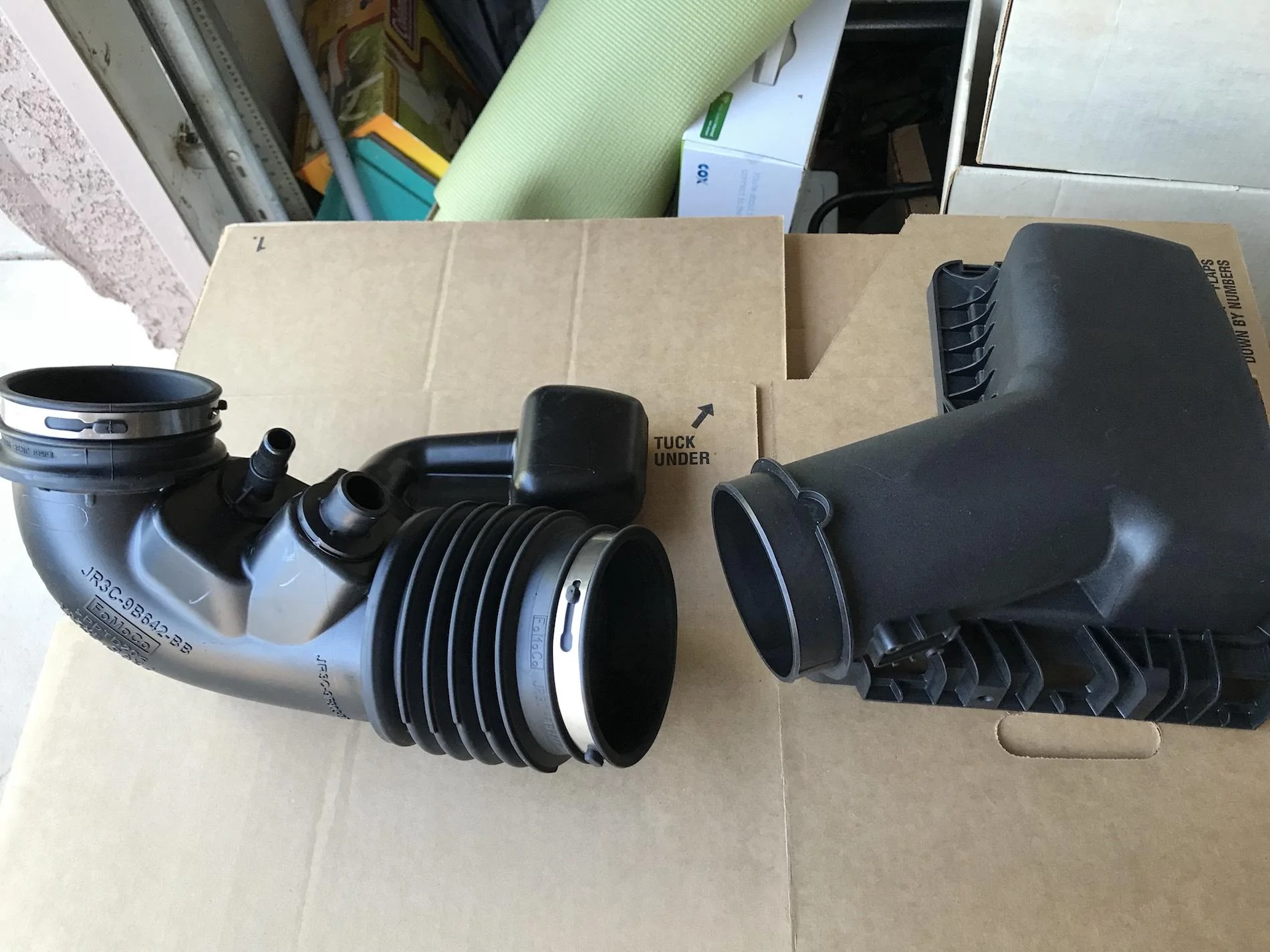

I finally was able to get a 2018+ intake!!! It may take some time for the prices to come down and get closer to what a used one sells for on ebay for a 2015-2017.
but so far things look promising. I plan to do a dyno comparison (@ some point) to see if there are any real gains, but i like the idea so far! This could be the hidden "cheaper" alternative to the Ford PP2 kits?!

How is that an improvement from the 2017?
People have been swapping intake manifolds, not intakes. I have a basically brand new 2018 intake if someone wants to buy it for cheap. :D

F150 '18 intake? :shrug:
Cause this thread is about the F150 intake Manifold.
No a 2018 GT intake, and yes I’m aware it’s my thread :)
Just sharing next steps and possible improvments to the F150 mani.
If you have a 2018 GT intake I’ll buy it!!!

Guys it's the intake he is talking about, NOT the intake manifold....look at the pics he upped...
I tried asking others but could never get an answer. Is there anything different on that one in terms of size?
